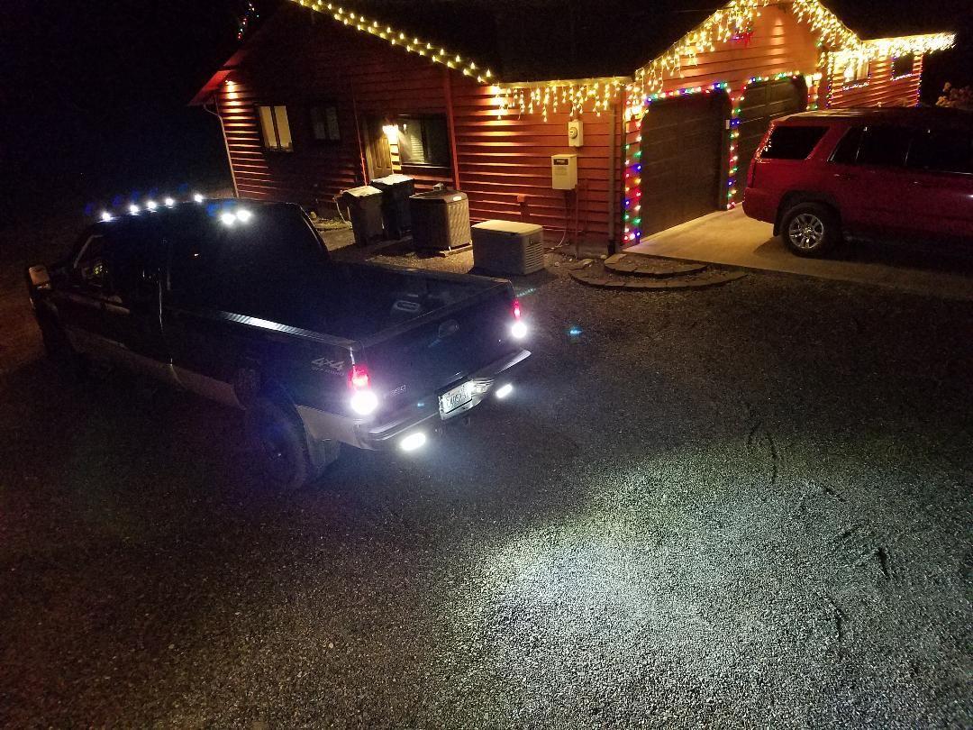

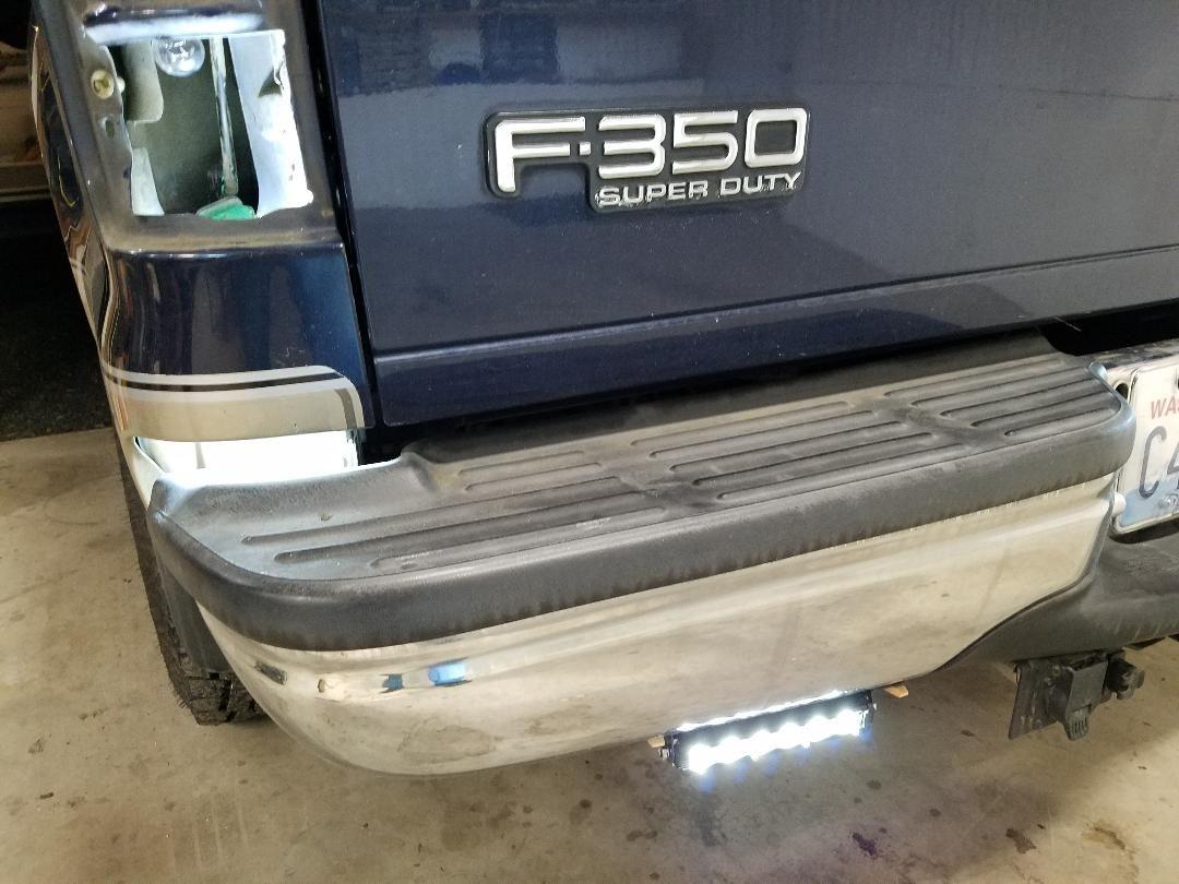

These reverse lights under the bumper have been very useful up here in the wet northwest. While LED reverse bulbs in the OEM locations helped some, these were a significant improvement, and only $20.
https://www.ford-trucks.com/forums/1...l#post19647682

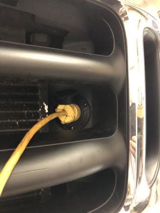

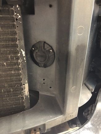

I mounted my plug behind the grill on the drivers side to keep a clean stock look, but still easily accessible.
Mine however is a Noco for a battery maintainer.

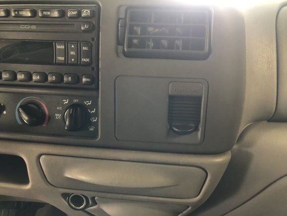

As for the voltage monitoring I went with an integrated dual USB and voltage gauge with an on/off switch. Recommend by @Sous
https://smile.amazon.com/gp/product/...?ie=UTF8&psc=1
Here is where I mounted it.

This is one of the mods I want to do as it is difficult to see when backing at night. I already have LED backup bulbs to replace the stock bulbs and it has helped but not to the extent I was hoping it would. I want to add the below bumper lights as well, but want them to be low profile like yours. Details would be appreciated for installation ideas on my truck sir!

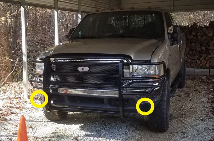

As for bumper plug in ports, these things are great! I have two on either side of the bumper in a similar spot as Tomkat07 originally posted. The driver side is for the block heater and the passenger side is for the NOCO battery tender.
I LOVE this idea! I’ve always had a hard time thinking of drilling out my stock bumper. This is a nice hidden way to add the mod. Thing is I rarely use the block heater so I’ll just keep this in mind.
I do not have an on board charger but recently purchased the small NOCO Genius1 which I rotate between stored items in the winter. I really like the charger and will share the link below. Now I’m wondering if I could do a similar mount behind the grill for the small 2 prong 12v adapter from the charger. Then no need to pop the hood and use the clamps. Most of the other things I charge already have the 12v quick connect but I’ve never added one to the truck yet. Hmmmm.

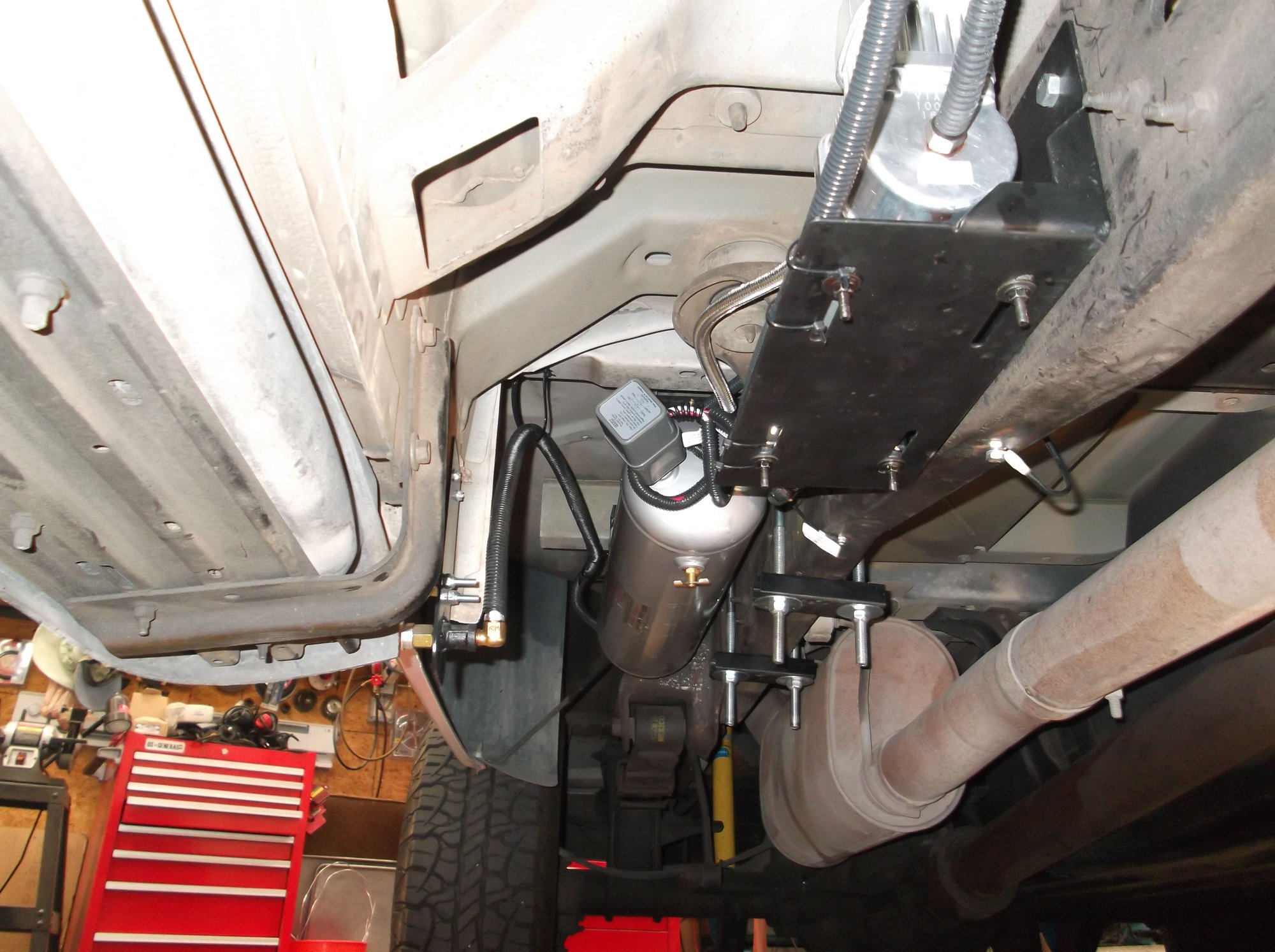

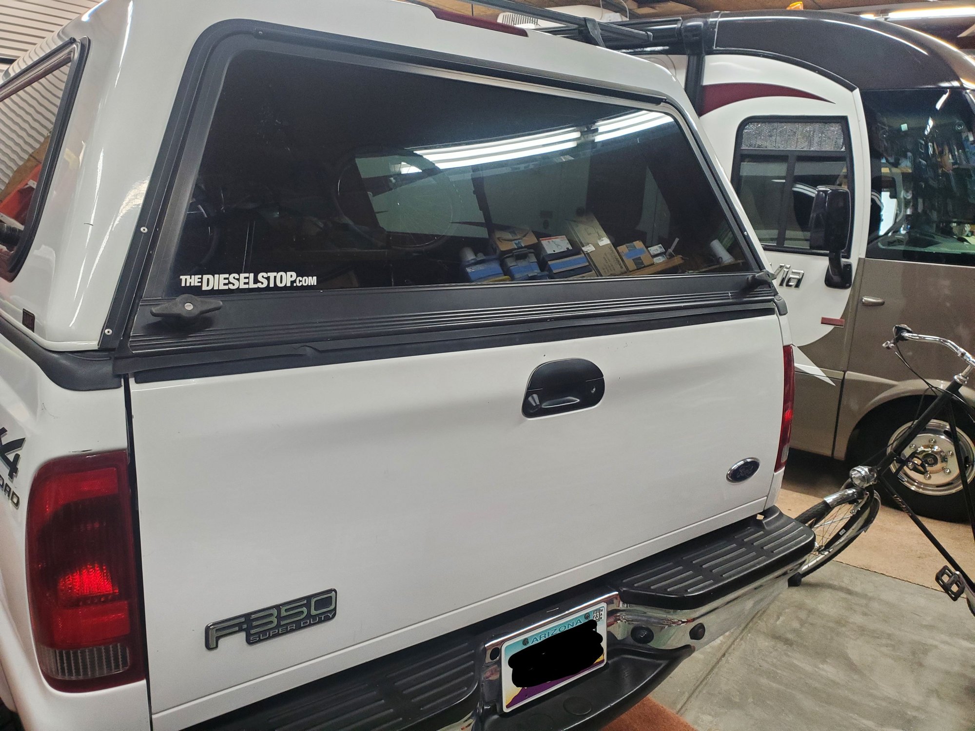

I know you said affordable and my tailgate camera was very affordable however it requires that you have a head unit with display. Also one of my best mods is my on board air, however this is not real affordable for many being around $450-$500 by the time it's complete but is has really paid off for me. It is possible to do it cheaper by going without a tank and maybe a cheaper compressor than Viair, or mounting it under the hood to save on heavy wire.

Originally Posted by Scott Vincent
looks familiar for some reason
I've got my install thread on them somewhere, let me dig...
Found em
Link

I’ve also been considering the phone charge port with battery display.
How do you fellas remember to turn yours off?
Like you, I’m the same on the instrument lights LED bulbs. I don’t want something bright and shining in my face.
The charge port voltage meter is not offensive at night where I have it mounted but bright enough in the day to know you have left it on.
If your O.C.D. it will never get left on. If your A.D.D. it’s likely that something shiny to your left has caught your attention and it might get left on.
I measured draw over a week with nothing plugged into it. .09 volt, so I wouldn’t be too worried about it killing batteries in short order.
That was on a single 11 year old RV coach battery so I’m sure that healthy dual battery system would perform even better to the draw.

Nice post sir! I would like to know the details on the, I assume, engine heater plug for the front bumper. I hate the stock configuration and it is painful when cold outside.
I like the battery disconnects, and the bolt issue vs rivets is a valid point, I will research this for my own use as I have been looking (not yet researched) for this as part of modernizing some of my in-cab electrical system options. Thanks!
The heater hose mod is not a valid option for me as I want heat year round, and I am going to do the heater hose mod with the Ford double hose valve to completely shut-off the flow during max AC, etc. I have to dig up the mod if anyone wants it, but I have it in my pile somewhere.
Amazon Amazon
Requires a 1 7/8" hole saw to cut the hole in the bumper, but I used a 2", as that's what was available. It's a bit counterintuitive to gnaw a hole in a perfectly good bumper...
If you're going to be doing electrical work that require any significant amounts of disconnecting <--> reconnecting your negative battery terminals, I recommend quick disconnects.
