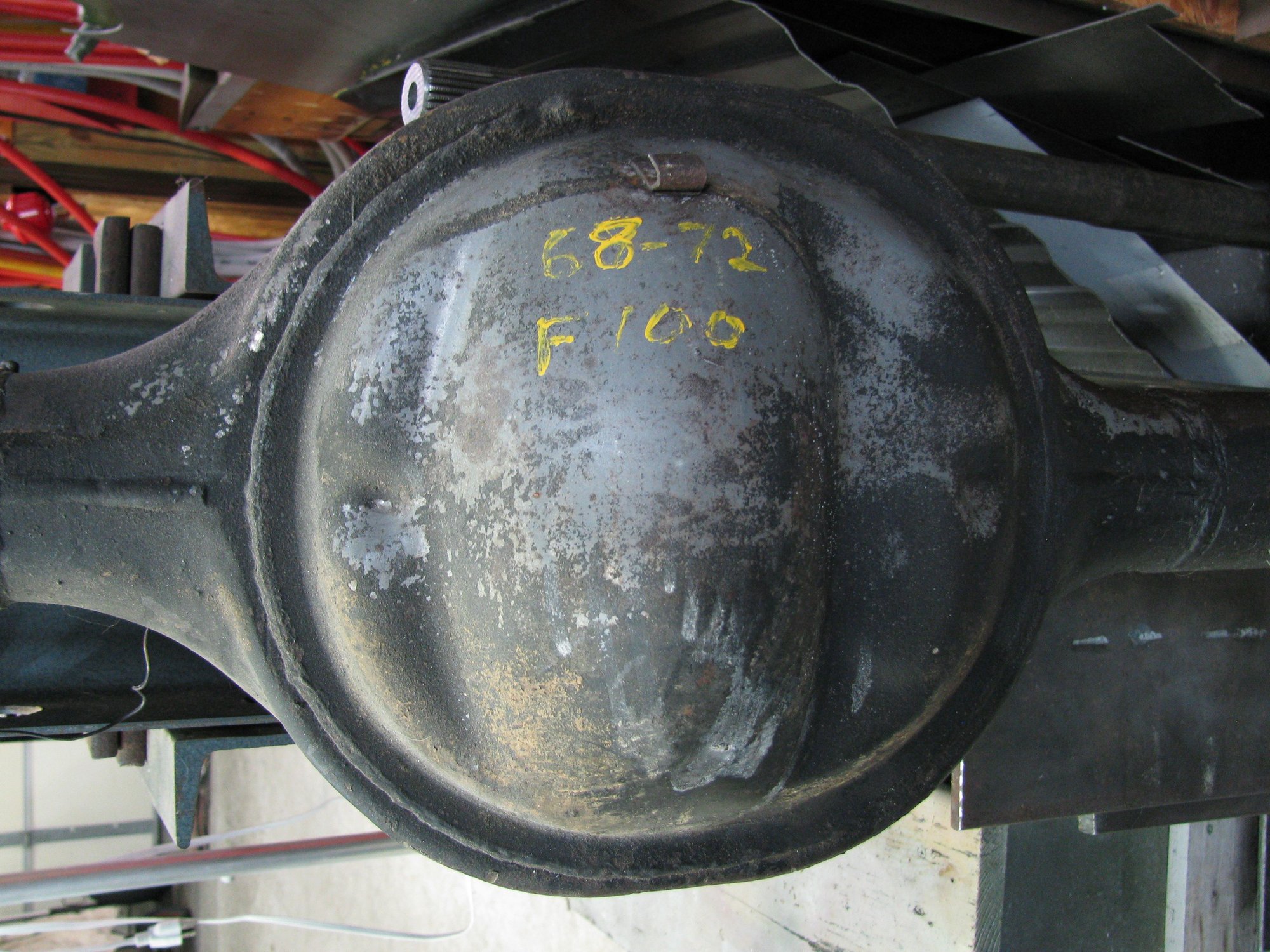

The easiest way to tell the difference between the 61-67 housings and the 68-72 housings is to compare the pumpkins. The 61-67's have a fill plug in the back of the housing and no plug in the center section. There was a transition period between 66-67 where there could be fill plugs in both housing and center. The 68-72's have a fill plug in the center section and no plug in the pumpkin plus they look different.
Also, the 68-72 housings and axles are not the same dimensions as the earlier ones. Ford narrowed the housing and moved the bearing seat on the 68-72 axles to make room for wider brakes and keep the shoes centered in the drum. First picture is a 65.
