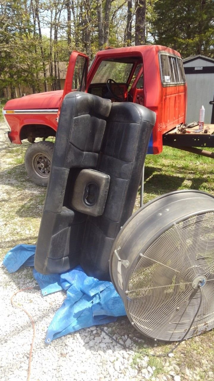

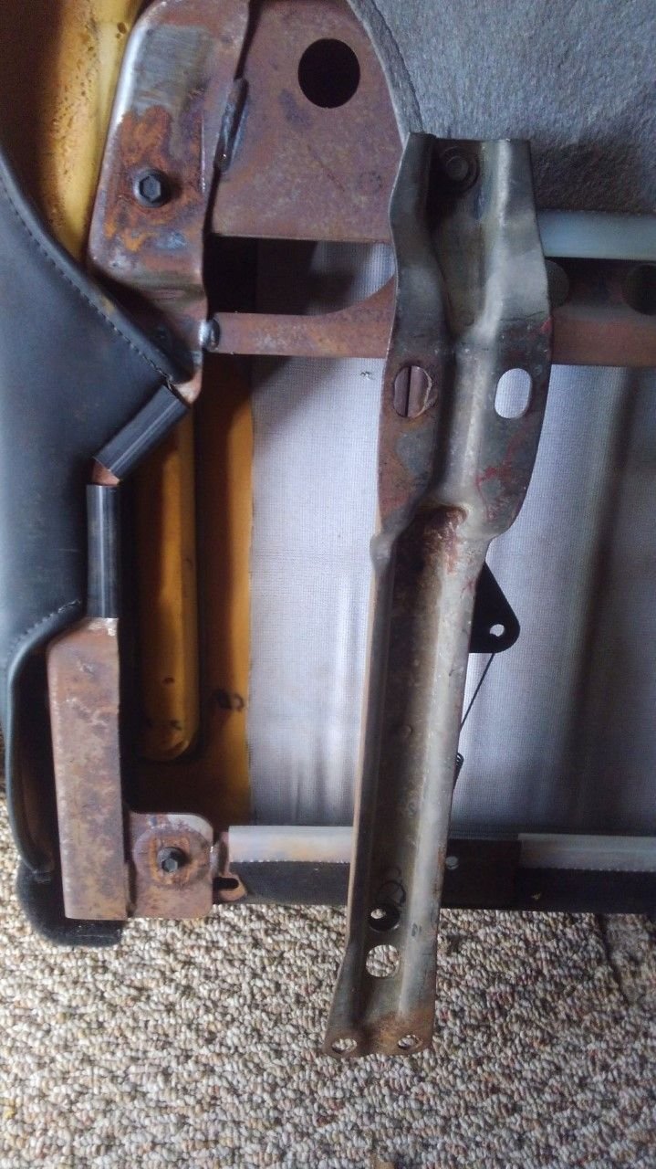

A 2000 ish SD CC rear bench can be found cheap enough. Craigslist, FB Market place, pick and pull. Car-parts ect...Take OEM riser mount brackets off. Measure up and drill and mount the 79 OEM sliders and mount it. If it is to low add some square tubing for a riser and go again. Easy peasy.
$40 bucks Craigslist
My 79 OEM sliders
It was to low, so I added some square tubing for a riser. Using OEM bolt holes and longer hdwr.

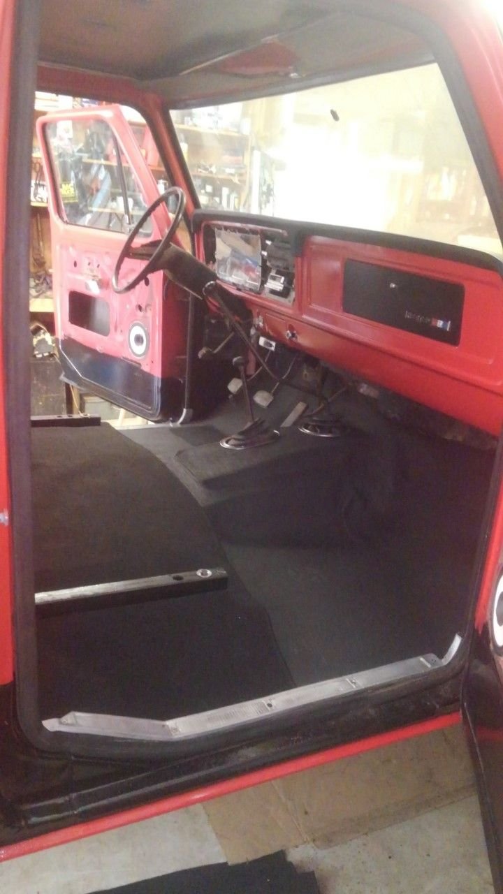

I used chrome tag lights on both ends of the lower dash for courtesy lighting. I have a gun rack but It got used for a level and/or hat mostly, 1986 Mercury bucket seats, some center storage with 2 drink holders, floor hump platform, behind seat storage box that is lockable 3 times, and I added the AC long ago too.
My red plastic door panels were OK, but they are a PITA to remove ... and I wanted unique and easier access to the door interiors, so I made 3 piece inner door panels and cured speaker vibration noises. The lowest third of the panel is intended to stay put and also has map and drink pockets. The top third is intended to be left in place but is removable and houses window winders, grab handles to pull shut, and arm rests. The middle third is easily removed with a 5/32 Allen wrench on socket head screws with a driver, etc, I can access the whole big access hole and every door part except window winder three bolts from behind this panel section, in just a few minutes time. Speaker grates also are included in this section. I can change out a glass though ... if ever needed ... as the center third also covers the lowest bolt of the vent wing partition.
A period correct OEM radio is gonna likely not work and if it does, is gonna not be pleasant. Speakers and inner electrics use papers and plastics and glues and other materials that dry up and change properties (ie: degrade) ... after 40-50 years in the hot sun or cold frozen nights sitting unused. I have two on shelf in the basement, both work, so they'll stay there. I have a '70s era Pioneer in the truck, and a working spare. They do well with my SkyFi docking station and wired modulator feeding the antenna, Willie's Roadhouse or Fox or '40s on 4 mostly ... via my life subbed SkyFi . Antenna is in ca ... either on dash or stuck to the gun rack via magnet depending on pickup of sat signal.
My flooring is devoid of factory padding and carpet. It got some cleaning, over plating, and topped with an industrial rubber flooring that has a weather proof carpet molded into the rubber locally at Georgia Bboded Fibers.
I also at some point ... redid the mirror after it fell off the windshield. I cleaned the glue off the glass, then made a bracket that attaches to the metal above the glass and mounted the mirror "button" to it with a screw and JB Weld, it raised the mirror where I can see still over the tailgate, or adjust to see somewhat better down into the bed.

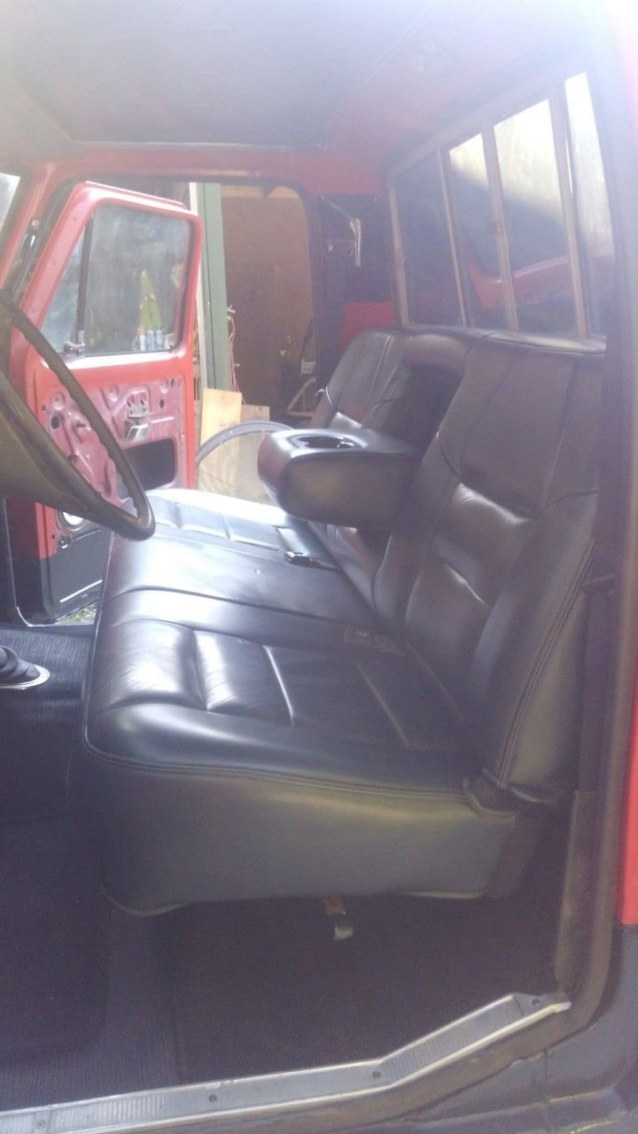

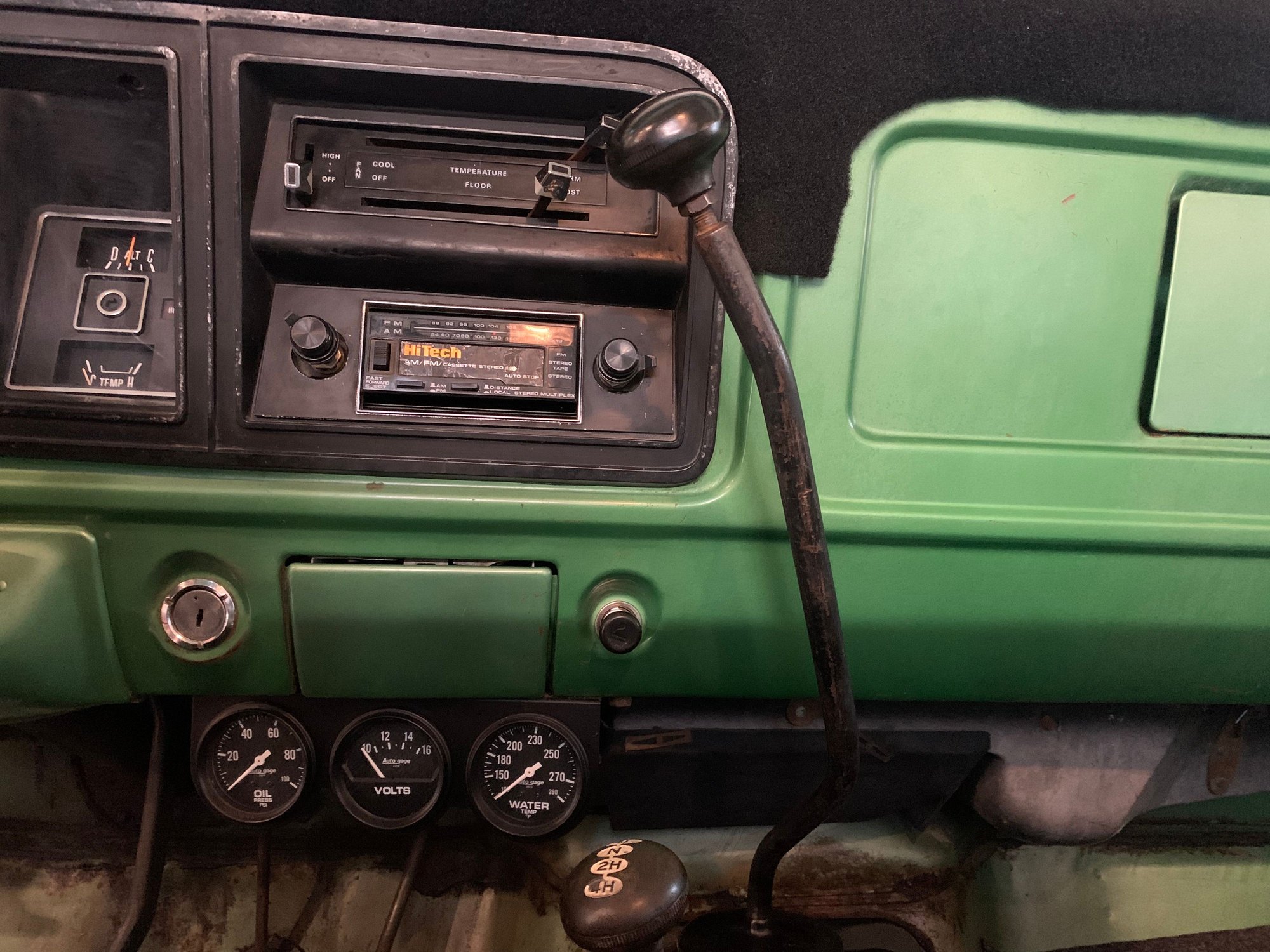

Old Jan 7, 2023 | 01:46 PM
Sandbox13's Avatar
Sandbox13
Trailering
Joined: Jan 2023
Posts: 22

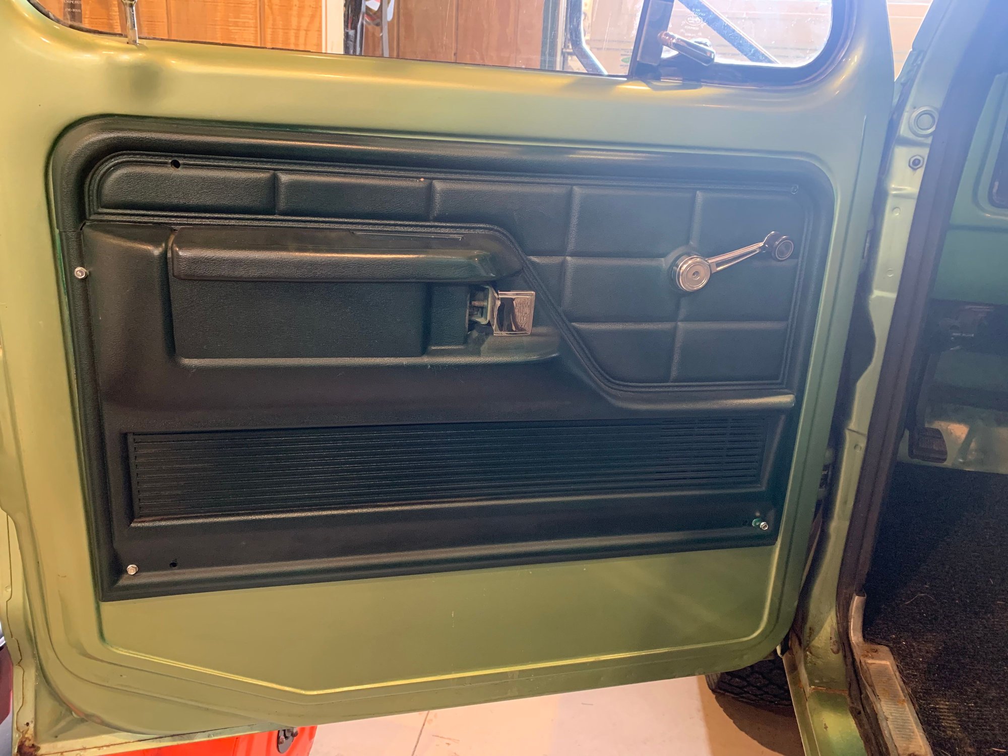

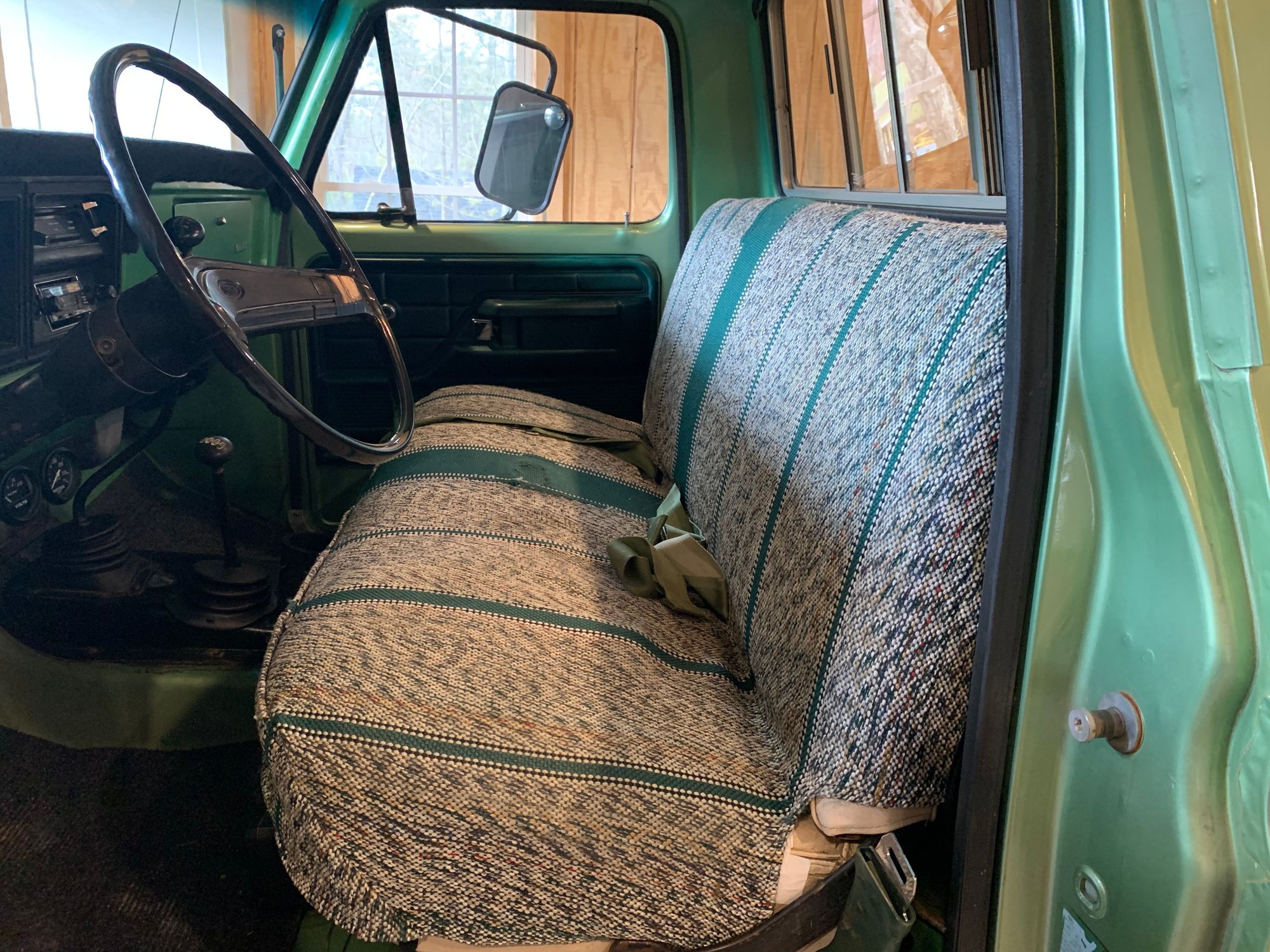

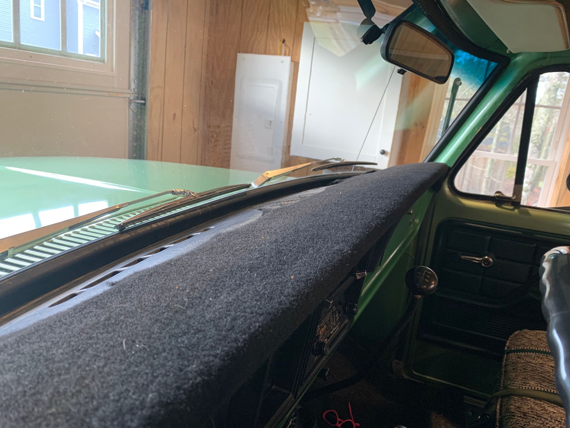

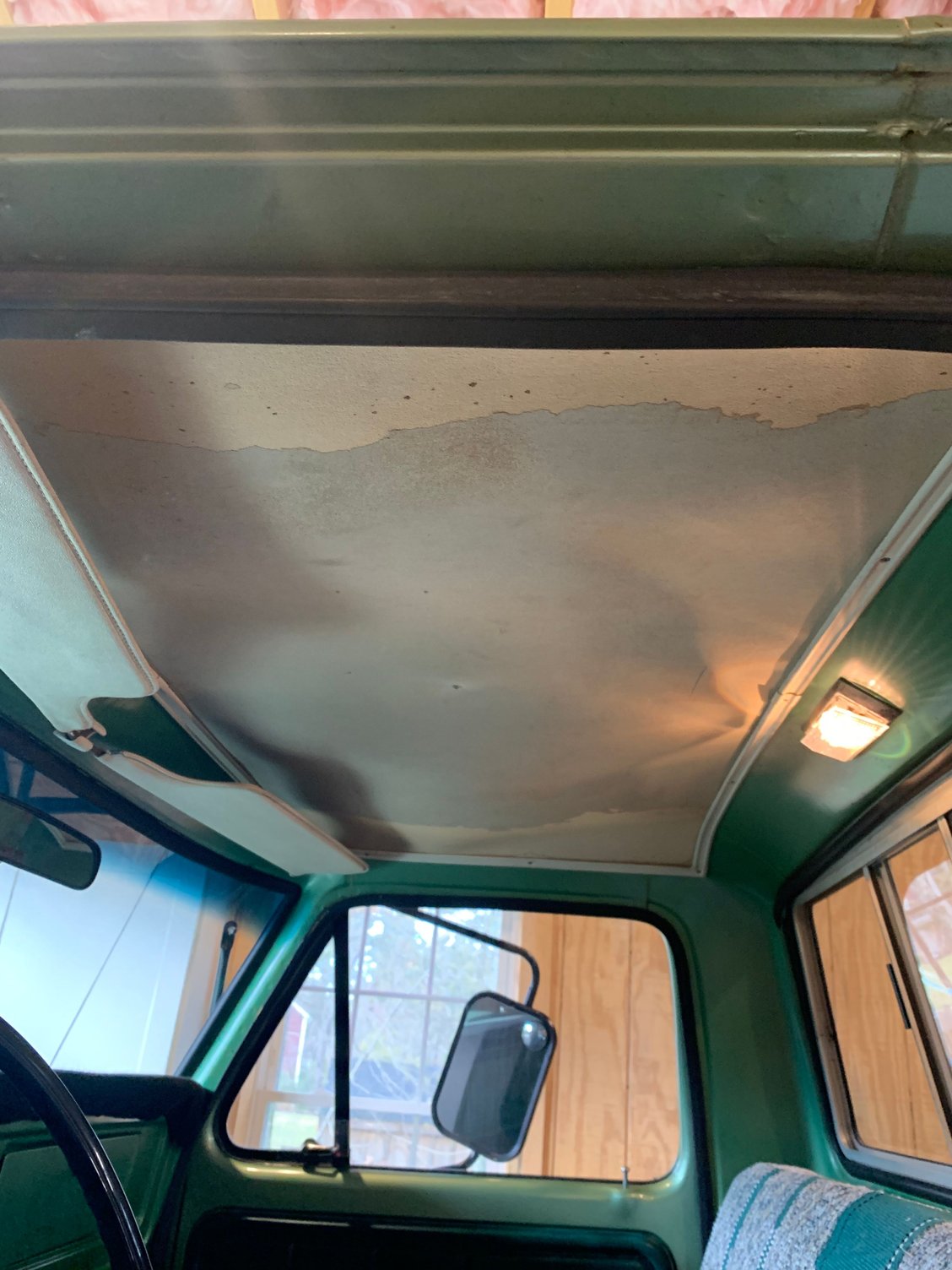

Thanks for the input. Here’s a few photos showing what I’m working with
