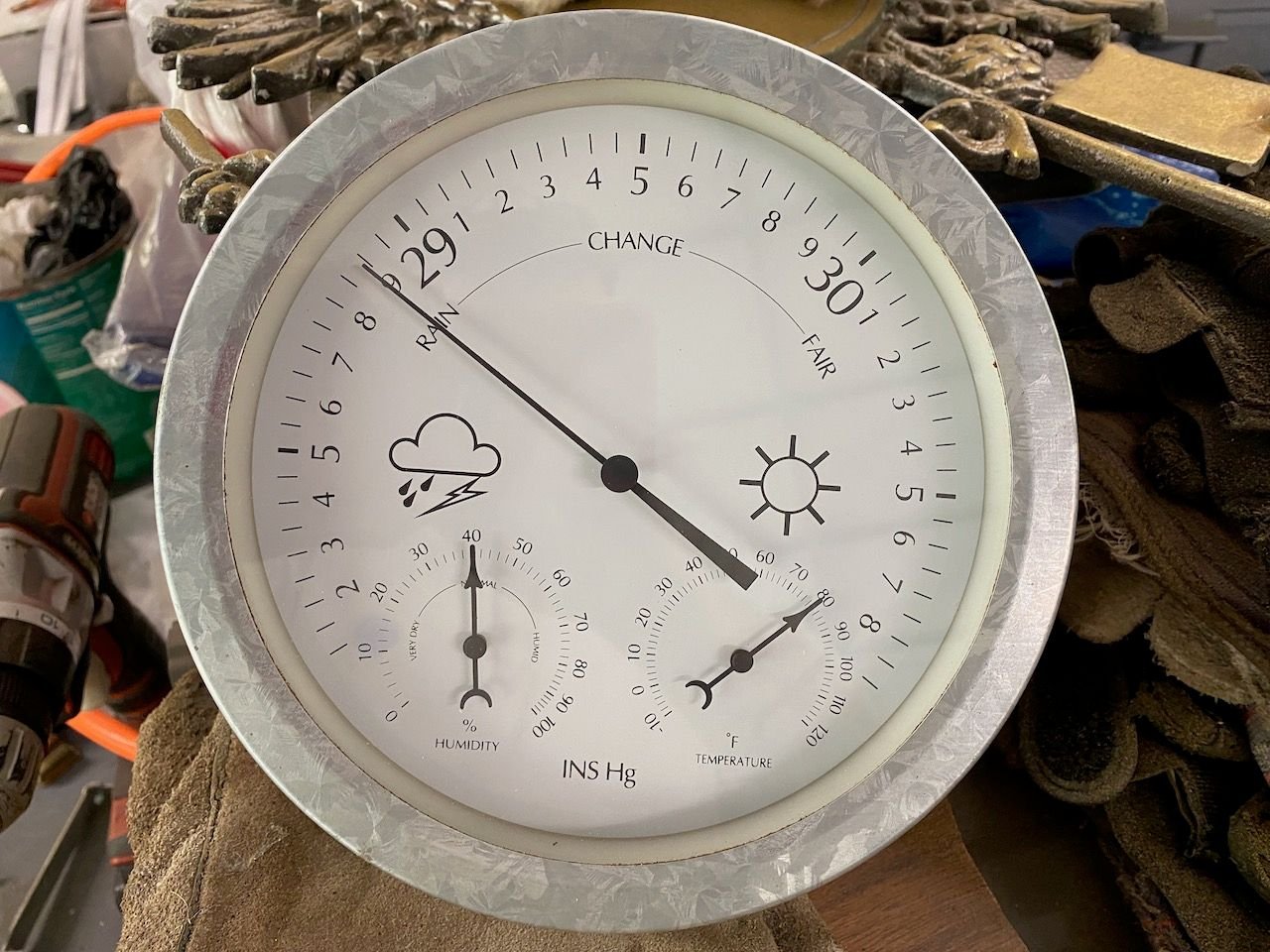

Given the Florida average temperature the dehumidifier will be preferred. I will start monitoring humidity with this little device:
