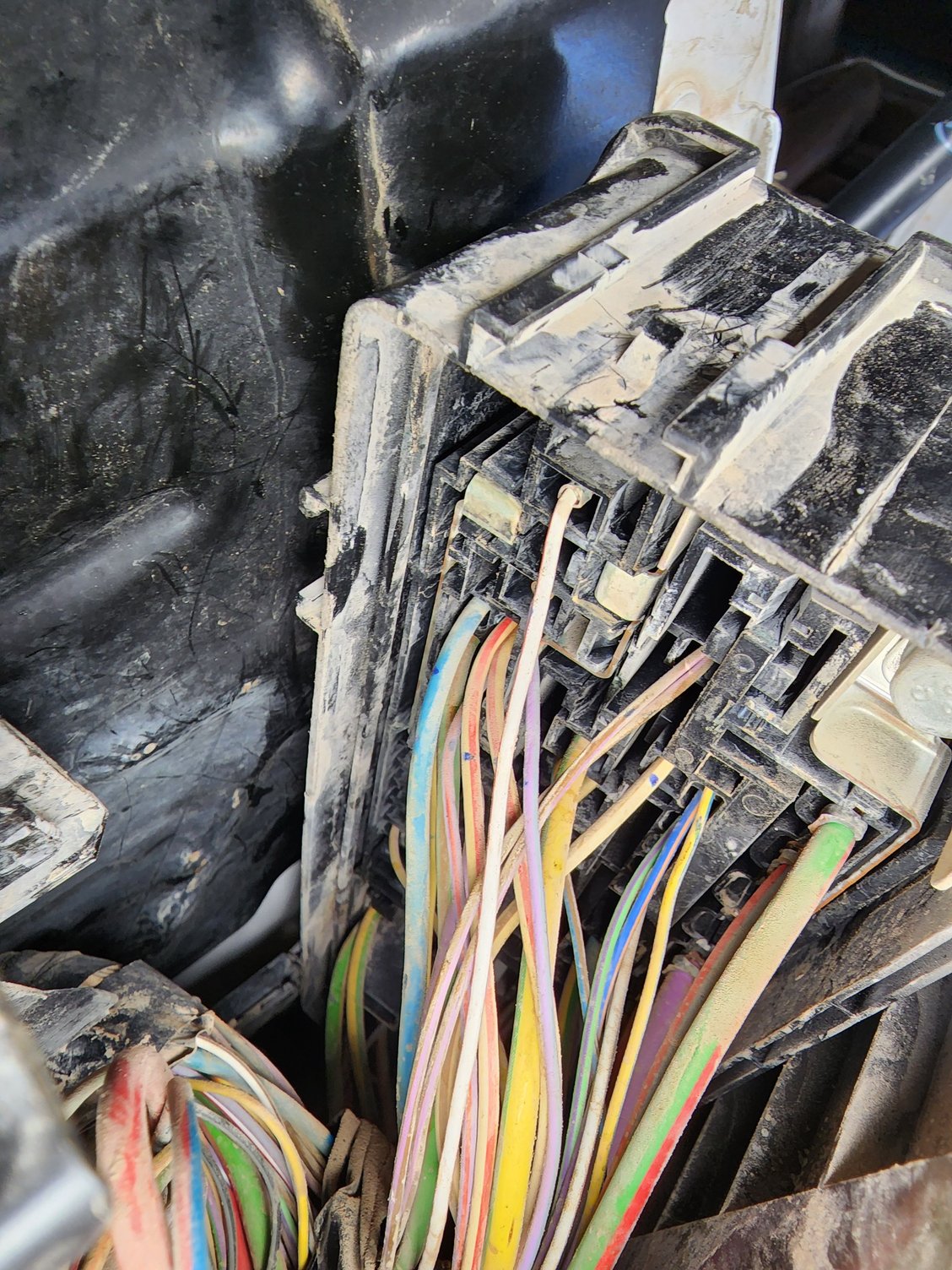

Alright, so I got into the BJB and everything seems fine.
All issues are still prominent. I am going to go start unplugging and greasing all plug in under the truck.
