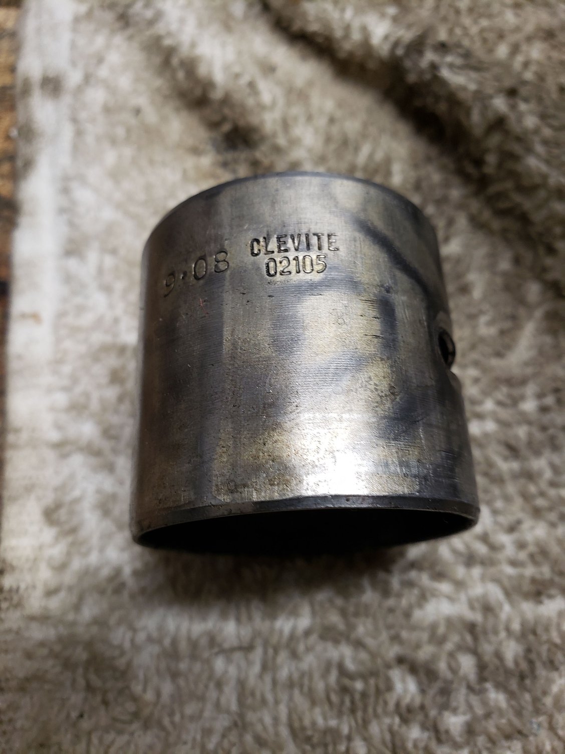

Update: Pulled the tranny and removed the rear extension housing to access the rear main bearing. First thing I noticed is the extension housing bushing came out with the yoke. It was clearly spinning in it's bore. Supposed to be a press in fit. Pulled the bearing and it feels fine but, since I'm already into it going to replace it. Have ordered seals, gaskets, and the bearing.

A new bushing might not fit tight enough in the tail housing to stay there, might need a different housing.

Agree, when the new bushing arrives I will test fit it. If it slides right in I am going to use some Loctite 609 Retaining Compound on it.

Received the replacement parts from Transmission Parts Distributors.. Output main shaft bearing, seals, extension housing bushing, and gaskets.
Test fit the new bushing in the extension housing and also on the yoke shaft.
Results: Original bushing is a little bid tighter in the housing, but loser on the yoke. New bushing is loser in the housing but tighter on the yoke.
Going to install new bushing in the extension housing using Loctite 620 Retaining Compound.

If there is a machine shop around you could get the bushing's od knurled.

Update: Took the housing to my local Transmission shop. They knurled the bushing and the bore of the housing. Pressed in the bushing with Loctite added. Just have to put it all back together.
