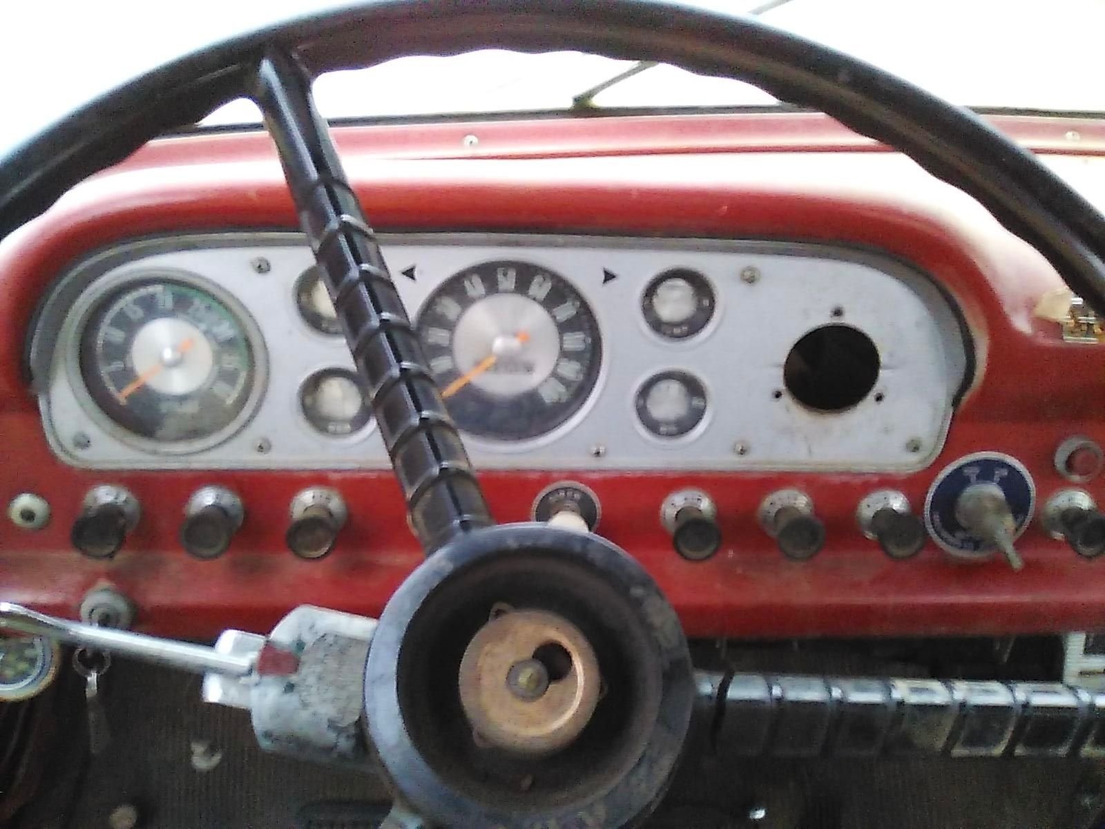

So I just got this 1957 big job, and obviously it was a fire truck at some point in its life. I am curious about the hole in the dash. Does anyone have a clue what may have went there?

A portal to a parallel dimension where the original buyer spec-ed out a tach in their dash. Its likely this one came without a tach from the factory, one of the owners wanted one and cut a hole there for it.

As OEM it was blank. Various instruments were added based on what the owner wanted. Our '58 had an ammeter and oil pressure in those spots iirc.
What is the big one to the left? Tach or vacuum?

HydroVac vacuum in inchHg. There should be a line from the intake manifold to a checkvalve/tee that would go one way to that gauge, and the other way to the HydroVac booster/reserve vacuum tank.

The one on the left is the tach.

I see now, its hard to tell from the poor resolution of the picture. The left one is indeed a tach. Someone found a tach and put it in the left hole, originally occupied by the vacuum gauge. I've never seen a tach from the factory on the left of the speedometer on these medium/heavy duty trucks.
Your air tank is actually a vacuum reservoir. Its there so that if the engine dies while you're driving, your power brakes don't die right away. You have 5-6 pedal applications left using the reserve vacuum in that tank.
Trace your vacuum lines. You should have one from the intake manifold going to that reservoir. There should also be a check valve preventing vacuum from escaping back into the intake manifold side if you shut off the engine.

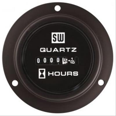

Old Jan 5, 2023 | 10:59 AM
5851a's Avatar
5851a
Joined: Oct 2006
Posts: 4,030
Likes: 891
From: East Central Ia
Old Jan 5, 2023 | 11:25 AM
Big Kaz72's Avatar
Big Kaz72
Joined: Nov 2021
Posts: 114
Likes: 24
That’s it!!! So I’ve decided to bag the truck and put a set of air horns on it. I found a 60’s model dash with the air gauge. Made the whole bigger and put it in that spot. It was a fire truck in a former life, so the hour gauge makes sense!! Thanks for the replies!!!!!
