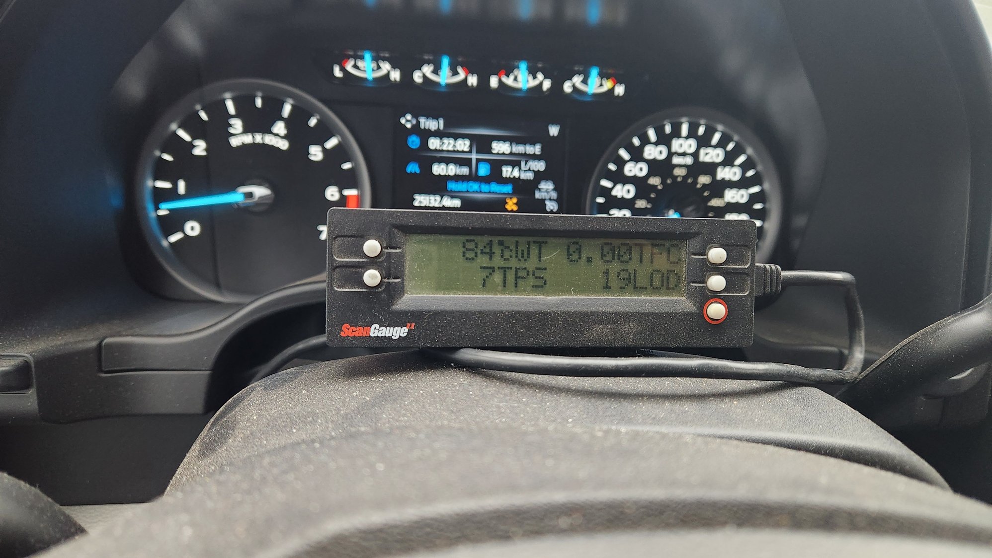

I decided to "test" this feature, and...
1 minute idle in Park = 7 cents of gas used... Throttle 7 to 8 % load 19 to 20.
1 minute of idle in "D" = 9 cents of fuel used... Throttle 8 to 9 % load 27... So, it was using more fuel in "D" than "N" and everything was warmed up to operating temps, is it BS what the manual says about the transmission going into "N" when stopped and still in "D" with the brakes on to get better fuel economy in traffic, then when the brakes come off it's back in "D"...???

The negligible cents per minute based on the ScanGuage is meaningless to me, but I would like if you can show us where the manual says anything about the tranny going into "N" while stopped, vehicle running and in "D"? I have not seen that claim in my manual. Maybe a new for 2020+ feature, or gas engine feature?
Page 210 2021 F350 manual...

Neutral Idle with F350, F450, F550
and F600 Chassis Cab Vehicles
Your transmission could reduce the load
on the engine when the vehicle stops, and
the gear selector is in drive (D) to reduce
fuel consumption and emissions. The
transmission resumes operation when you
release the brake. This feature activates
when the transmission is sufficiently
warmed, and the vehicle is on a level slope.

Adaptive learning is unrelated to a neutral idle feature. (Wrote before you added additional text) Is yours a chassis cab?

That only mentions chassis cab trucks, not your pickup.
But, even at that I never heard of such a thing before.

Oh, Whoops, well that would explain that there was a difference, .
