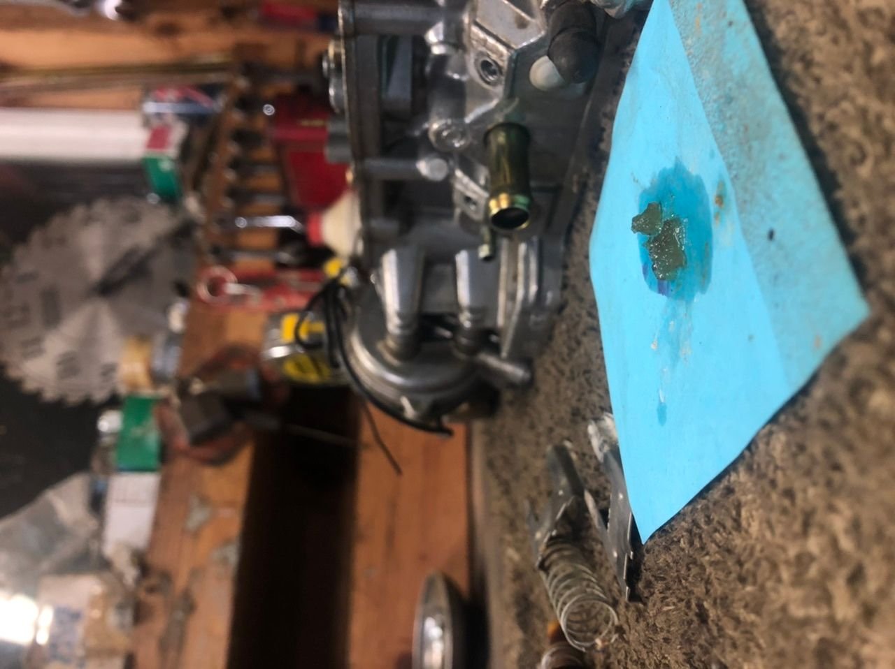

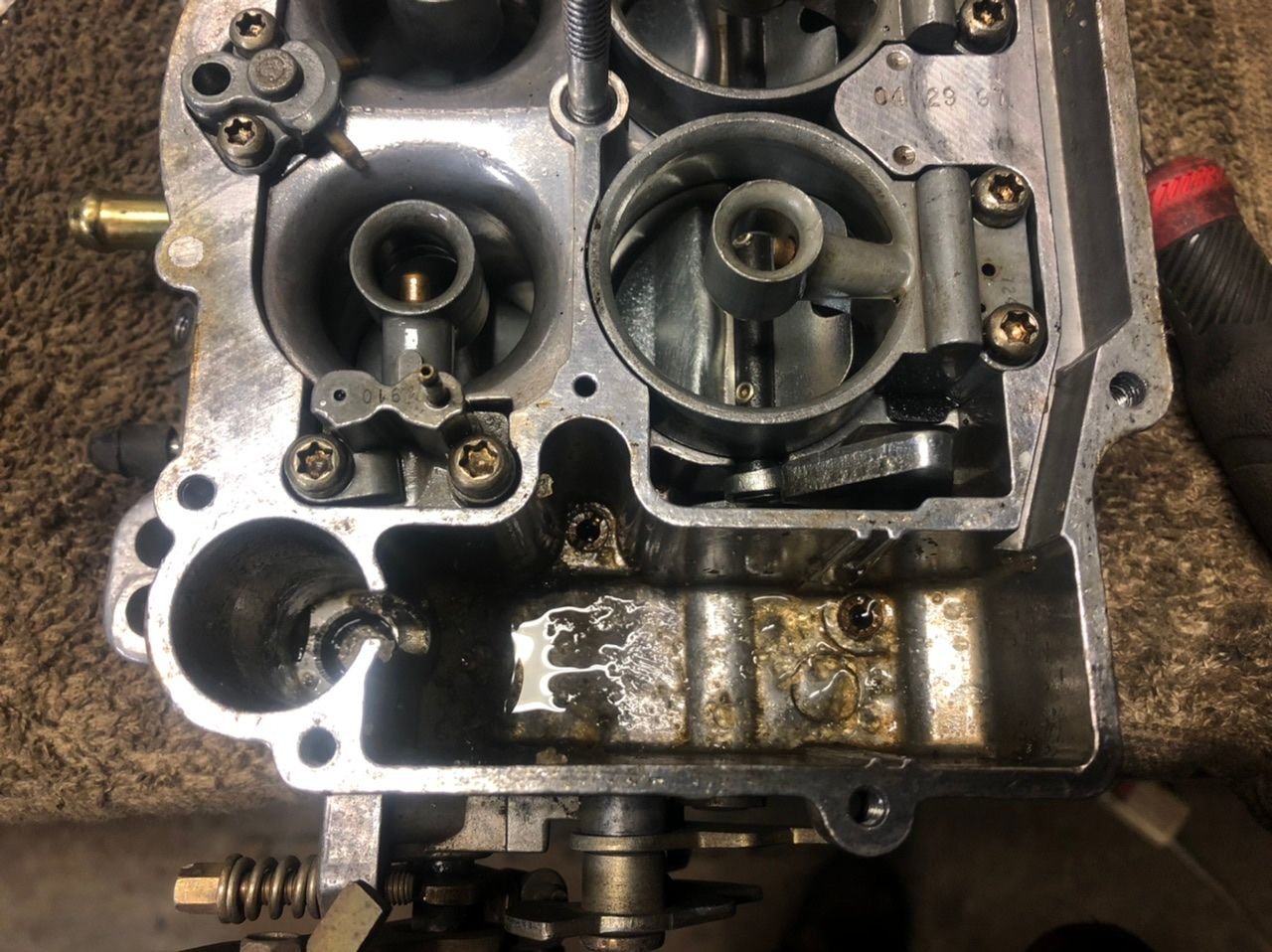

Everyone has been concerned about modern fuels. Here is more proof. The build is less than a year with newly rebuilt carb. It started idling rough and became inconsolable. Pulled it apart today and scooped out some jelly. This by no stretch is all of it but quick scoops for illustration
Disconcerting!

I recently pulled my carb & cleaned it out due to the exact issues you describe. Didn't find any jello, but the crap I drained out of the secondary bowl looked more like bourbon than gas. I also drained my tank & refilled with non-ethanol gas. I have a thread over in the 335-series engine forum on some of the issues I've been having with the motor. A machine shop guy I talked with even said ethanol fuel can cause intake valves to stick. Hadn't heard that one before, and have been running regular pump gas in my 79 K30 with a small block for years without any issues.
