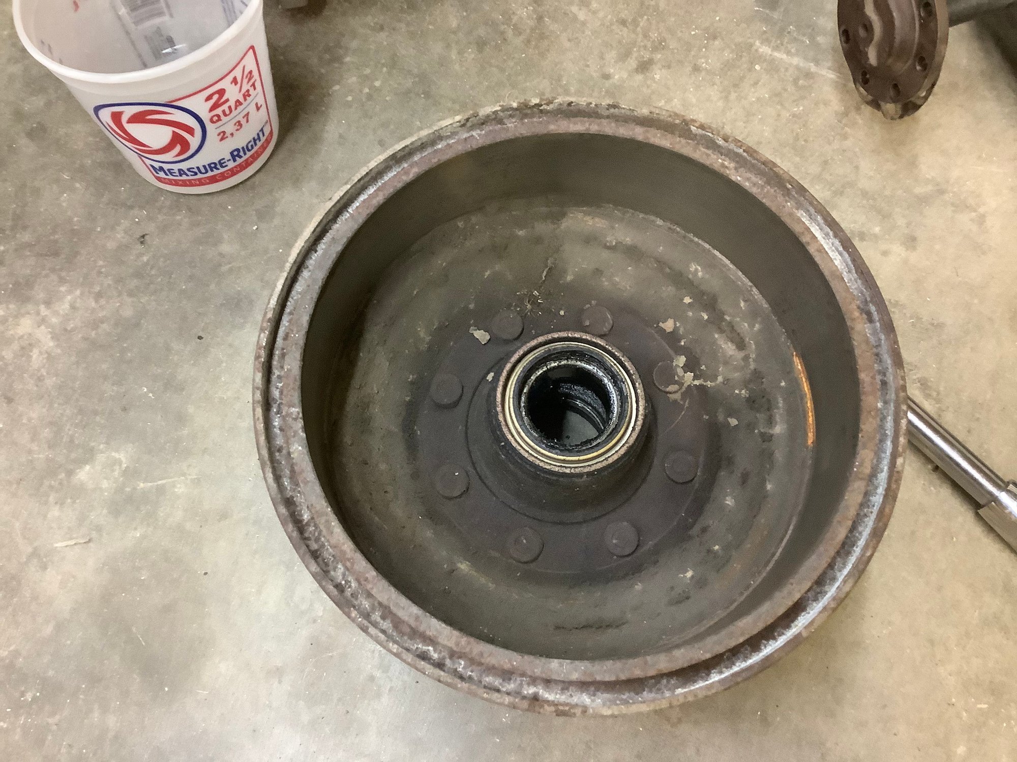

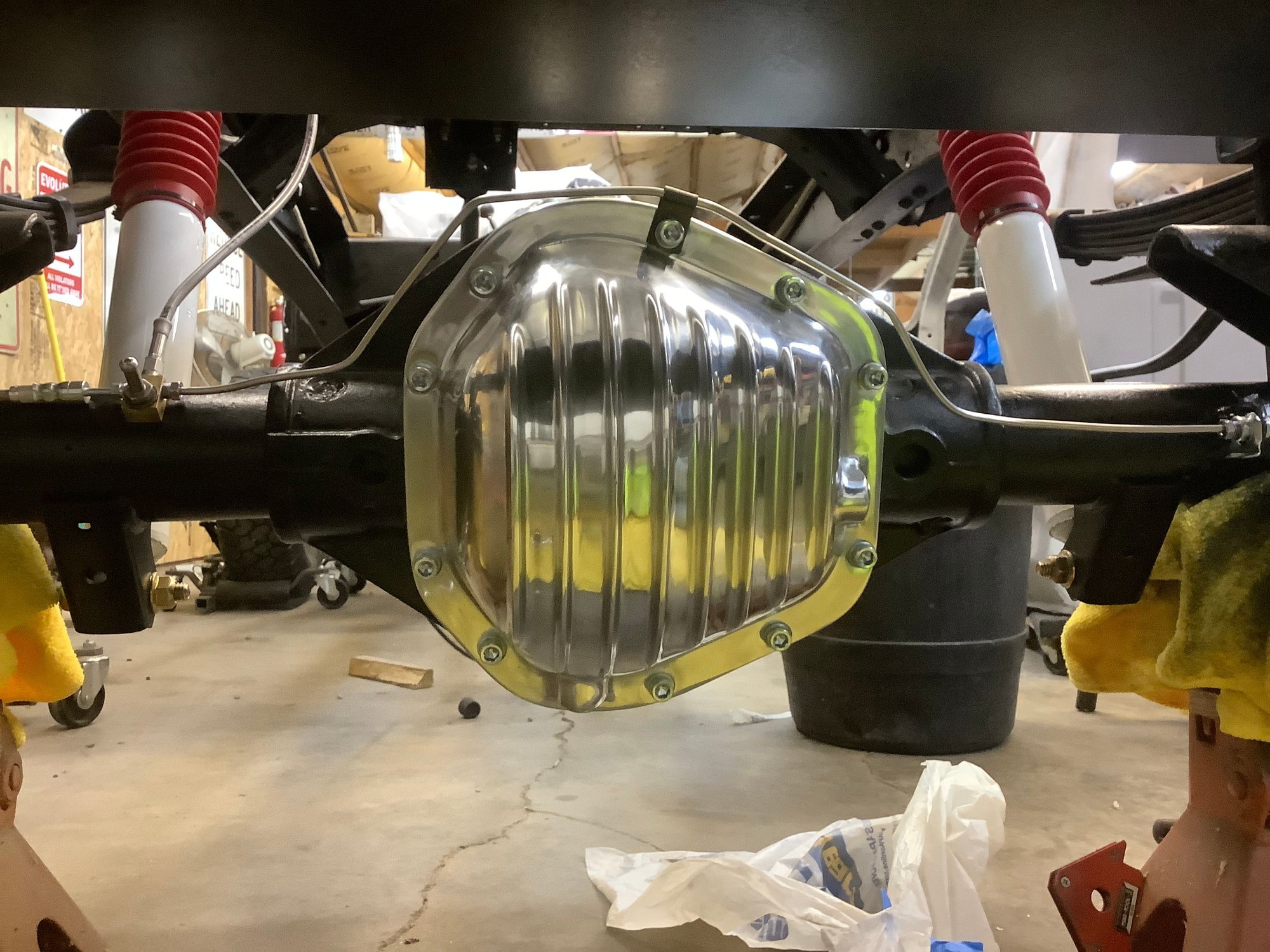

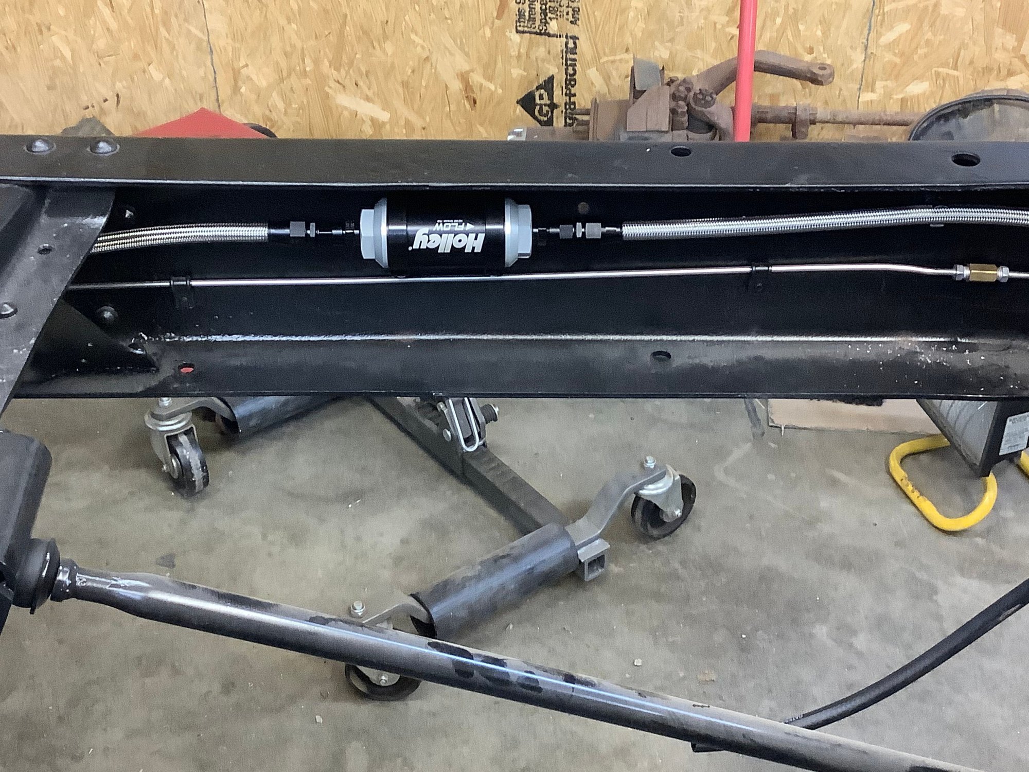

Got my rear brakes swapped to disk and fully installed the fuel tank along with the in tank fuel pump,in-line filter and pressure and return lines. I used Earls Ultrapro PTFE braided hose. It was sooooo much easier to put the ends on than the regular -an I had done in the past! Plus I will never have to change out again.

Looking good, what rear disk brake kit did you use? Does that caliper have an e-brake capabality?

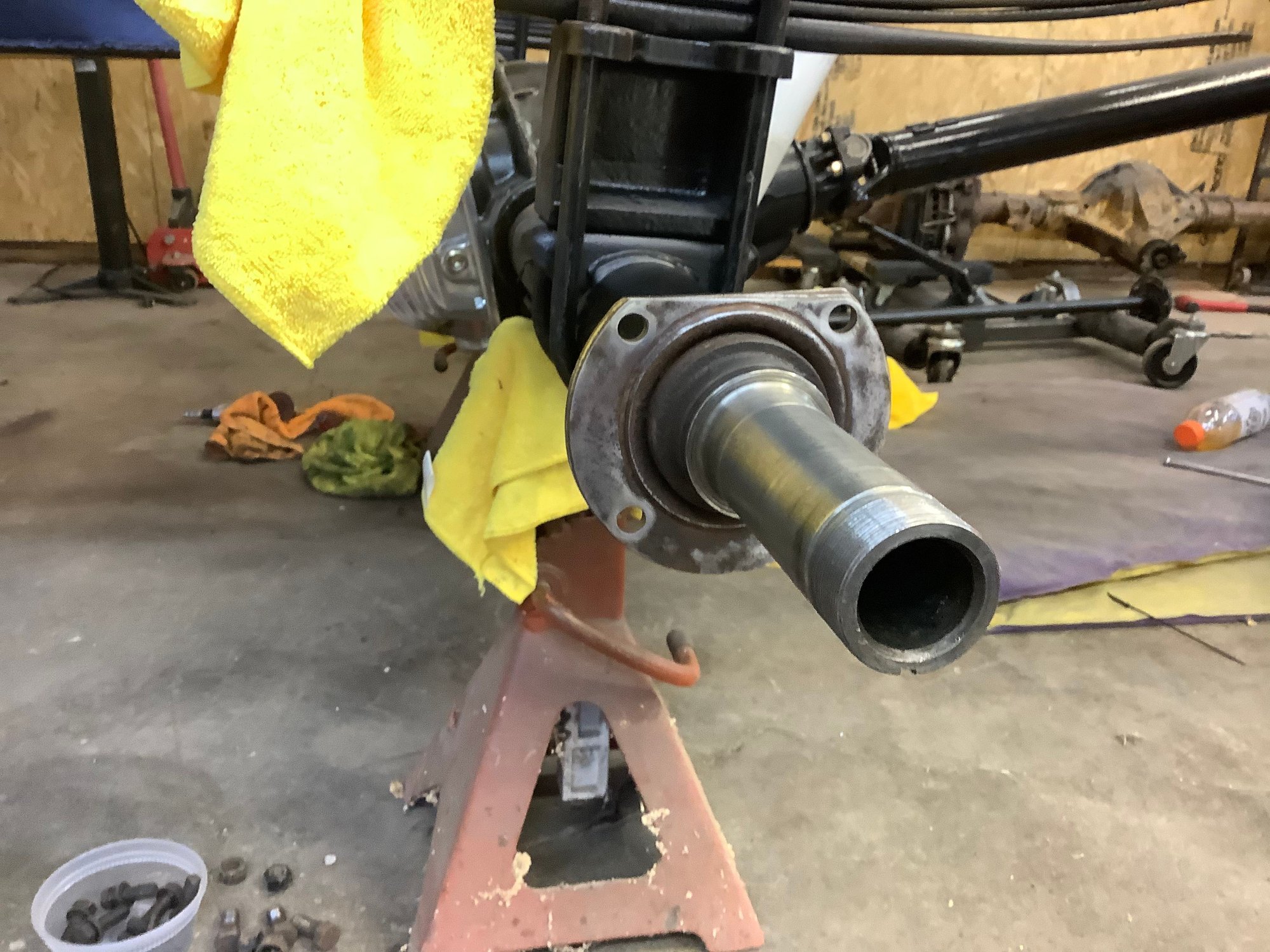

I used the Lugnut 4X4 kit. I did get my own custom made SS lines tho. I opted to forgo the park brake after hearing they never work very well. Seemed like a lot of extra money and time to source the right cables to make it all work only to have it not work. I have owned the truck 25 years and in that time the park brake worked maybe a handful of times. I now have a C6 in it and have no worries of needing the park brake. I also replaced the bearings while I was in there. The old ones looked good so it was more of a peace of mind thing since I had them on hand just in case.
