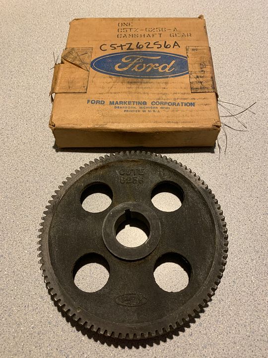

The 1965 thru 1971 4x4 trucks all came with both gears in steel. I have a 1966 F250 4x4 with 300 and it does have the steel gears and I don't even hear them. They are helical cut gears, and the angle reduces noise compared to straight cut gears which can be quite noisy in comparison.
The cast iron gears in these years had many more teeth compared to the ones used in the 2x4 trucks and cars.
C5AZ-6256-A - Camshaft gear - F100/250 2x4 and cars = 58 tooth plastic
C5TZ-6256-A - Camshaft gear - 4x4 and F350+ = 92 tooth cast iron
C5AZ 6306-B - Crankshaft gear - F100/250 2x4 and cars = 29 tooth
C5TZ 6306-B - Crankshaft gear - 4x4 and F350+ = 46 tooth.
