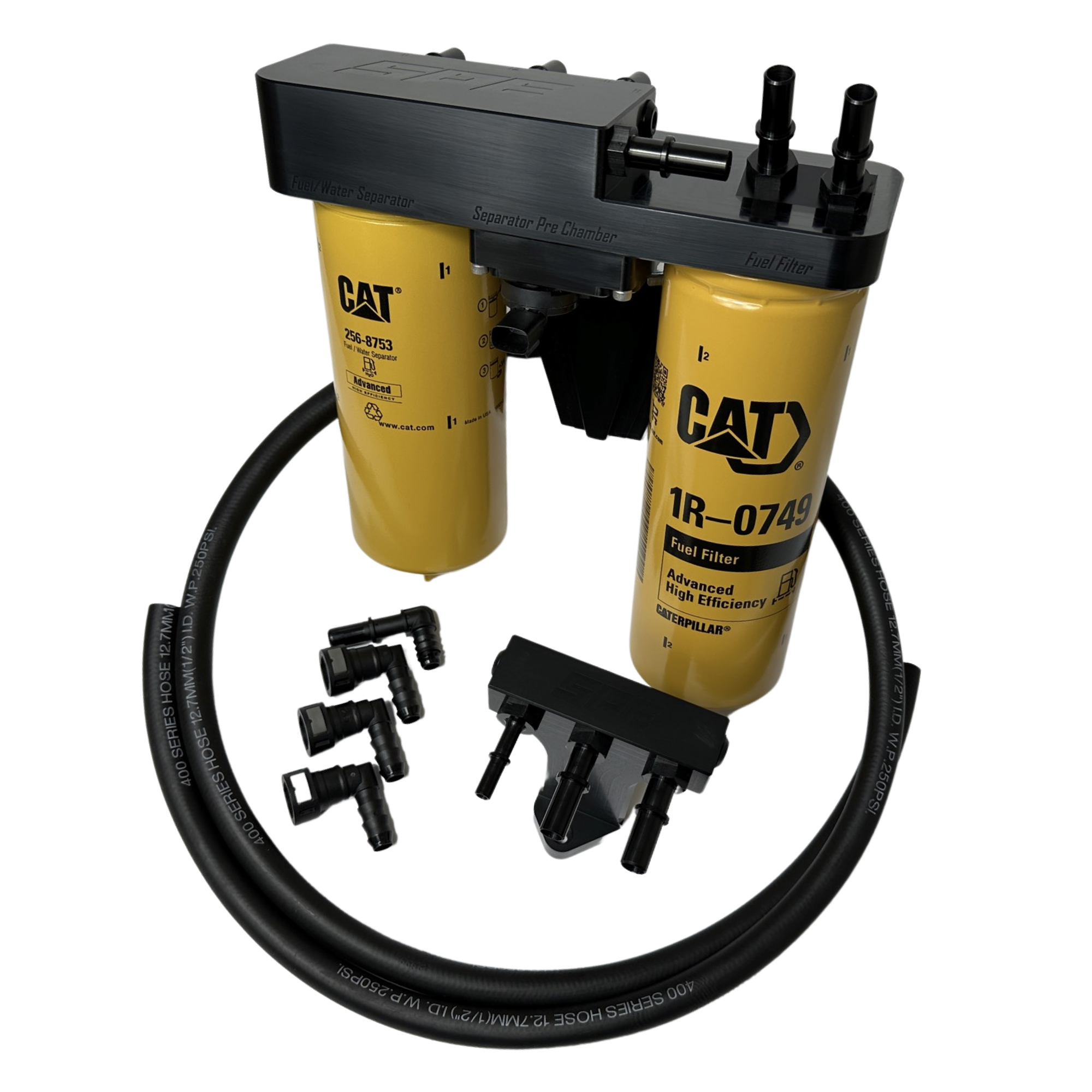

New replacement fuel filter system
Saw this today from SPE on their Black Friday ad.
https://snyder-performance-engineeri...awDw%3D.JCirzJ
Replaces all the OEM stuff with one unit.
https://cdn.shopify.com/s/files/1/13...g?v=1669307966
I put this on my short list, might give it consideration when it comes time to replace the filters.

If considering an aftermarket fuel filtration system replacing the Ford filtration system, my first question would be is how it performs with removing water from the fuel compared to the Ford filtration system. The problem here is CAT doesn't use the fragile CP4.2 pump and CAT's filters may not have to perform that great in this regard since they don't use the CP4.2, whereas Ford knows very well how sensitive the CP4.2 is with water.
For me it would be a very hard sell to abandon the Ford filtration system.

According to Caterpillar it removes 100% water and 90% emulsified water. The second filter is also a 2 micron compared to the 4 micron stock filter.

I too would have a very difficult time going away from Ford's engineered system. Ford pays people good money to engineer these systems and analyze a lot of data (dealer repairs/reports, lab analysis, etc) that a small aftermarket company wouldn't have access or the funds to. I learned with our 6.0 that 'aftermarket' parts are not better 99% of the time. I actually would love to see some of these aftermarket parts have a name like 'rainbow powder puff head gaskets' and see how many people would buy them.

Ford has their bottom line and getting you past the warranty period on their mind, not what the best possible filtration method is.

My thoughts is get something with a motor and place it in the middle of the existing tank pump and engine bay pump…that way if your tank pump fails you have a working in line pump.
afe sells on and so does airdog, and a few others.

I'm not about to replace the factory setup, but I would like to ADD an auxiliary filtration setup if a kit became available.

I believe one of the main reasons for CP4.2 failures is water contamination and one way to extend the life is to improve filtration which I believe they did. Again the HPFP design and the pressure it's operating at commands better filtrations. My John Deere 3532 tractor has a Yanmar diesel with a fuel filter that looks like it would be suitable for a lawn mower. Obviously the HPFP is probably a low pressure design that could injest just about anything and still function.

I have always wondered why Ford used a cumbersome fuel filter system when Caterpillar can filter diesel fuel with two or three simple fuel filters. And their machines are made to work in dirty environments at sustained high rpms. Why did Ford feel it necessary to "re-invent the wheel" when simpler, efficient systems were available.
