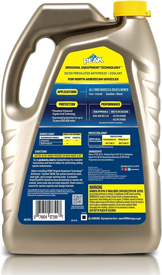

My 19 has the yellow coolant in it,and I need to add a little.can I use any other besides motorcraft

Peak yellow coolant claims to be fully compatible. I bought a gallon but haven’t added any yet.

Why? Is there something it has that the Peak doesn't? I had an 01 Powerstroke and Ford recommended an inferior coolant where you had to add some additive every 15K. The manufacturer of the motor was International and they used a different coolant that tested out better and had a longer life with no additive. Many, including myself switched to the ELC.

I'd sure use the Peak, probably costs less than the Motorcraft and is the same formula.

It's the same formula, use it with confidence and no additives. It has a 200,000/6,000 hour change interval on the initial -
