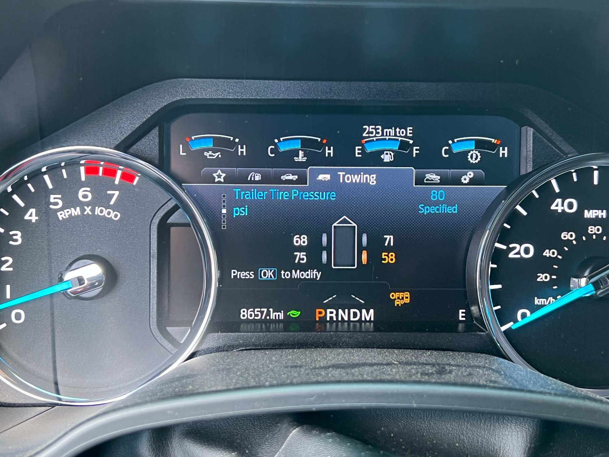

The receiver I have is part number HC3T-1560-AC. The sensors I have are part number HC3J1A515ACSUB7. As you can see in the next two photos the pressure and temperature are working in my truck.
Tire pressure started at 80 psi, these are the values after dropping pressure to connect each sensor.
Scrolling to the next screen down, these are the temperature values. They seem legit because the right side was in the sun.
For what it's worth, those 2 screens have been in my truck since I took delivery in August, 2021. And in case it makes any difference, it's a 2022 Lariat ordered with the "Value" package, UTT Cameras, 5th wheel prep, and the customer installed trailer camera/tpms system.
