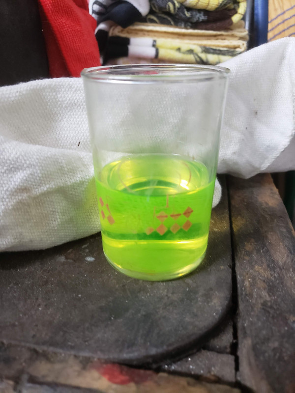

every time I start my truck the exhaust smells sweet. today after towing 50 miles I check the coolant and it is low. but both bottles look like green coolant.

THat actually looks like the Yellow/Correct coolant. My 19 came with yellow but looks identical.

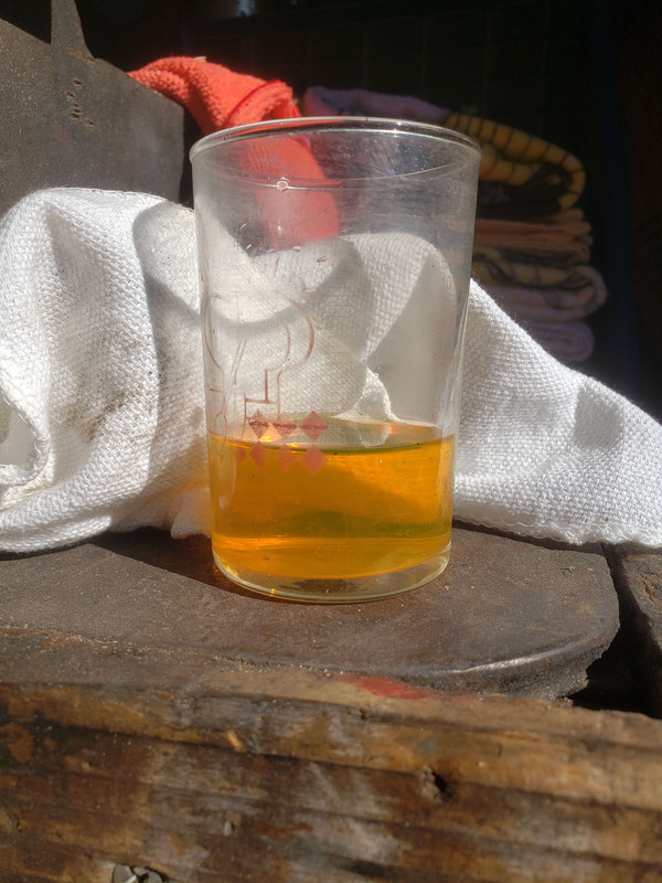

Motorcraft Yellow 50/50 straight from the bottle.
This is what my primary system looks like after the dealer "flushed the system" and replaced the old orange coolant with the new yellow.

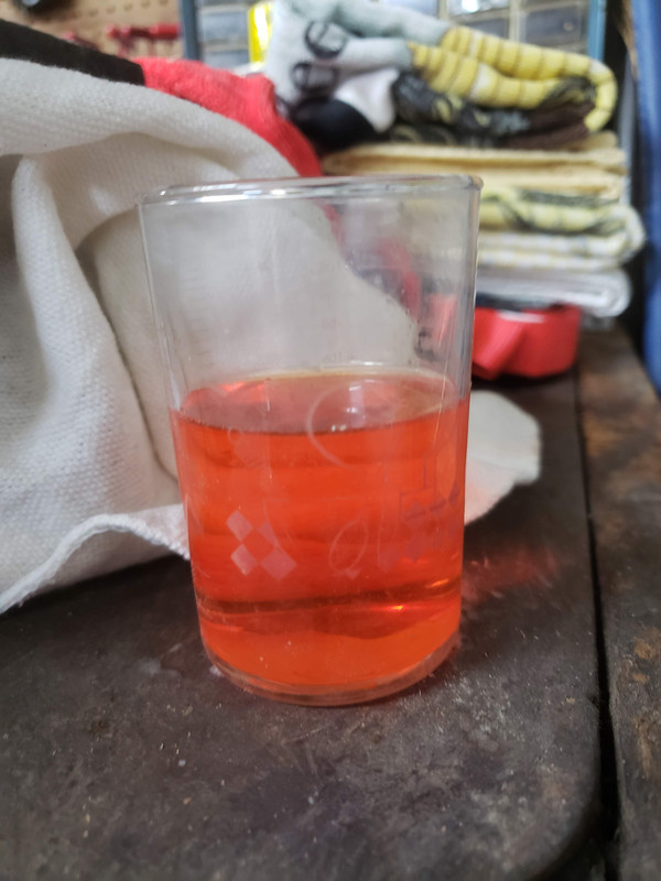

And just for reference - Motorcraft Orange 50/50 straight from the bottle.
