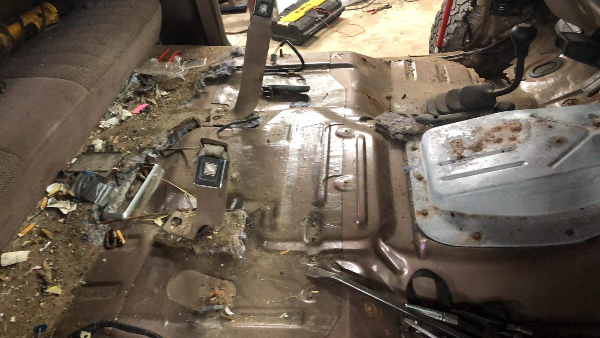

Those are Buckets and NOT a 40/20/40.
They will bolt right into your supercab. If you go under your truck you should see 4 bid bosses where the inner 4 holes should be.
As for the console it just uses 3 self tapping screws into the floor

I wanted to attach a picture of the floor of the guy's extended cab, just need a tiny bit of help wondering if it would be entirely the same to mine.
