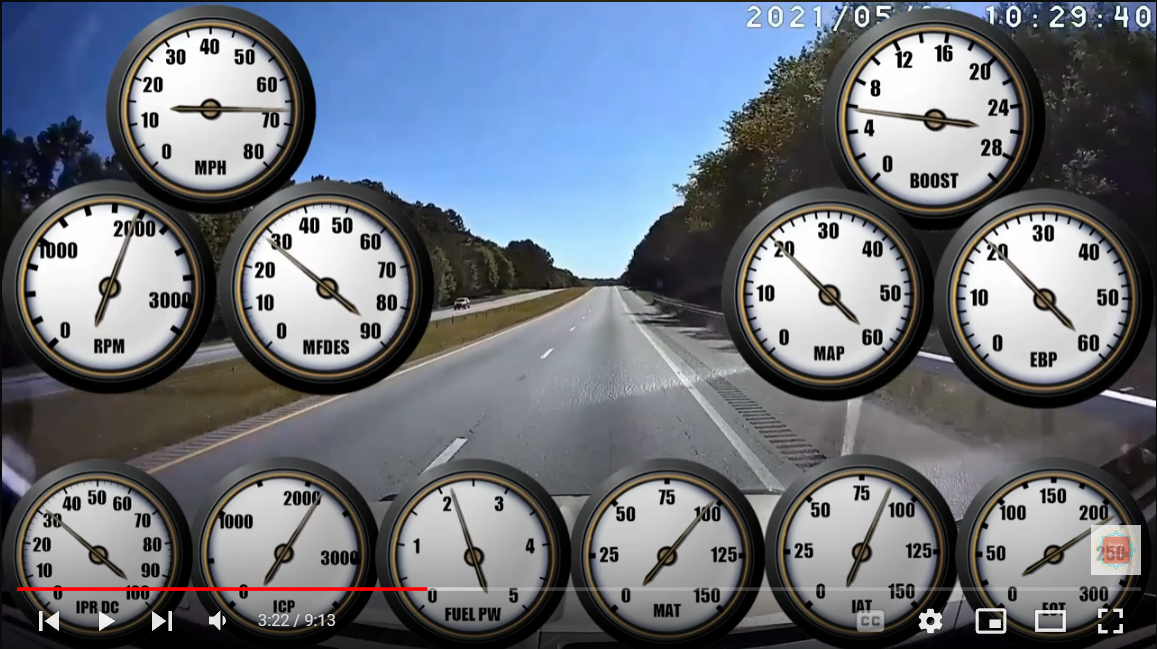

Yes, on a cold engine with the ignition ON and the engine OFF, MAP, BARO and EBP should be within .5 PSI of each other. If one is askew, then it is suspected as being faulty.
While testing the EBP vs MAP is going to be off unless your forced air induction system is in good shape, including the drive pressure and up-pipes. Below is a snip of a video I took after installing a T4 kit and a Borg Warner turbo. You can see from the dials in the top right MAP, EBP and Boost are right there for easy comparison.
This is cruising at 67 MPH towing a 5th wheel. You can see that MAP and EBP are 1:1, which is ideal. Even on a very well flowing forced air induction system it is difficult to get a 1:1 ratio when accelerating or running the engine at or near maximum effort.
