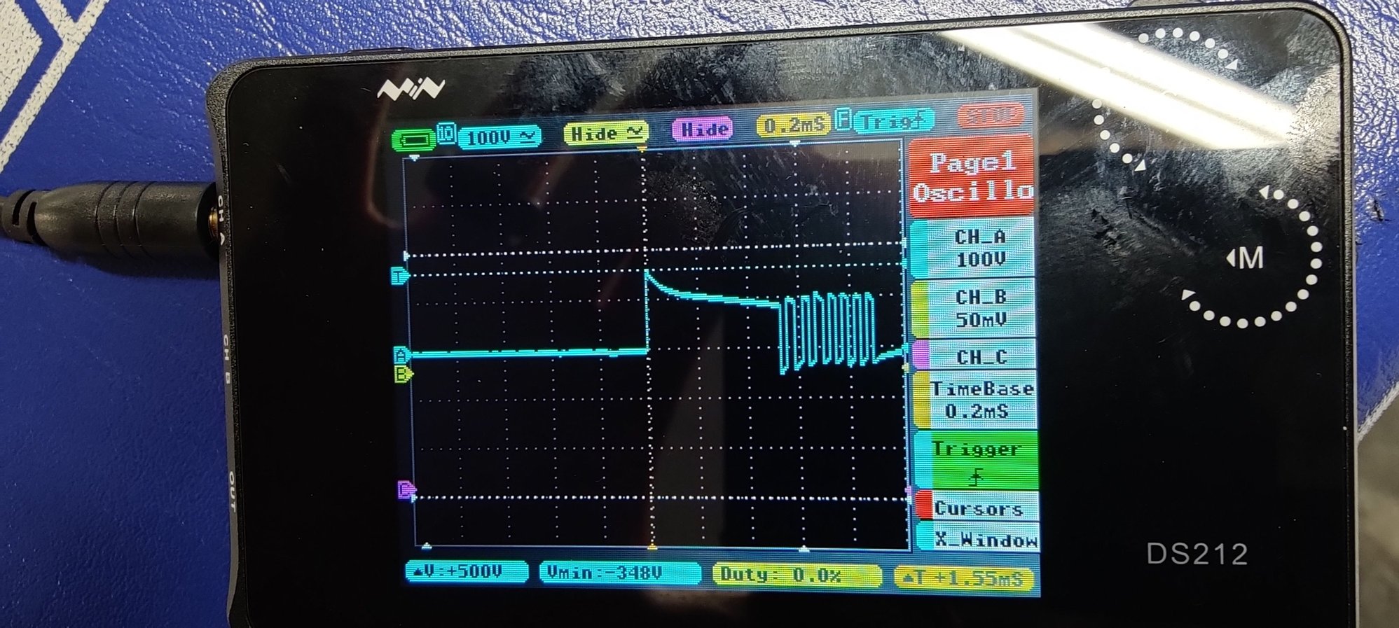

Originally Posted by Kintla
Maybe I'm missing something, but cylinder 3 and cylinder 8 failing a CCT is usually something to ignore, especially if truck is running fine without a miss or stumble.
Do you have a SES light on?
Fortunately I don't know anything about passing a smog test in California, but surely they don't run a CCT?
^^emphasis on this. 3 and 8 fail on mine all the time and I chased ghosts. I've seen threads discussing this being related to the new CPS
Failing a buzz test is more concerning. I failed buzz tests for weeks after replacing my injectors. I had three issues:
  1. Loose connector on outside of valve cover. The locking clip wore out.
  2. Loose connector on inside of valve cover. I could could read this on a meter. I returned that gasket.
  3. Spread pins on cylinder 8 connector. I returned that gasket
Finally, I ended up shorting out my IDM when degreaser made its way past the gasket on the connector.
These are four issues that can give you a P0308, that AREN'T internal engine failures. Try swapping the connectors as well to see if the issue follows the circuit.
Note that the injectors run on roughly 115V AC, not 12V DC. I've had bad connections read 0 ohms
Is this Bill Hewitt? It's not AC.
Old Dec 2, 2022 | 02:10 PM
  #42
Y2KW57's Avatar
Y2KW57
Top Answer: 5
Top Answer: 10
Joined: Dec 2011
Posts: 13,325
Likes: 6,098
But it blows cold when you put it that way.
Old Dec 3, 2022 | 11:48 PM
  #43
aawlberninf350's Avatar
aawlberninf350
It's a Van Gogh
Joined: Feb 2010
Posts: 7,813
Likes: 1,335
From: Elk Grove, CA
Nah it alternates hot and cold, optimal defrost setting.
Old Dec 4, 2022 | 05:45 AM
  #44
JeepGuy93's Avatar
JeepGuy93
Joined: Feb 2017
Posts: 257
My statement came from a misreading of my oscilloscope (which I have very limited experience on), not regurgitating YouTube and forum posts. I just did some more research on why the voltage pulls negative. I just assumed I was getting a bad reading due to my limited scope skills or my cheap scope, and that is why it doesn't read like a sine wave. It's just the nature of a valve solenoid. I was wondering why the powertrain diag manual list this at 115V if that's the peak, and AC is usually measured in RMS voltage. DC would make more sense.
Anyway, the original point was to emphasize the importance of checking the circuit connections because I spent hours tracing through the circuitry to find each weak connection in both old and new parts. I'm following along with the PCM reflash too, I'm interested to see if that works.
