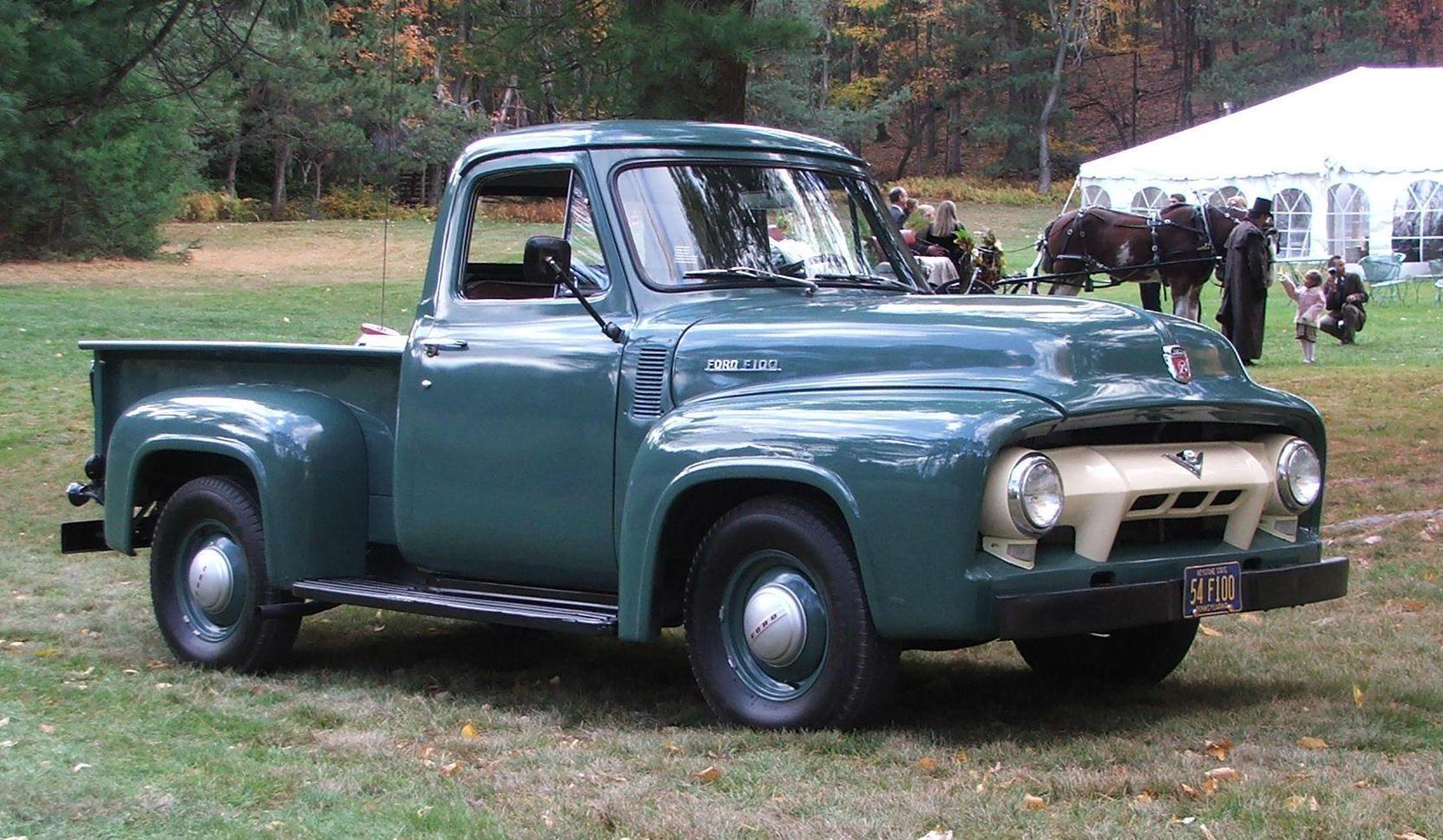

On my stock 54 F100 I have 16×6.00 bias plies made by Excelsior. They have the pie crust edge. If I had to do it over I would get 16×6.50.
with radials
with Excelsior bias plies

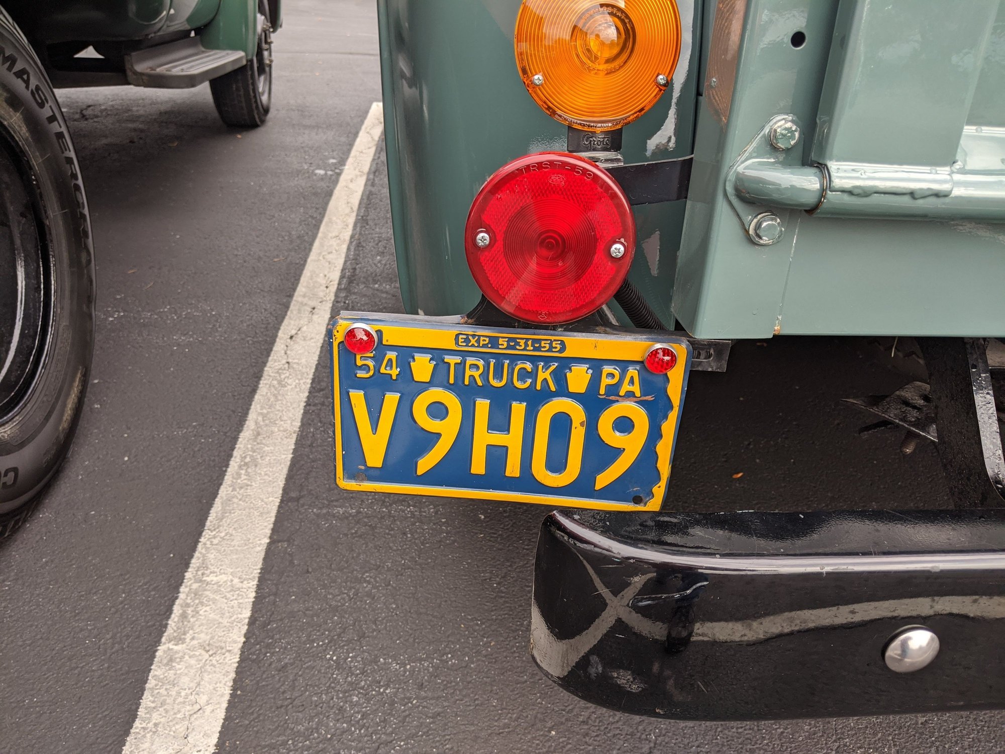

You should get antique tags Abe then you don't have to have it inspected and you could run 1954 license plate.
Old Dec 9, 2022 | 06:00 PM
abe's Avatar
abe
Joined: Dec 2000
Posts: 25,378
Likes: 5,387
From: Central PA
My truck is registered with Classic tags. I have a YOM plate. I went with classic because I did want a yearly safety inspection.
