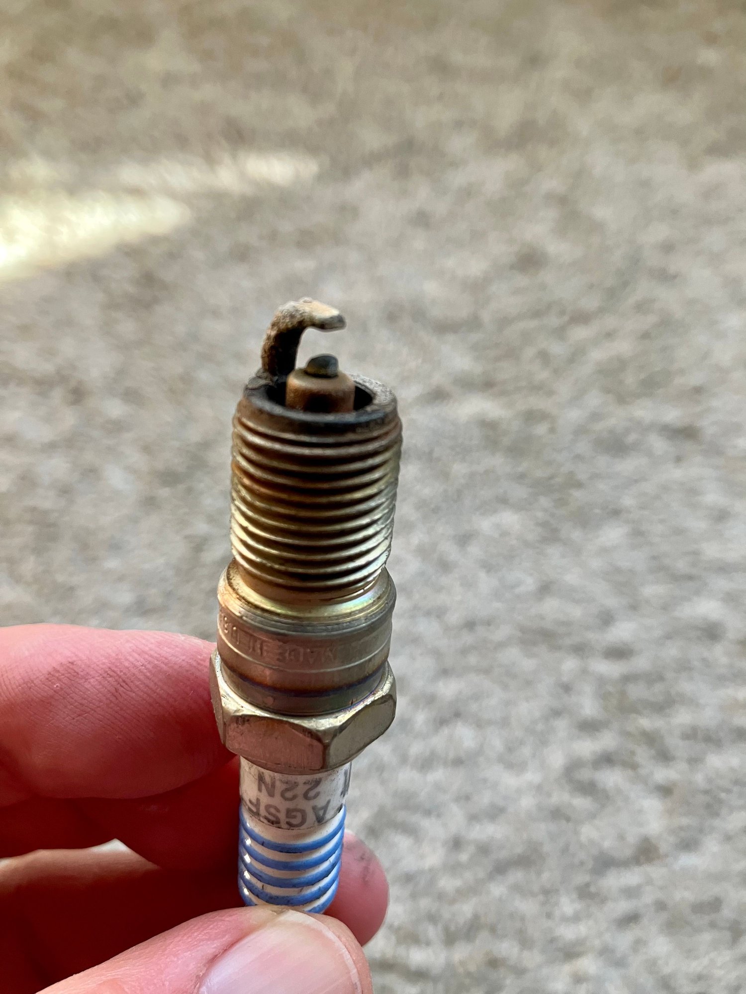

This is plug 1 -
I measure .083”/2.05mm

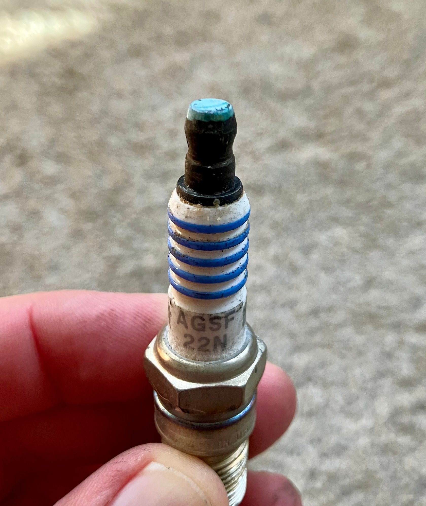

Whats the blue stuff on the contact pin? Feels more like dry toothpaste than corrosion.
The boot remained on the plug when I removed main coil body. A spring stayed attached to the coil body. The spring slips loosely over the plug contact pin. Should there be some interference or should there be a terminal between the spring and the plug?

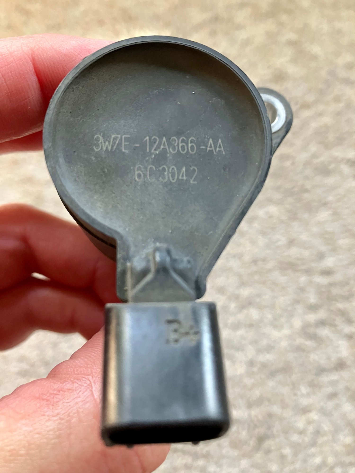

Is this an OE coil? I read about a yellow dot on OE coils. I don’t see any yellow dot here -

Hmm… AGSF 22N aren’t platinum. AGSF 22WP or SP479 it is.
Looks like boot tension pushes the spring onto the base of the connector. No interference or friction between the spring end and contact pin. No terminal on the spring either.

The center electrode is worn and the plug looks real old
The gap gets big when the plug wears down the center electrode
You had better tune it up and replace all the coil boots
