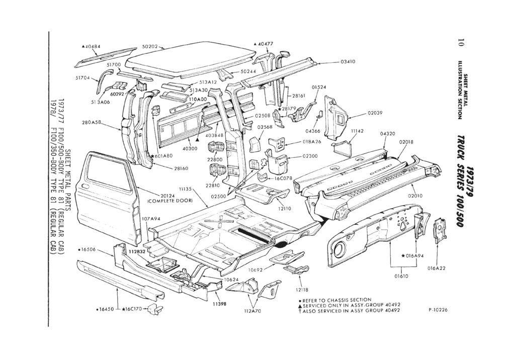

Have you inspected the condition of the OEM cab bushings? Are they dry rotted, smashed, gone, is the fwd cab corners (below floor pan) #112A70 solid?
