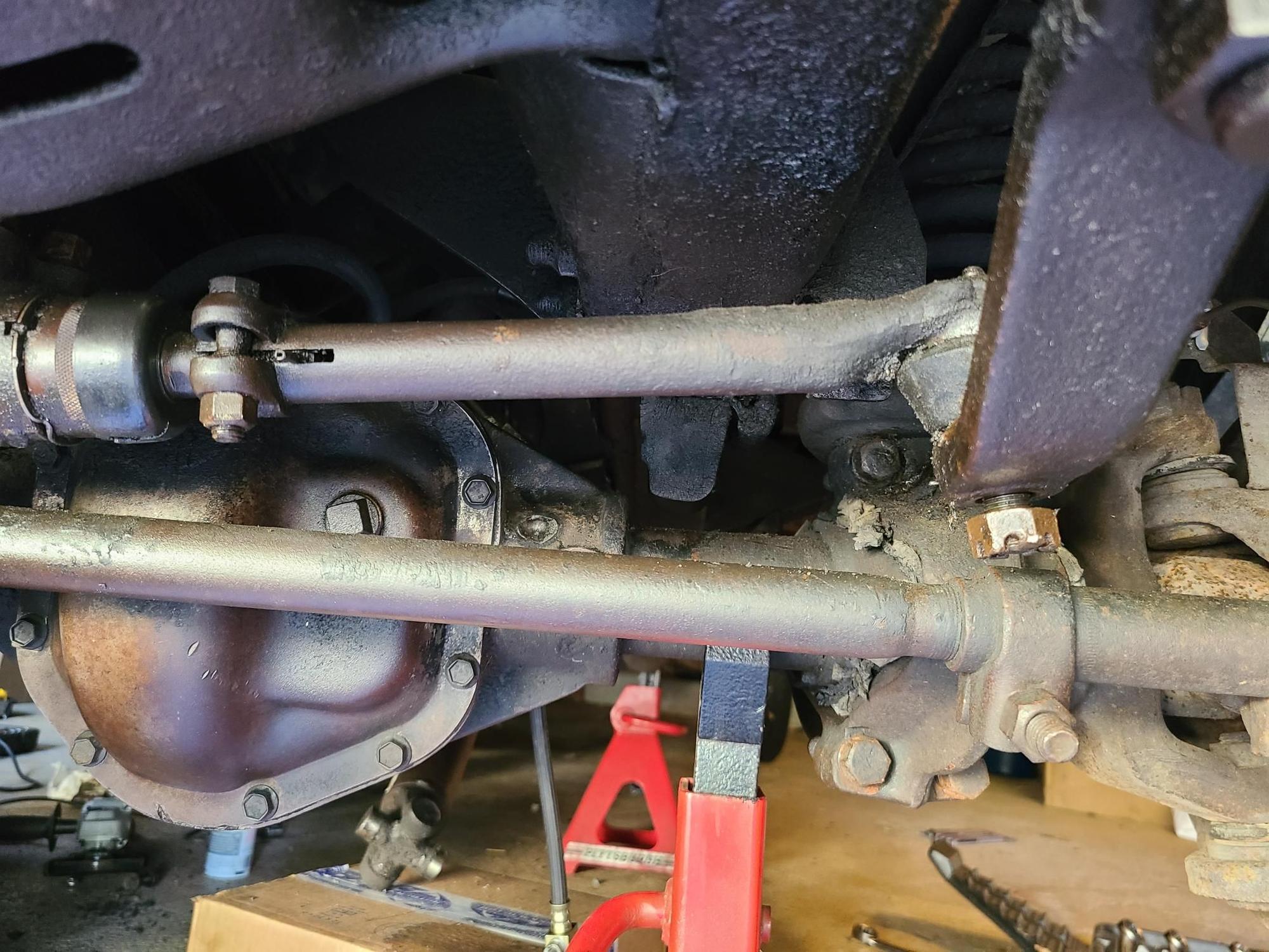

Good Morning, We have a 75 F100 4x4, looks like a Garrison type steering ram, we are looking for the part from the Pittman arm to the Ram, cannot find anywhere. We were disconnecting it to move front axle to replace bushings, crown nut may need to be cut off, would like to have a replacement in case damage the threads. I am attaching some pictures. We are starting to think this is not the original steering assembly to the truck since we can't find this part under this year make and model. I included the pictures of the whole system, but we need the drivers side end. Any help is appreciated.

https://fcrcmachine.com/rare-parts-l...100-4wd-25889/
Search for a drag link or tie rod end.
I think Ford called em drag links​​​​​​

Link assy., steering drag
Fits:
73-75 F100-150 w/ 4 WD and Power steering
L.H side, 9-13/16" long X 3/4"-16 female thread
Incl. clamp and attaching parts
P/N D3TZ-3304-E
Green Sales, Cincinnati, OH has 2 (800) 543-4959
Bowman Sales and Service, Bowman, ND has 1 (701) 523-3257
