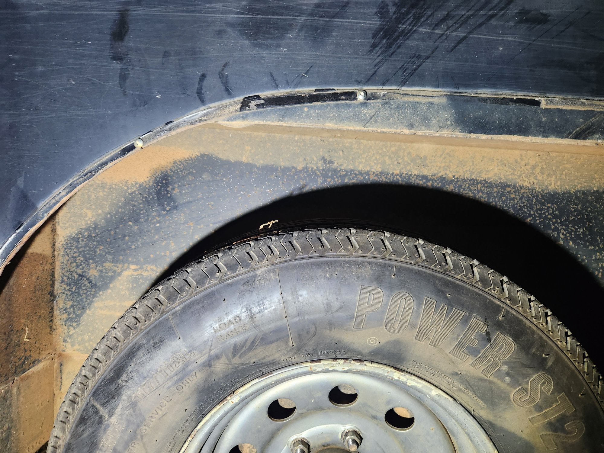

So, with my latest purchase of my used, enclosed trailer, I've got a lot of work to do. I have already been working on it a bunch and was amazed how worn out the suspension was. So I figured I would share. This first picture is before I fix the suspension but I'm posting it so you can see what the trailer looks like.

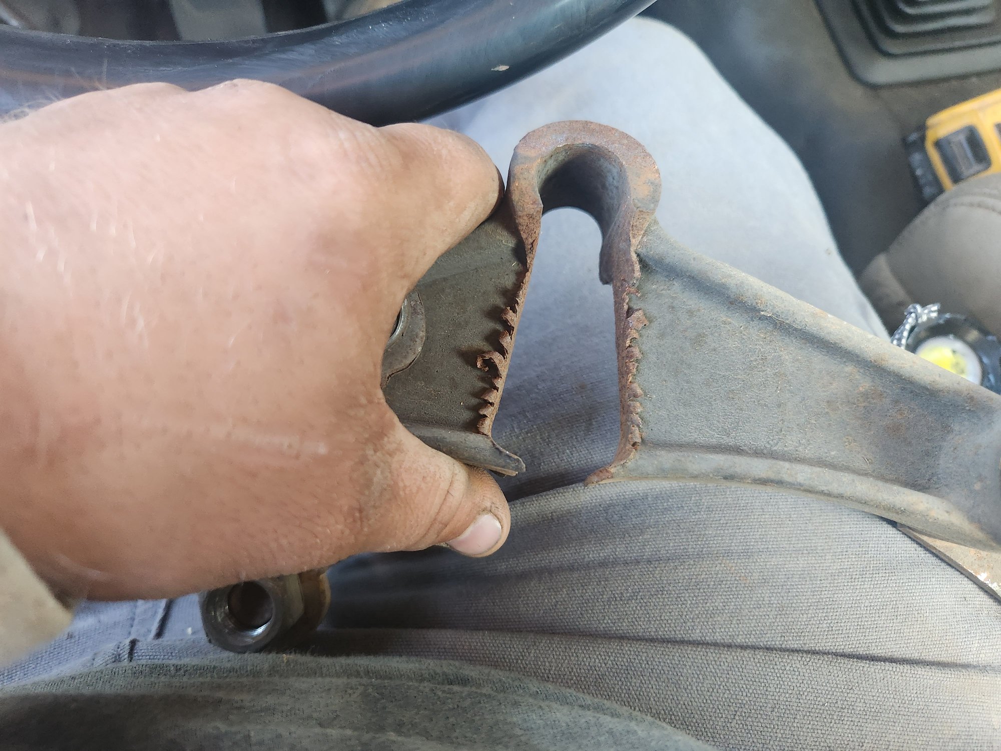

I do believe these equalizers are worn out! The leaf springs were riding on the frame! The previous owner was complaining that it rode too low and bottomed out on hills all the time. You'll see how it is now in the next pictures!
And here's after! It's like 4 in taller! LOL
Leaf springs riding on frame, this is before I redid the suspension.

I repair semi trailers for a living. Camper equalizers and shackles along with enclosed trailer ones are junk and don't last no time if it gets used regularly. They have plastic "bushings" if you even want to call them that in them. There is a upgradeyou can do called a wet bolt kit. It's comes with brass or bronze bushings and the bolts has grease fitting in them to keep them greases. Also the shackles which wear through are twice as thick on them. I'll post a Amazon link to some. They are a pretty good upgrade.
MORryde UO12-016 Heavy Duty Shackle Upgrade Kit, CRE3000 / Stock / Equaflex 2.25" Shackles - Tandem Axle https://a.co/d/fqXjK7P

I'm surprised that spring shackle hadn't broken in half yet!!
The other one went all the way through the bottom!
I had heard about him but I wasn't sure if they were any good. I'm going to get me a set! Thanks!

That is impressive, wow.
Wow! I'm gonna have to go check all my trailers!
