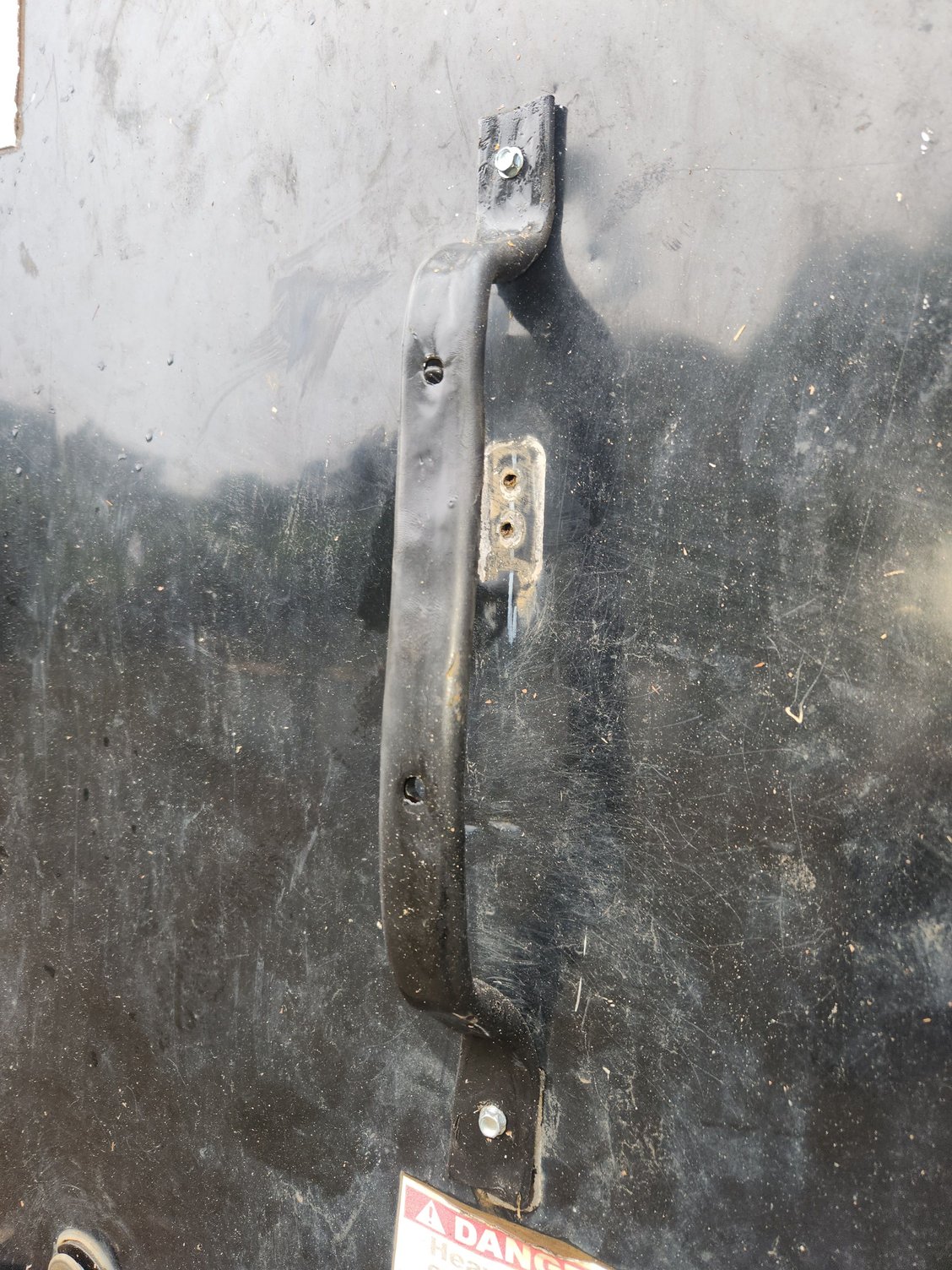

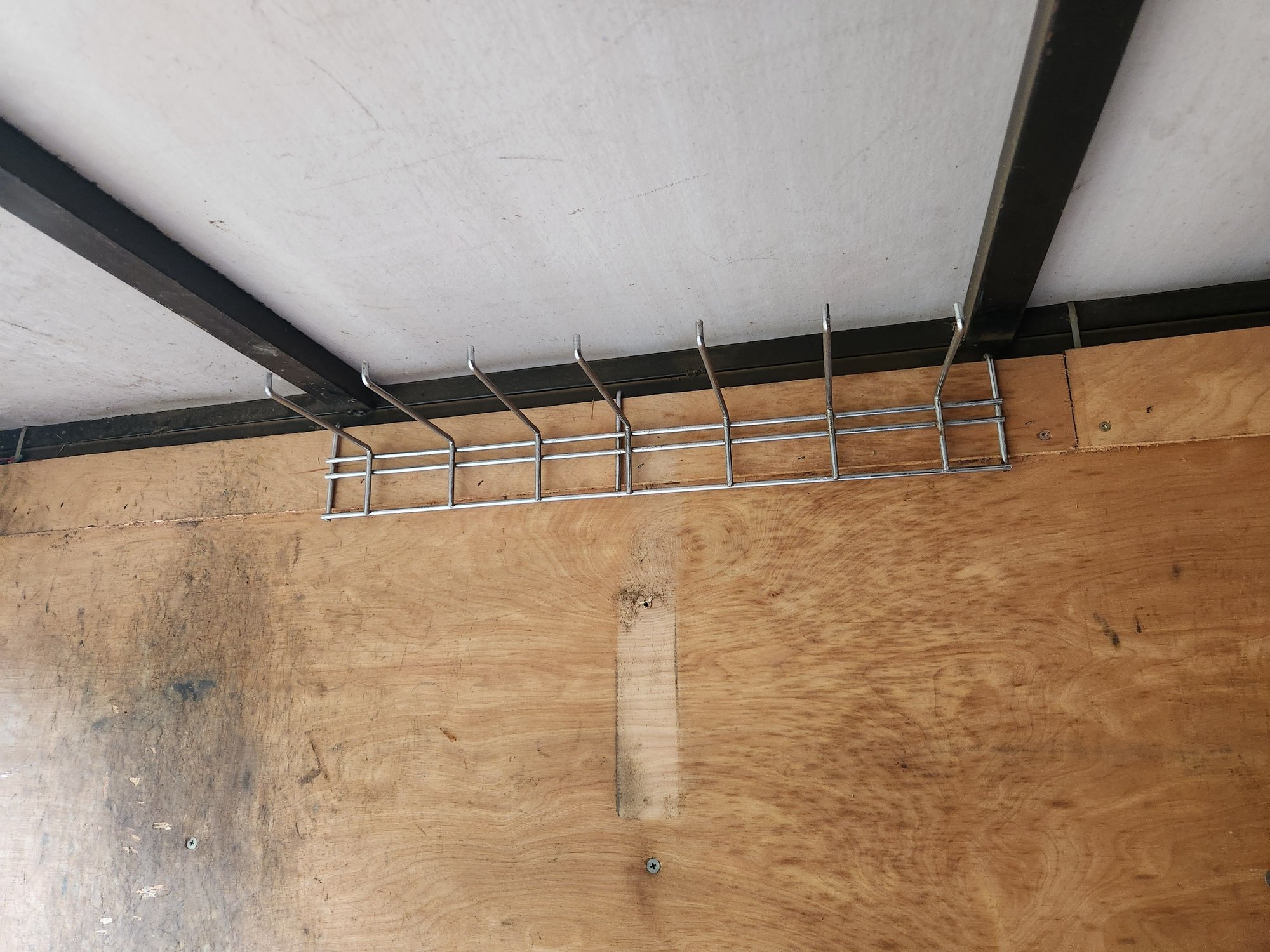

Forged handles out of hard steel tube. Heavy stuff. Had to get it red hot to beat it good and flat. Also build a chainsaw rack, holds around 4 saws. Few books to hang stuff with and all new running lights and brake light all around. New chains and wiring harness to junction box. I'll post a video in a little while but for now here's some pictures. New roof vent is already ordered.
