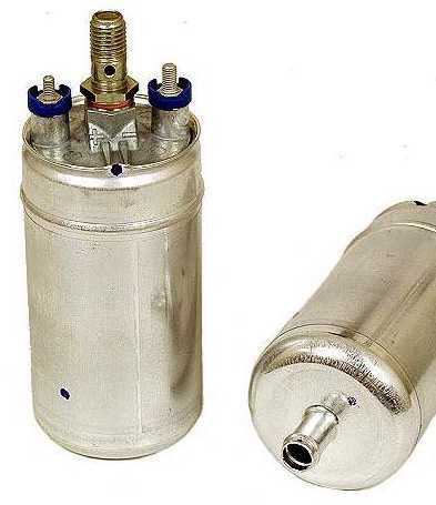

If you remove the OEM fuel pump and examine it like I did, I found "Bosch" mixed in with the labeling. Also, I operated an auto repair shop for 28 years and the brand the gave me the least amount of trouble, (make that no trouble at all in the form of comebacks), was Bosch. With that said, I can fully recommend the Bosch pump.

I would also recommend checking your pressure at the fuel bowl and not changing until you see an issue since they tend to be a high mileage part. Replacing just the pump from Bosch is a good saver over the Motorcraft option.
https://www.riffraffdiesel.com/bosch...ric-fuel-pump/
https://www.riffraffdiesel.com/fuel-...ssembly-99-03/

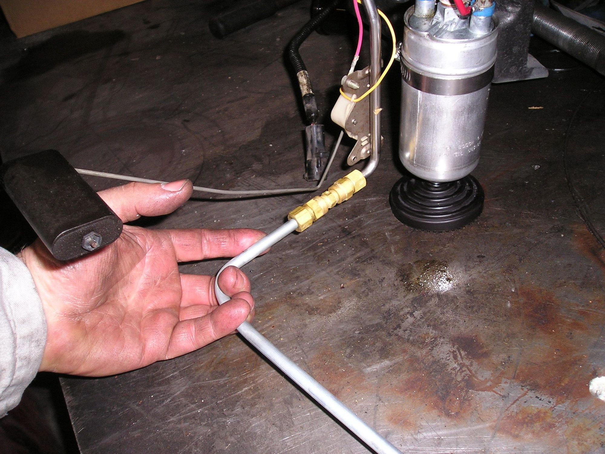

Some reading for you before you make a final decision. Let's just say Ford could have come up with a better idea.
https://www.ford-trucks.com/forums/4...fuel-pump.html
Here's another thread on the subject. Apologies for the bad link to Webshots. Back in 2005 FTE's policy was to not allow much bandwidth for hosting pictures, but Webshots allowed for posting remote links, so a LOT of our comments included links to Webshots for a better explanation and then they went under.
https://www.ford-trucks.com/forums/4...ifference.html
And I'll just end my comment with the statement that, due to the laws of nature, it's ALWAYS better to push a fluid than to try and pull it. With that in mind, I migrated my fuel pump to the end of the fuel pickup sometime back in 2005 or so and have never had to deal with fuel issues since then.
Again for the sake of staying consistent I’m going to argue against the need to move the pump out of its stock location and move into the tank. The factory fuel system with the simple pre-pump mods has been proven to work for 2+ decades and hundreds of thousands of miles without issue it’s easy to access it’s easy to maintain and easy to replace parts if needed.

The inlet screen of my fuel pump clogged up so badly that fuel pressure dropped to 20 psi just trying to accelerate EMPTY, not pulling a trailer or anything else. Severe power loss was very apparent and the truck only had 67,000 miles on it. I've had the current fuel pump in place for close to 16 years now and have never had to go back in for any reason. All because of the design flaw of having a non-serviceable screen built into the inlet side of the fuel pump that very easily gets clogged with debris.
Not trying to start any arguments here, but the fact of the matter is I found a flaw in the design of the fuel supply and applied a very good solution based on my experiences as an auto repair technician of 40+ years. If I ever needed to buy another 7.3 for any reason, this would be the first modification that I would do, then move onto the other stuff under the valve covers. It's that effective of a modification to the original design.

The common in tank mods get rid of the screen and put a filter between the tank and the pump where it is easy to access.
I myself prefer pulling and returning from a sump.
Not saying your idea isnt good, I just personally dislike having anything in that may need accessed the tank.

Thanks for all the advice! I appreciate the photos of the pickup foot. I imagine I need to plan to put a new one on since they apparently break off eventually. I ordered a FP gauge and will install the sensor on the post filter side. For my reference, correct me if I'm wrong, I am looking for 50psi there?
