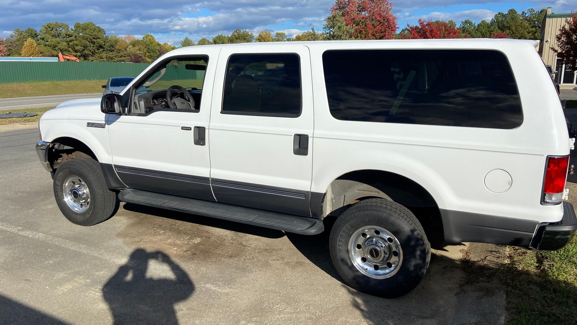

Just for a visual. Don’t have any before/after measurements.
Yes, it looks like it skipped leg day. Lol
