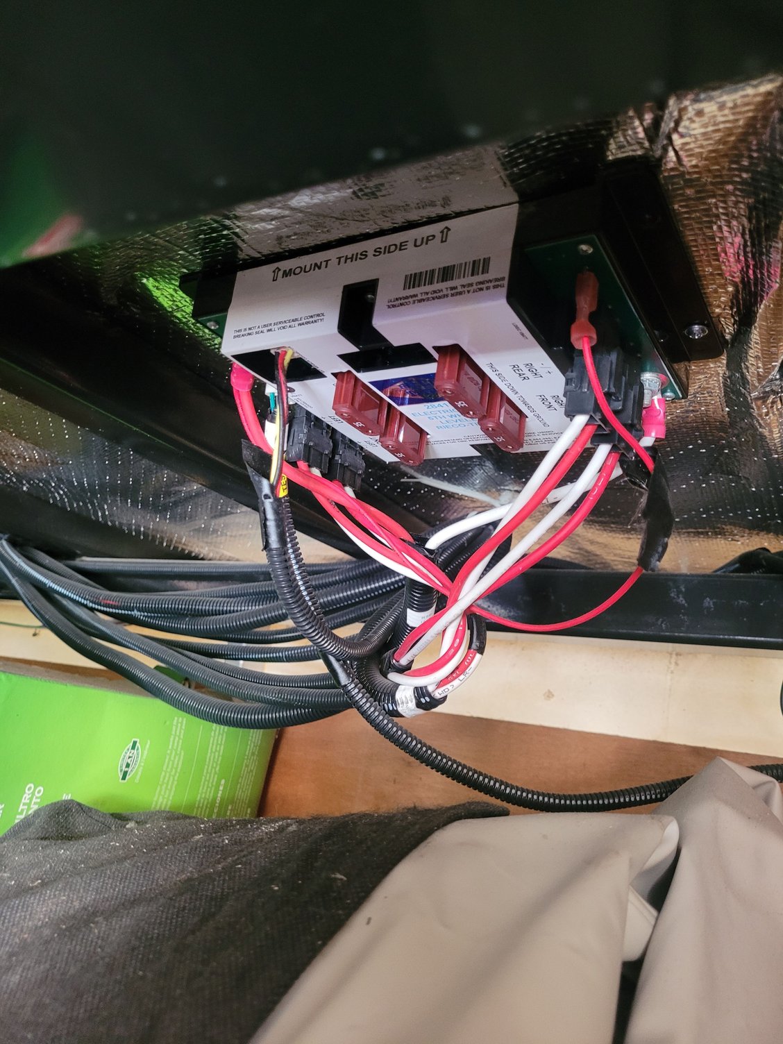

As I think about this, the switch panel is not the problem. When I push those buttons the red ligh comes on because there is no power on the other leg of the fuse. There is a panel under the basement with four 25 amp fuses that I think you are referring too. they all appeared good. but what I can do is disconnect and reconnect those wires for the fuse block. Will take a picture so you know what I am talking about.

here is the fuse block
Old Oct 9, 2022 | 09:07 AM
  #29
RV_Tech's Avatar
RV_Tech
Joined: Jan 2010
Posts: 10,060
Likes: 491
From: Bristol, TN.
Scott, are those fuses hot?
Old Oct 9, 2022 | 09:15 AM
  #30
senix's Avatar
senix
Joined: Aug 2008
Posts: 37,383
Likes: 1,867
From: Frederick, MD
I don't know. Checking to see if I have something to test with
