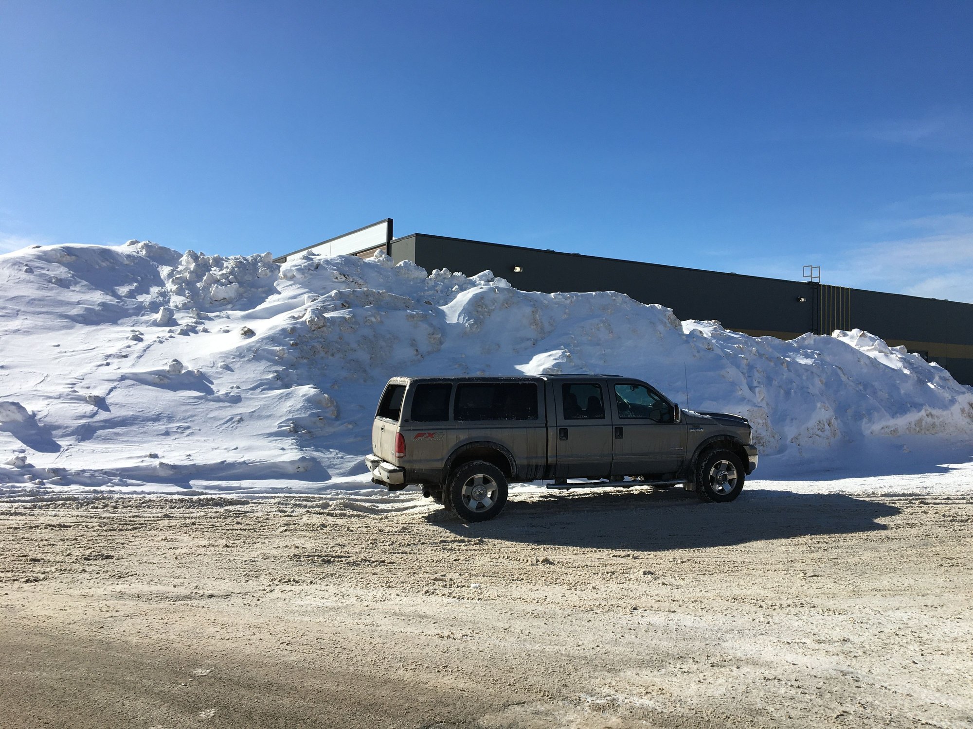

It’s been over a year since I tried the Toyo AT3, thought I’d update..
Running them on two trucks now. One set all last winter, and one since this past July. Just plowed with them this morning, and run them on a 2006 F250 since July, about 5k miles and no noticeable wear on them. Not noisy either.
No issues. Work great in the snow and cold. AT tires have come along way in the past 25 yrs.
I don’t think I’ll bother with dedicated snow tires anymore, on trucks anyway. I’ll just run these year round.

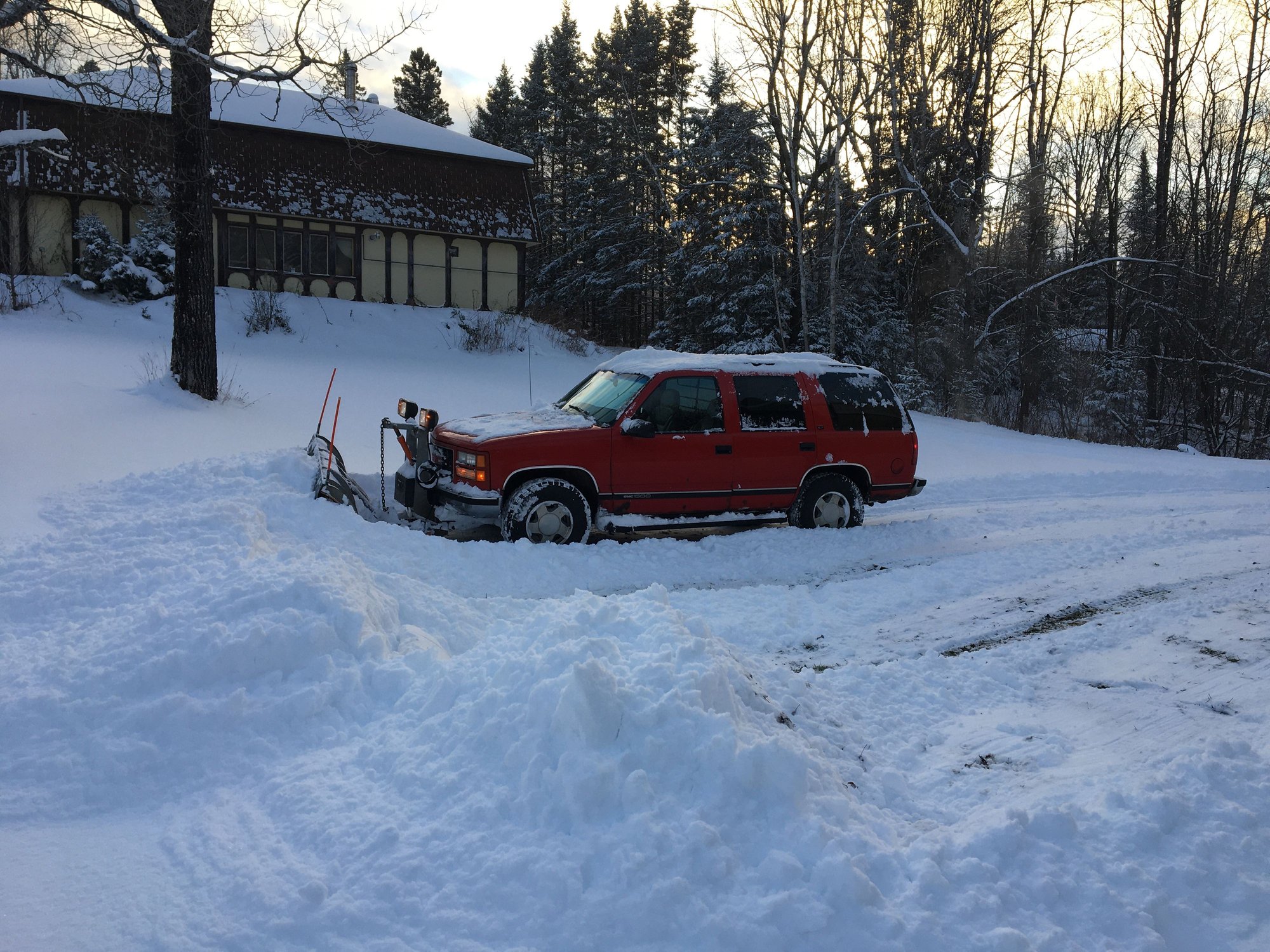

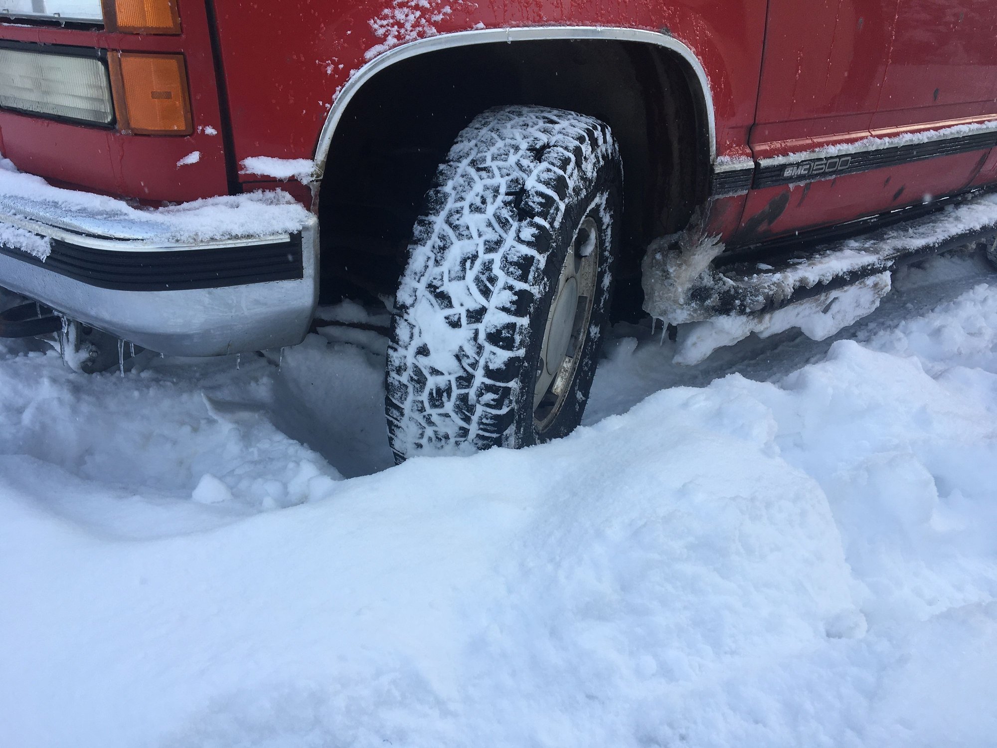

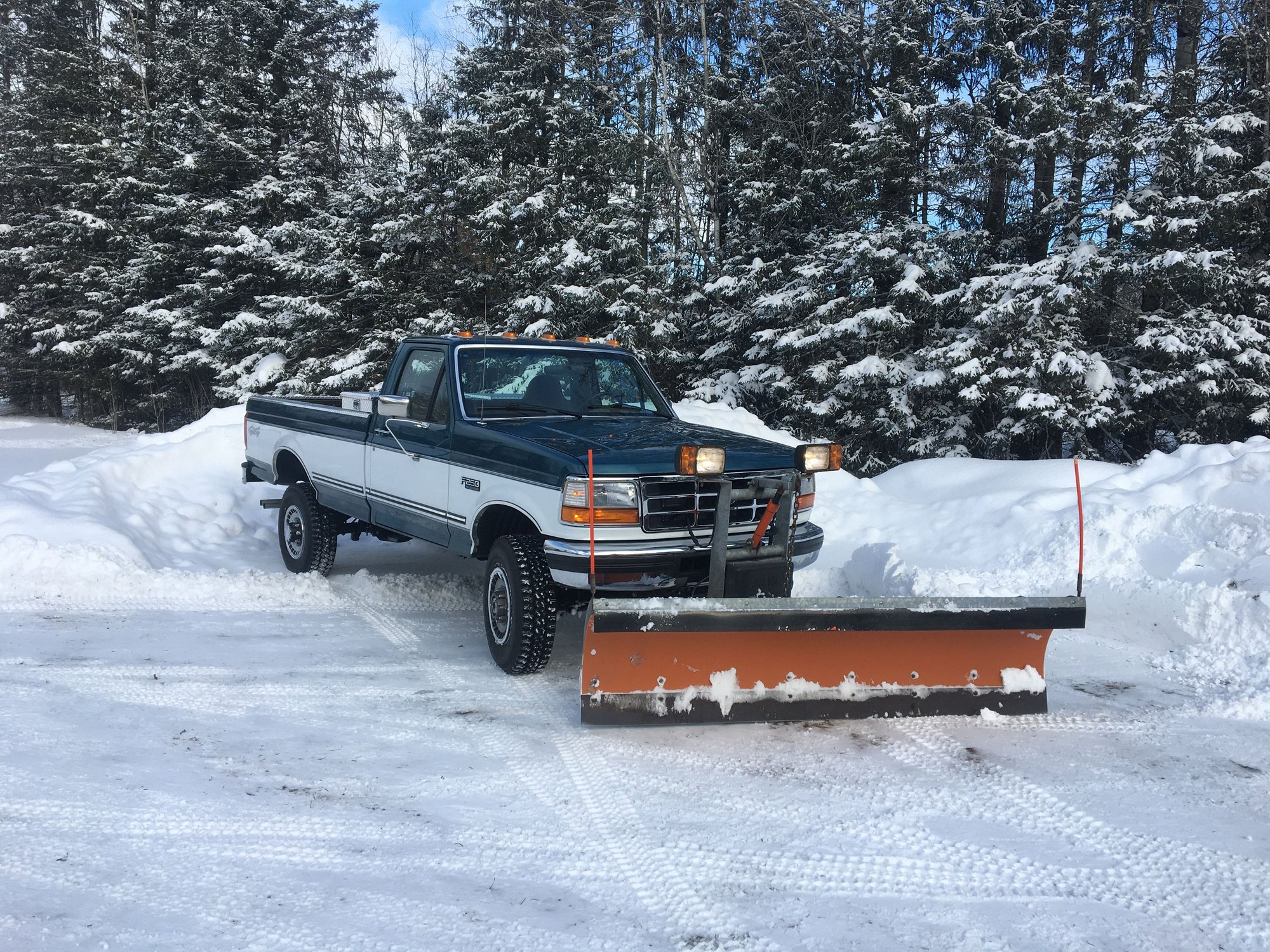

Pics.
I questioned whether they would work well plowing, but I couldn’t tell the difference.

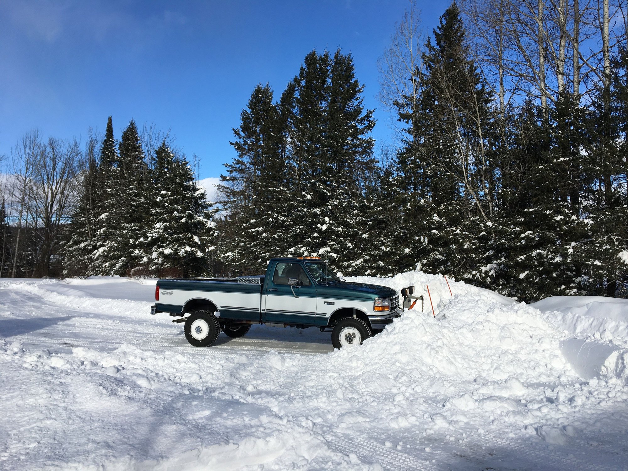

Just to add to this thread. I’ve also been running Toyo M55 on my ‘96. Those tires work really well too year round, they are a little rougher and slightly noisier than the AT3. But, that’s comparing them on a ‘96 250 to an ‘06 250. No issues with either one though.

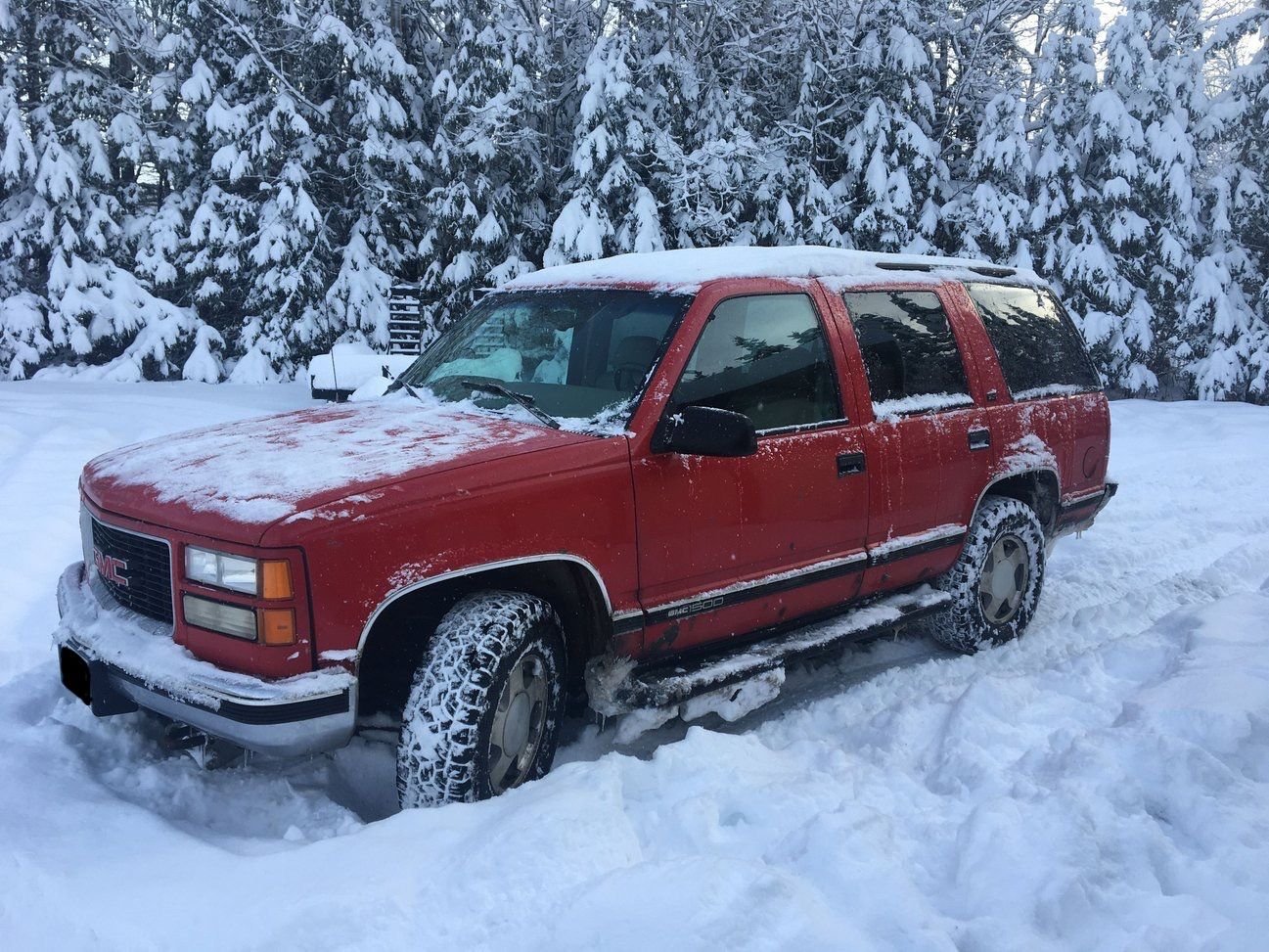

1997 GMC Yukon, Toyo AT3. again not many miles, probably around 3-4K miles on them, but wearing well, sits around a lot. It just sat for 8 months straight. No issues, got it going, runs down the highway nice and smooth.

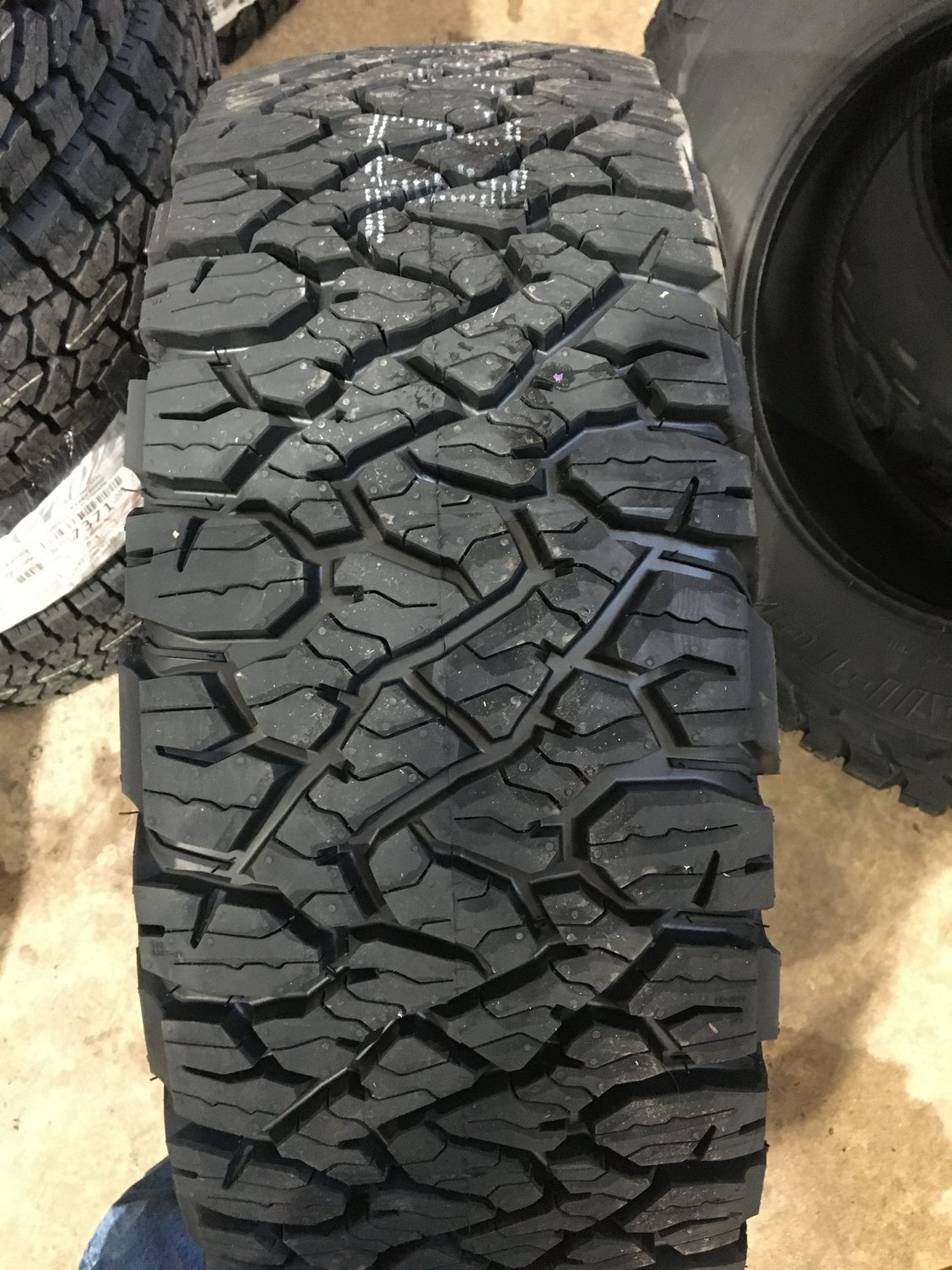

I was in a local shop today (different shop from where I got my tires) and got a look at the new BFG KO3’s. They look like another good option too, the shop owner said he’s been installing these, and the toyos. No complaints from anyone in the snow with them.
BFG KO3. They changed the tread pattern.

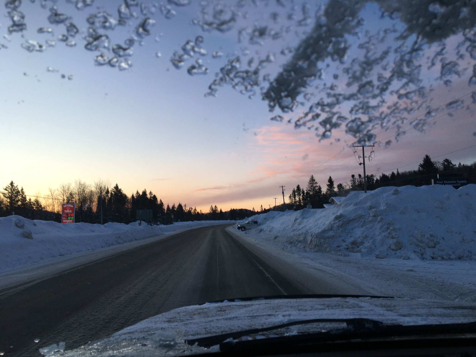

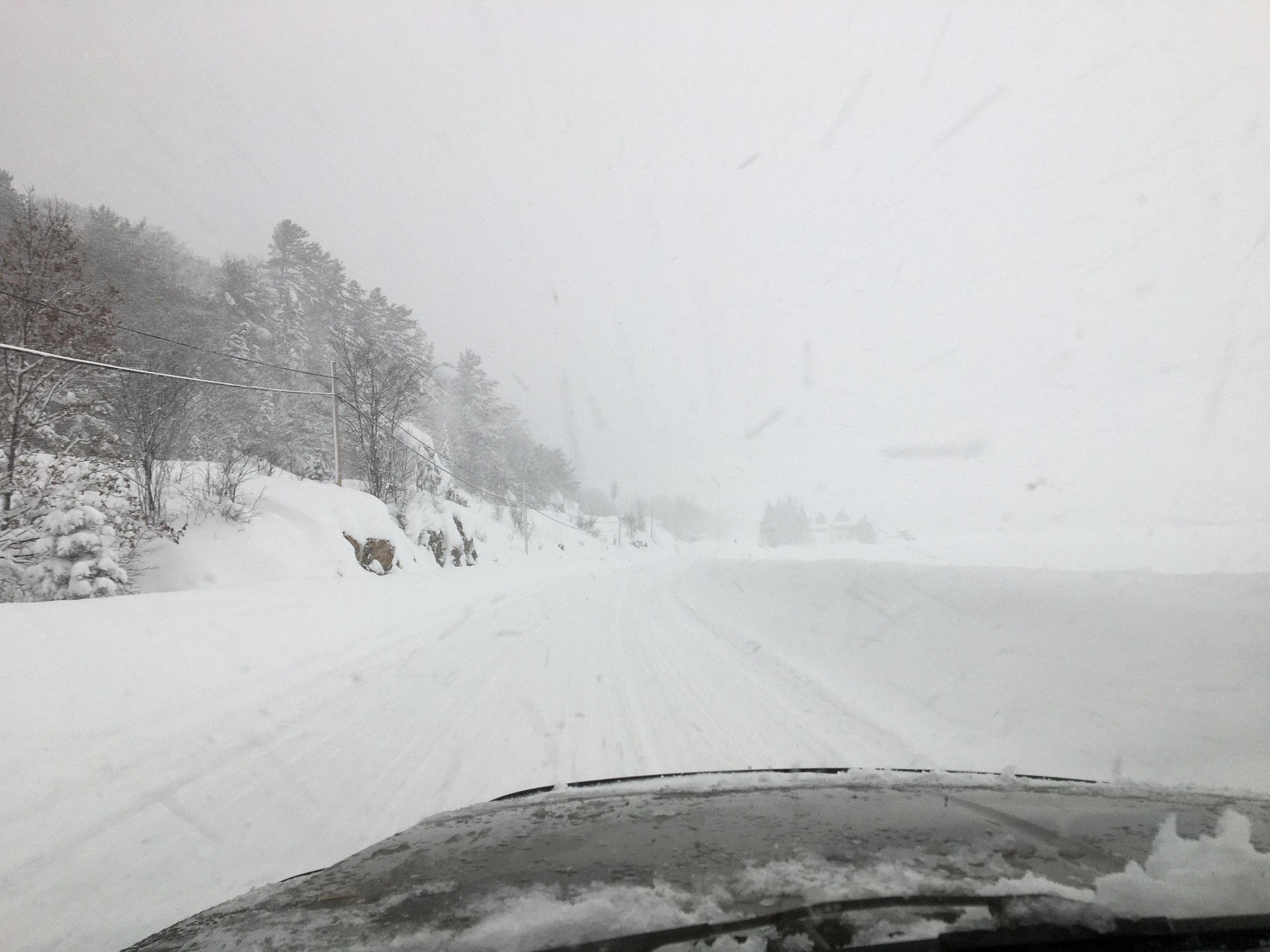

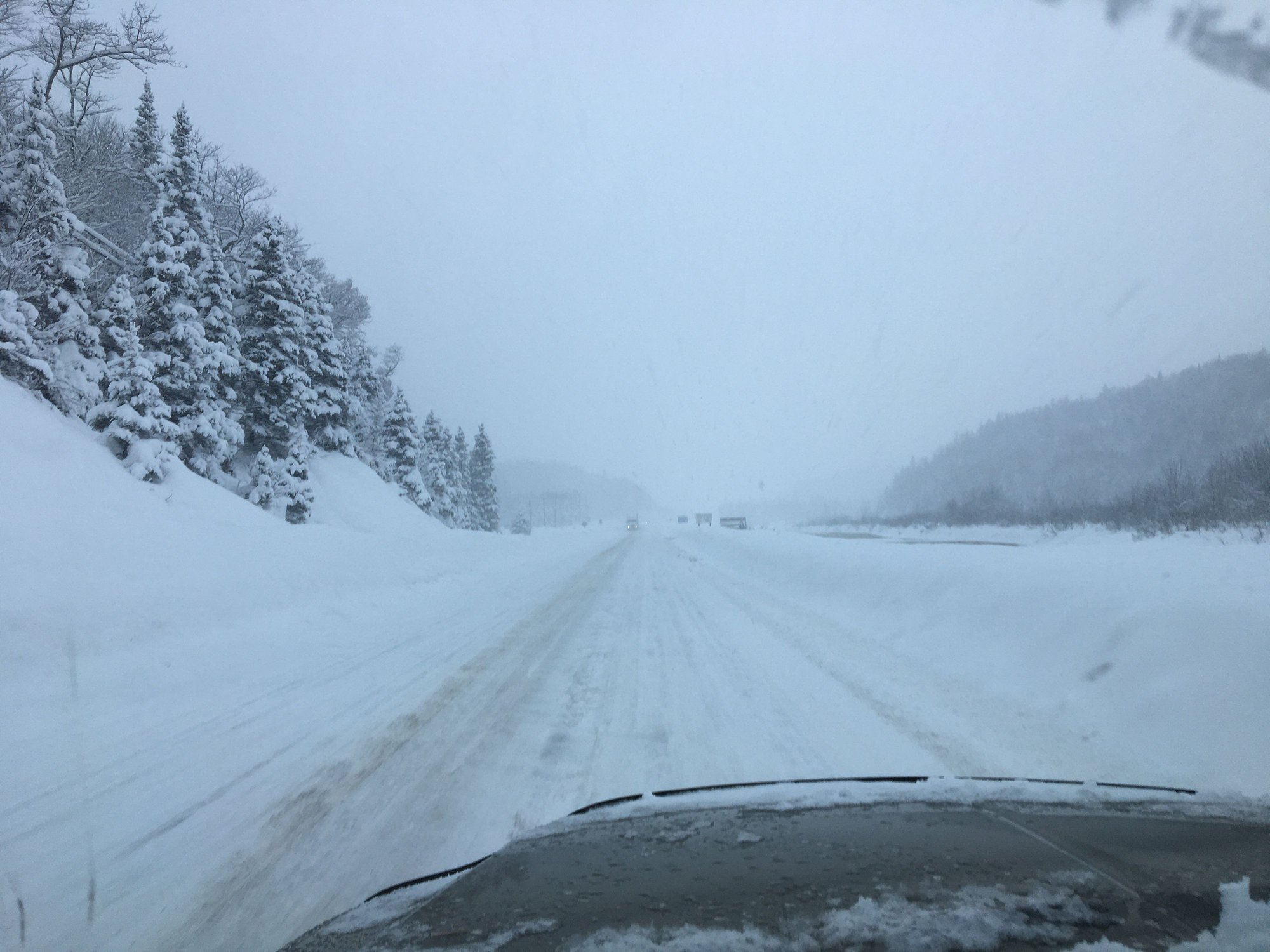

On another note…

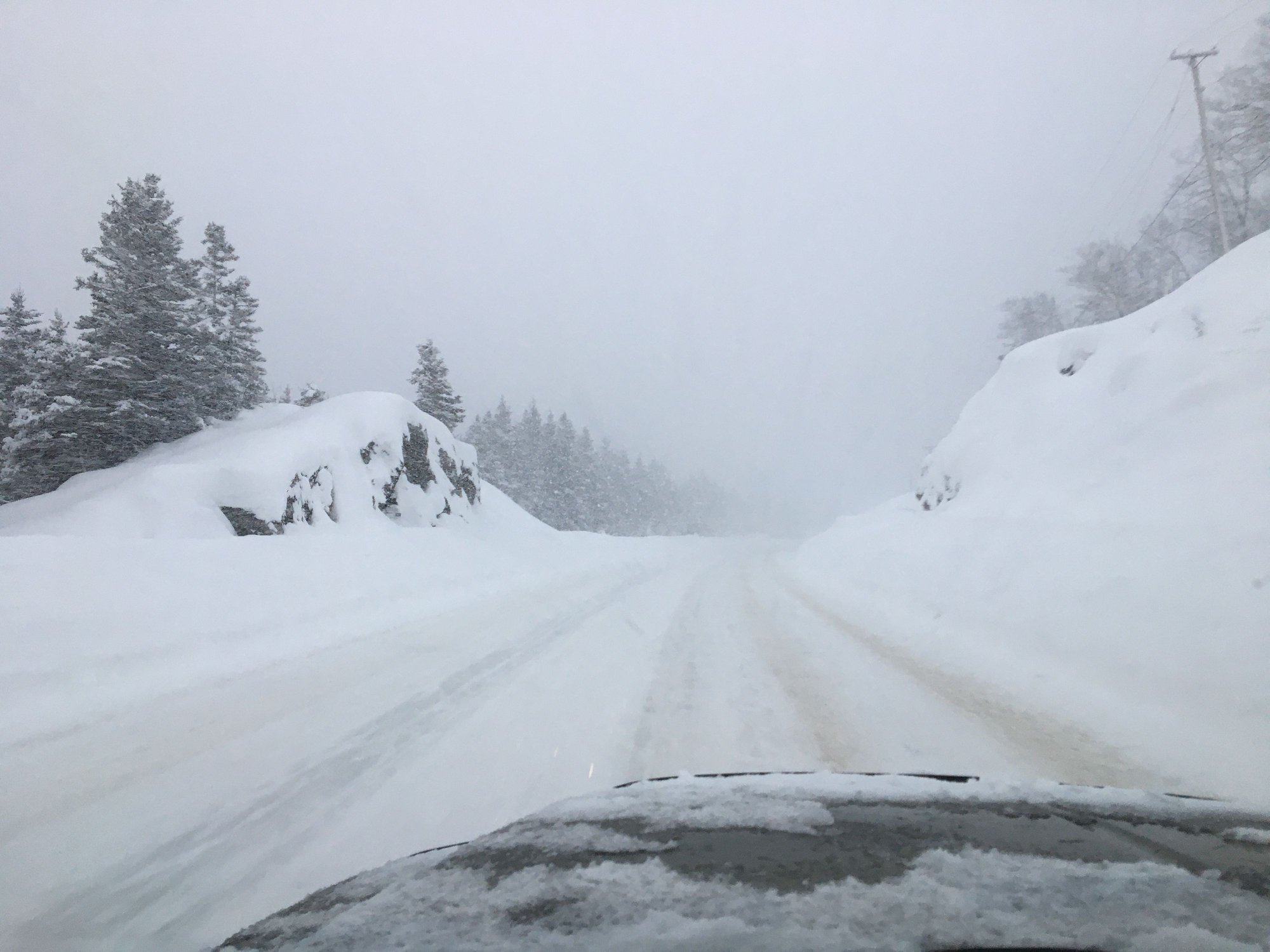

Snapped a few pics today going to town. This is what the Toyos are running on the highway. Still no complaints.

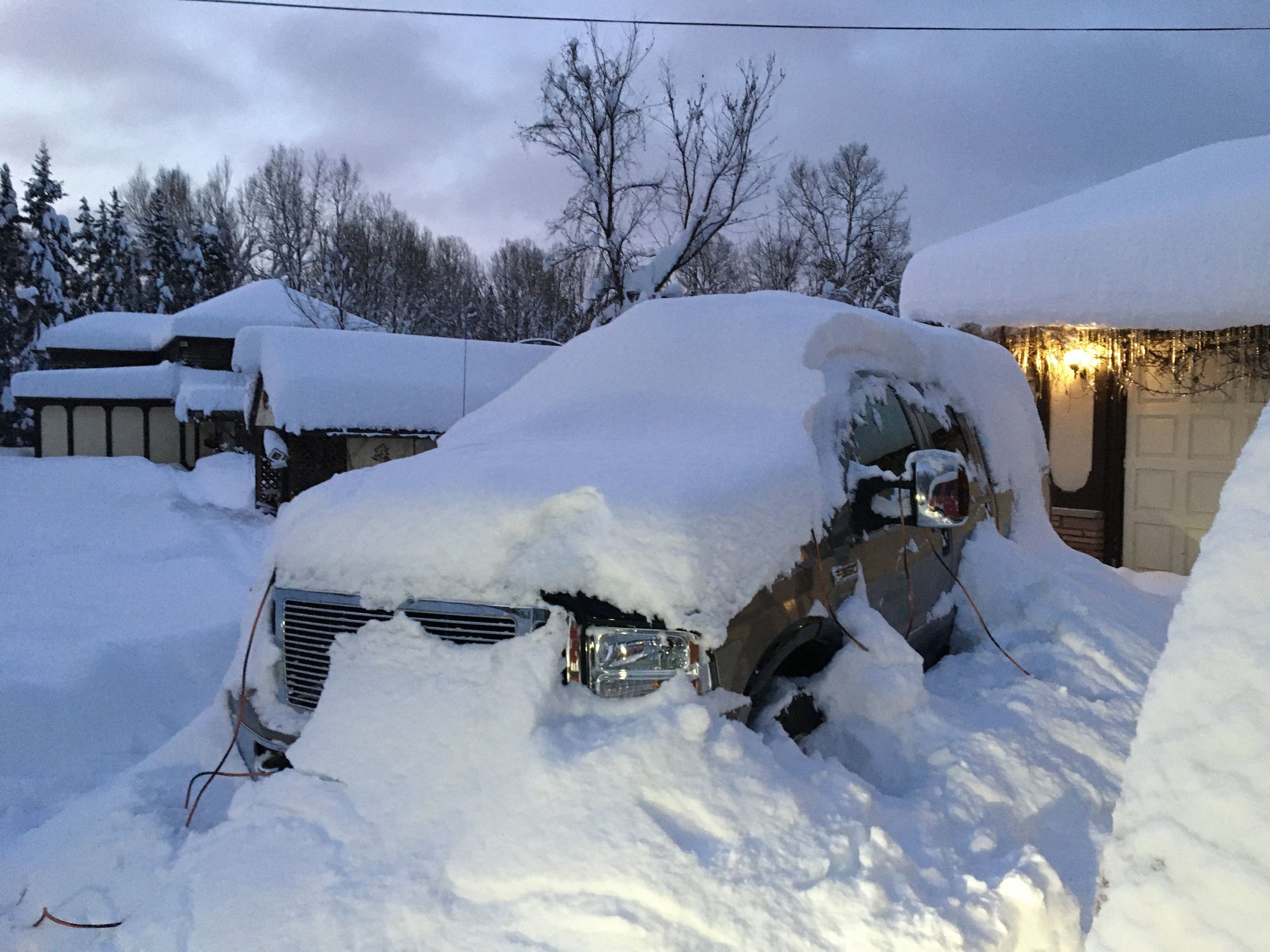

Ok, I’m going to call the Toyo AT3 experiment a win. No problem in the snow or cold. These are every bit as good as a snow tire.
About 5k miles more on the ‘96 250 and Yukon, and 10k ish on the ‘06 250. The ‘96 stayed parked last winer.
(EDIT: Almost 20k miles on the 2006 250 Toyo AT3 total.)
Lots of hauling and towing in the ‘06. Lots of trails and plowing in the Yukon. No issues.
We had so much snow here last winter, it just didn’t stop. Started snowing in Nov, and didn’t stop until April. It was a good snowy winter test for them.
Spent the night driving in one real miserable snow storm for about 12 hrs in December, towing about 6k in the ‘06. No issues. They worked very well. I was in 4x4 for lots of it, it just got too deep in some areas. Normally the drive would take 6 hrs.
No complaints with these tires. Question is now, how long will they last. So far, no noticeable wear. I’ll measure them next summer.
Snow banks make life interesting pulling out onto the highway.. good tires makes all the difference.
