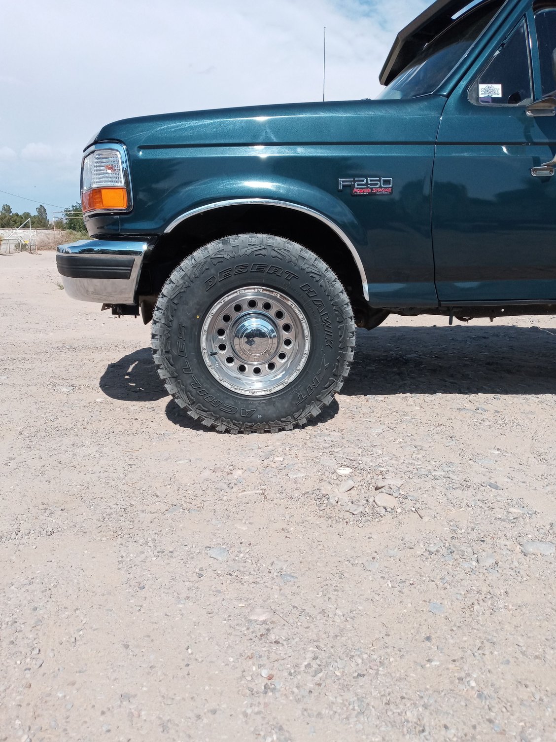

You can get away with the rear ones, you will have to install at least 4 A corn nuts on the rears and you can force the hub cap on them since those after market ones are press fit, fronts are not doable, those shorter caps have four clips that get held on by 4 notches the factory wheels have.
I have a SRW and this is what mine look like with junk yard find stone cruchers.
