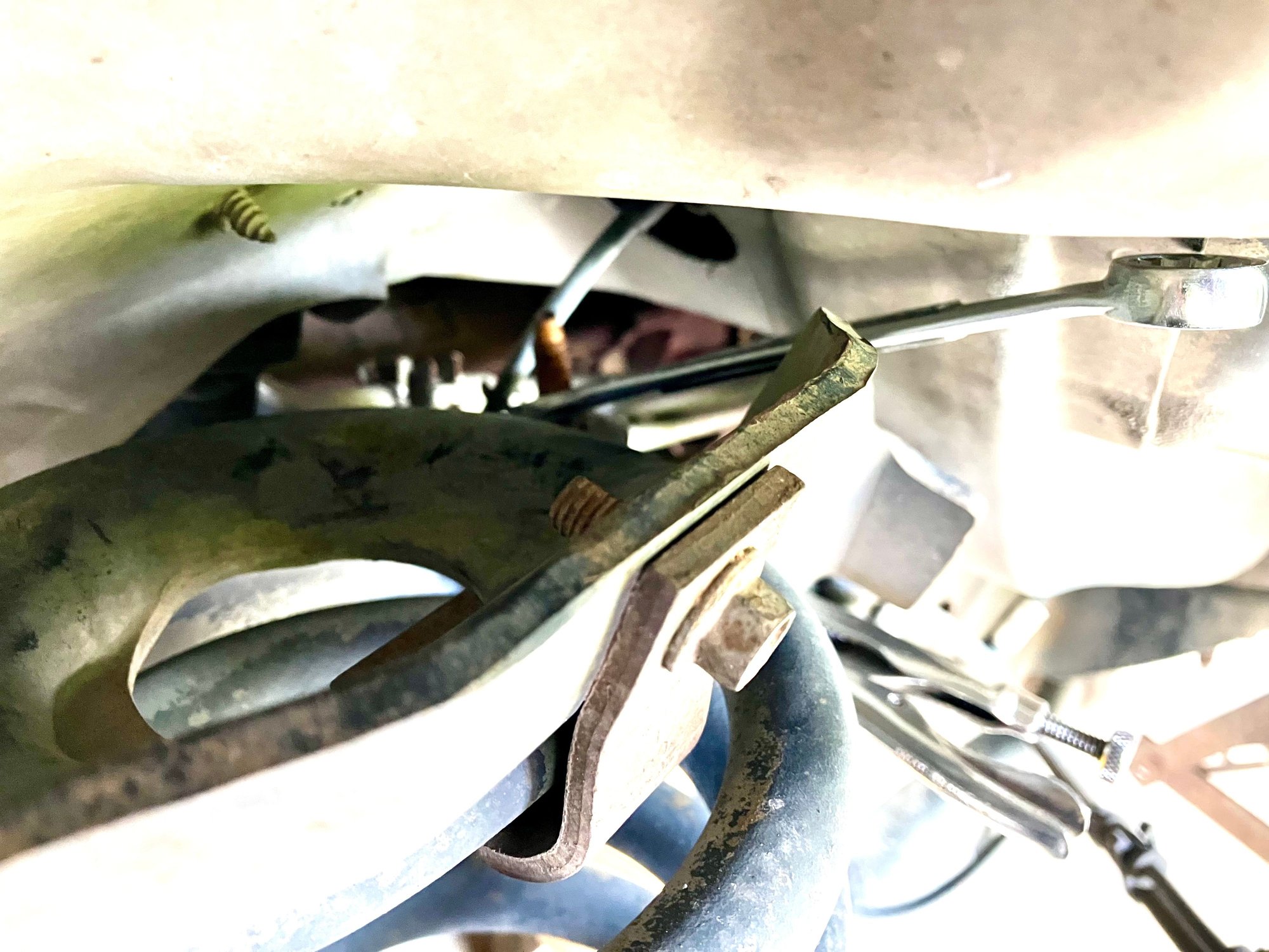

The access hole was somewhat useful but because of slow going, I looked for other methods. I ended up doing most of the work from the wheel well. My left hand is just skinny enough to get a 14mm wrench on the nut like this -
Note the 6” vice grips holding the ring under the ridiculously slim holding nut on this Monroe.

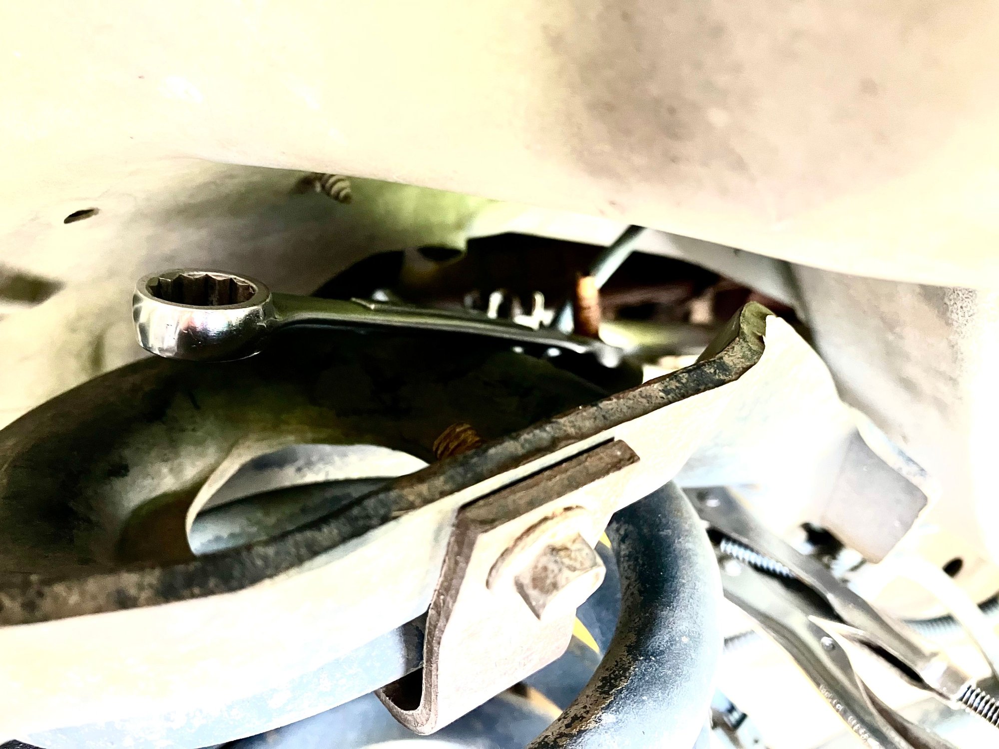

I got about 90* of swing which made for quicker work than through the access post with the shift cable in the way -
The angle is such that I couldn’t get a Gearwrench flexible head combo ratchet on the nut from the start so I used an open wrench for a few turns. As the nut gets higher, the ratchet slips past the nut. At that point I removed the lower shock attachment to get the nut back on the big washer and went back to the open wrench. I suppose I could have cut the stem at that point but I hate using a saw.
Like that wasn’t torture enough, there’s an overlap of the body attachment subframe that kept catching my fingernail while swinging the combo wrench.
