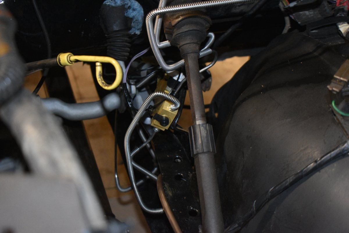

Thanks for everyone's input. I opened up a rear bleeder with no luck, then did the same with a front one, all while using the power bleeder tool. No luck. At this point I decided to just get a new proportioning valve. They are $58 at JBG. I decided to buy the "valve plunger tool" too which is supposed to help keep the valve centered when bleeding. In hindsight I don't think I needed it with a entire new unit. Here's some pics:
I had enough of draining and flushing the brake lines so I skipped that when replacing the valve. Lost a good amount of brake fluid onto the garage floor but that's OK. Got the valve in there fine, it was a direct replacement. It came with an adapter fitting that I needed and a plug, but I didn't need the plug because I have 4x4. It came with a new type of switch that I had to splice into the existing wiring. The existing wiring had two wires, whereas this new switch used one wire.
Anyways, I got it all hooked up and fittings connected, then I bled the entire system per usual with the power bleeder. Everything looked good with no leaks and no air so I turned the key into ignition and the brake light was still on in the dash. But all I had to do was press the brake pedal down once and the brake light went off. So that's good... I saw the brake light which means the wiring was connected properly and it went off as it should when I pressed the brake. Back in business!
So all that to say, if you try all that I did in the first post and still have a brake warning light, I'd probably just replace the valve at that point.
