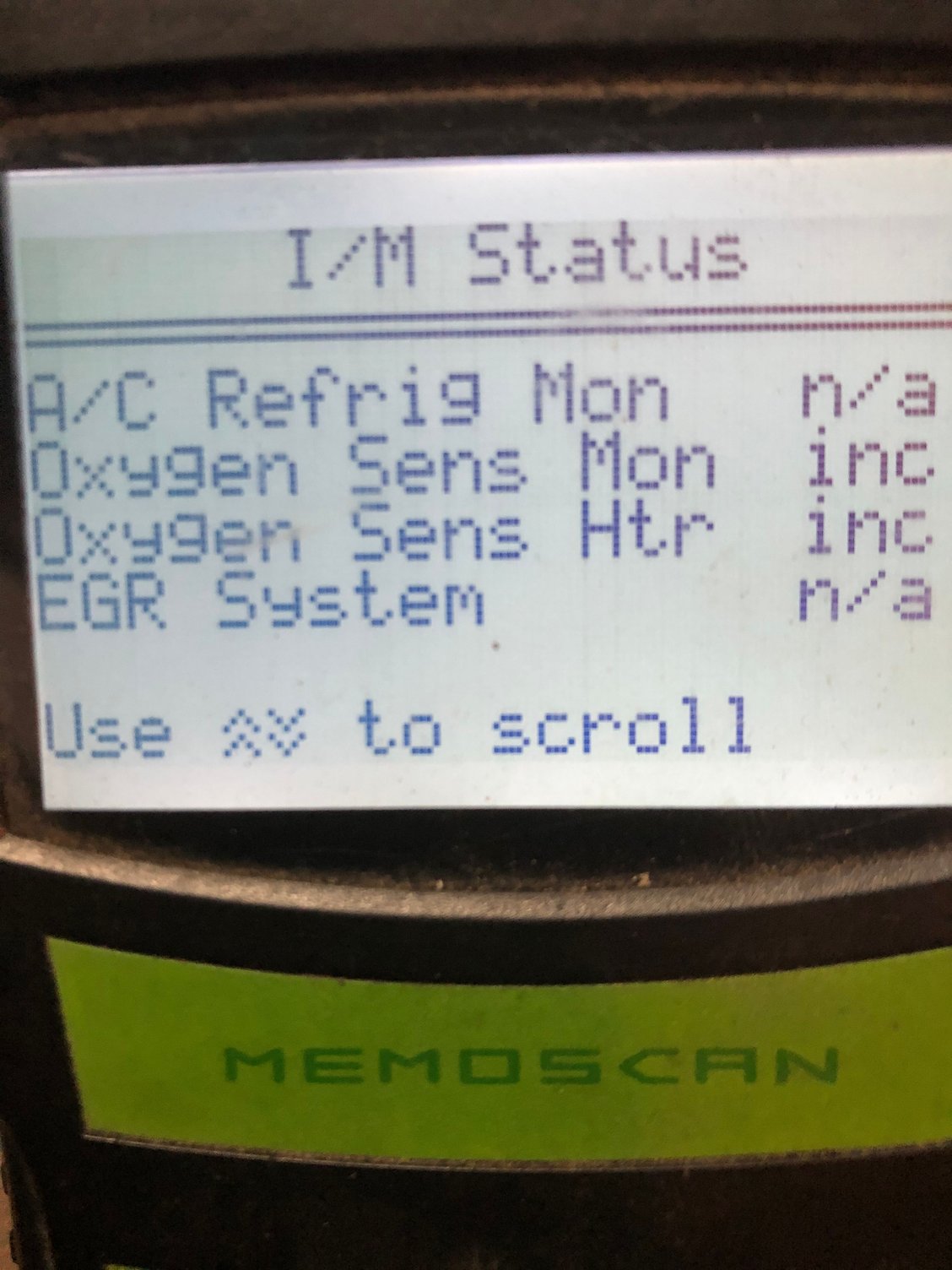

I wanted to add a couple pictures of what my scanner says after I disconnected the battery and connected a jumper between positive and negative, cleared DTCs (none in system but did it anyway), which should have reset the I/M. I am starting to think the PCM is locked up somehow.

I'm thinking you've mis-identified it as OBDII when it is not.
If there's no downstream (post-cat) O2 sensor and no EGR, it's OBD1.
OBD II compliant federally.
Mutually exclusive. OBD1 was ""Federal" or "US EPA", OBDII explicitly said "California" and "OBDII".

Okay. Let us say it is OBD I. It does have an EGR system though. I have used this scanner for years to determine if my system was ready for inspection, pull codes (Almost always a misfiring COP), and it has always told me that the readiness was complete and that included the O2 sensors. Any ideas what else I can check before I just replace the computer?

It's the calibration (programming), not just the hardware... Download and read the OBDII Theory Manual from www.motorcraftservice.com. It explains the exceptions for certain vehicles that are rated over 8500 GVW including the F-Super Duty line.
Have you used it on THIS truck for that purpose?
Your tool displays "n/a" next to EGR... Are you sure it has EGR? If it's an OBDII (California) calibration, it will have BOTH EGR and a downstream O2 sensor.
Most decent scan tools should be able to identify whether OBD1 or OBDII.
I have used this scanner on this truck for many years. It has always done very well reading codes and readiness. The screen shots that I took are just the I/M readiness and I do not believe there is an actual monitor so to speak for the EGR system on this year model. In other words it definitely has an EGR system but nothing really gets tested in it as far as I can tell.
