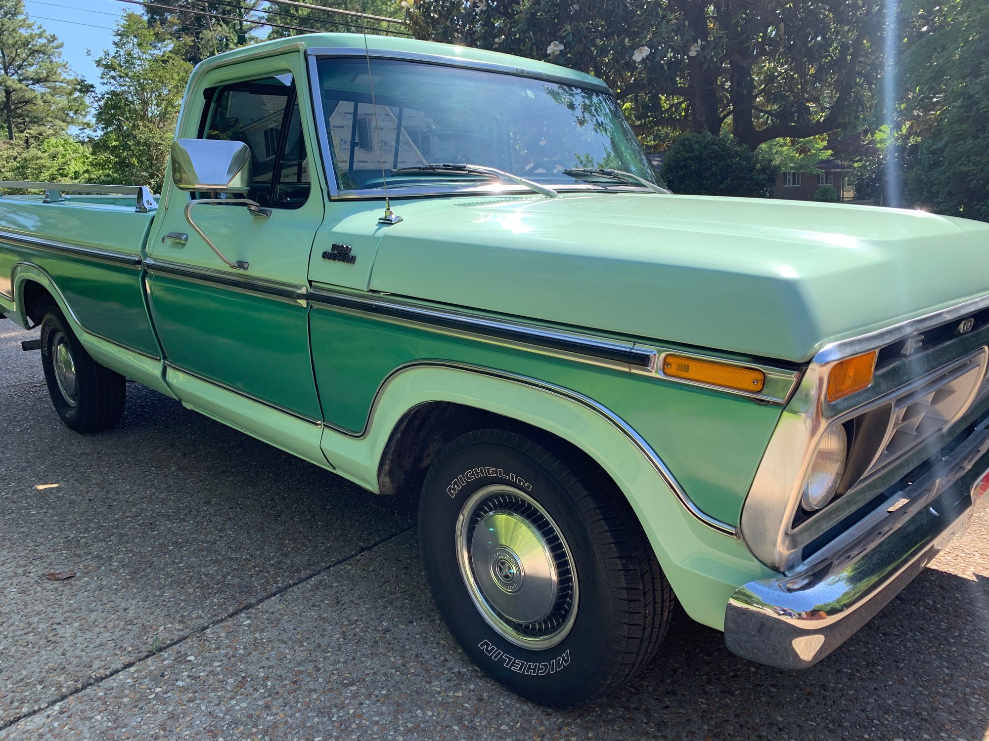

The truck.

The green you’re using looks really nice. But I can see how it’d be a little out of place if all the rest of your original stuff looks as good as the jade panel and carpet in the previous picture.
Maybe instead of matching the new panel to the interior, match the rest of the interior to the panel!

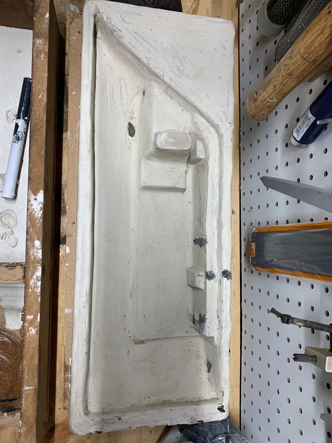

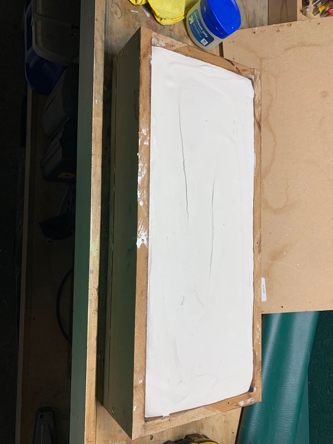

I am moving into the armrest phase of the project. I plan to make the armrests using molds from factory originals. Learning to cast using silicon was not cost practical so I am using plaster to fine tune fit.
Pics of first rev of molds below.
Mold box

First rev mold

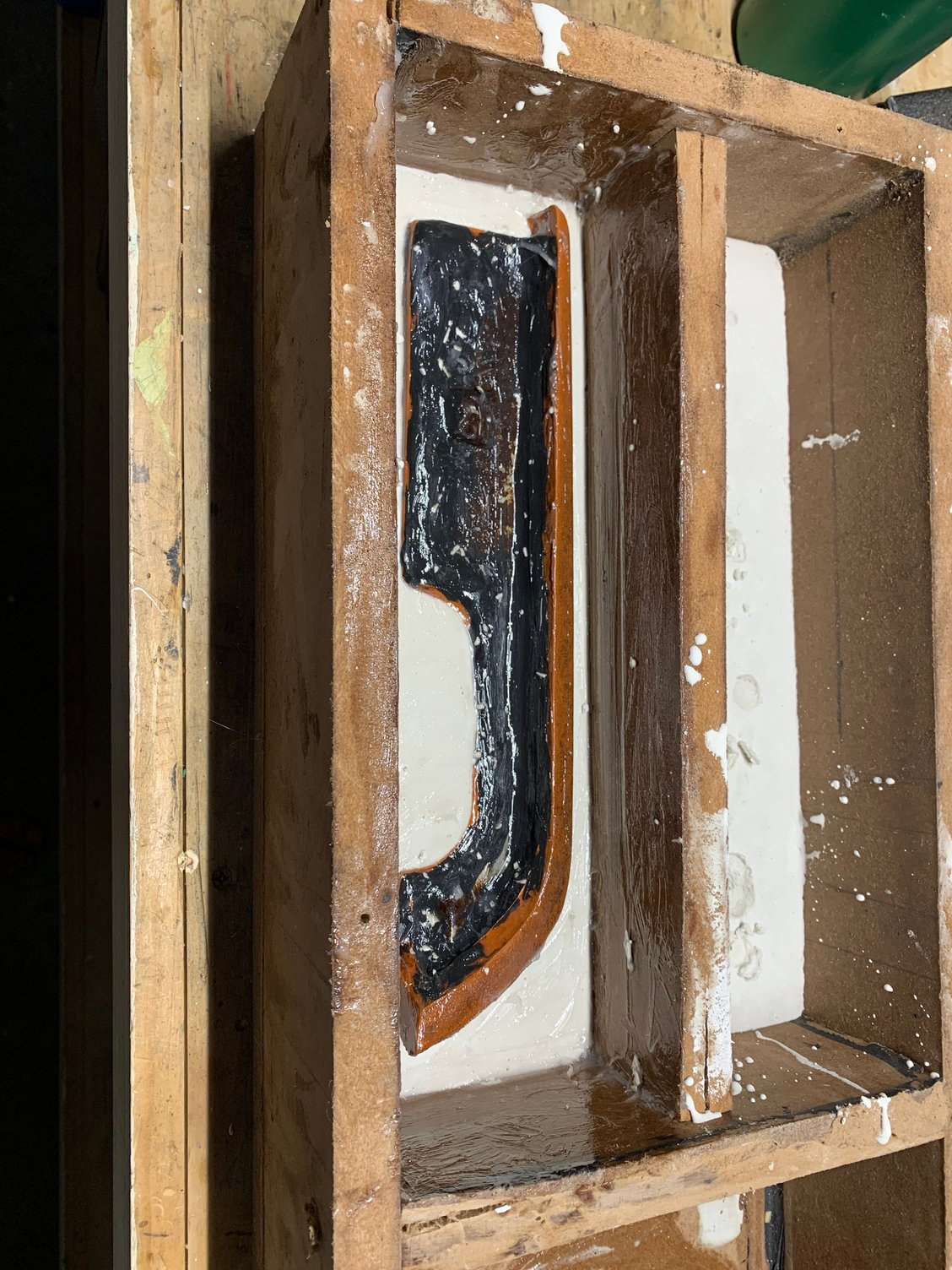

Lots of learning. Don’t cast plaster into a plaster mold.
The armrest mold never released from the plaster. Using a foam cast next time.
I will be casting a rigid foam into the next plaster mold I pull together. Slow progress as I figure this out but here is a picture of where things currently stand.

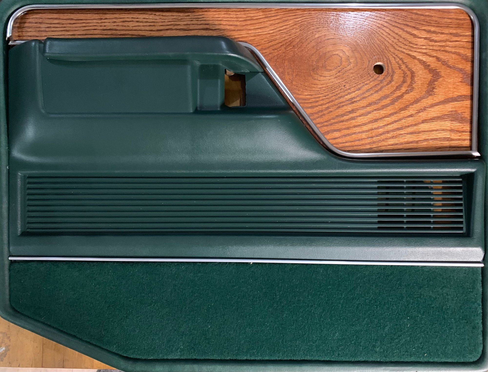

Final draft. Loads of lessons learned. Door panels are tough to do properly. Going to let this sit and see how it works out.
Jade door panels are hard to find so I improvised.

Looks realty nice. Is the bright trim maybe mylar?

Vinyl wrapped mdf.
