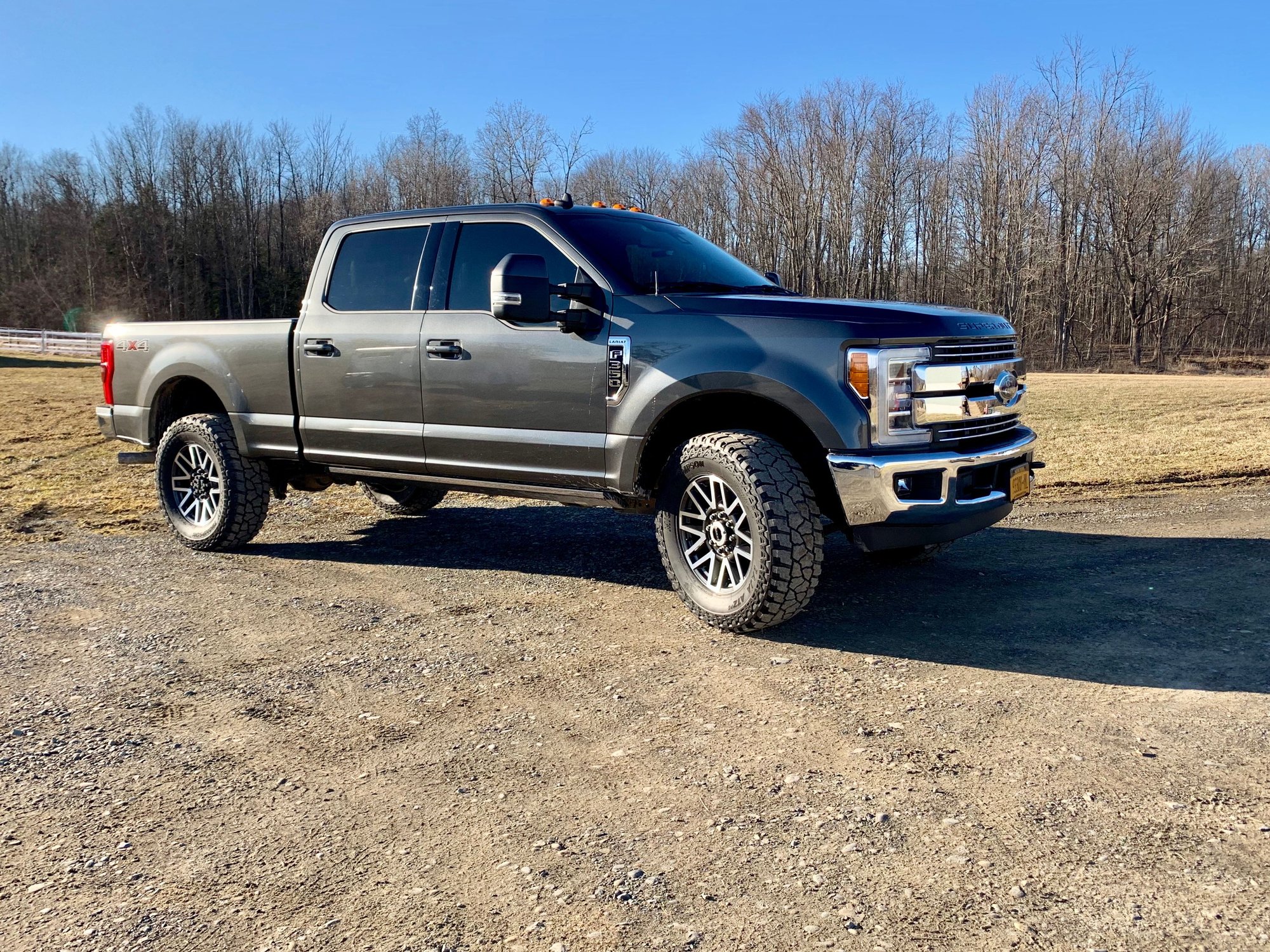

I’m on my second set of Mickey Thompson ATZ/Baja boss a/t’s… I think they’ve been aggressive enough, granted in 37x12.5. Very happy with on road performance and off.
first pic is of prior generation ATZ p3’s. Second pic is of the Baja Boss A/T that replaced the p3’s in the lineup.
