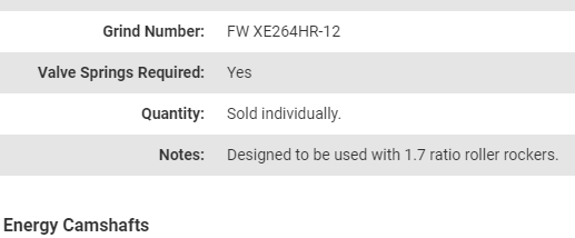

I would check PTV, because you have no idea what any PO, had done to truck, and Speedway motors has them $60 cheaper than anyone else. That cam and those heads should liven things up in it, my Pro Comps woke up mine, a lot, even with stock cam.

At .544 lift, I would make an edumacated guesstimate that you're going to be fine, but I absolutely won't say I guarantee that.

That cam only produces 0.512" lift with 1.6 rockers. I have used the sister cam to this one in a rebuilt 5.0 with no issues, but add larger valves with stock pistons and who knows... better to measure than gamble. The first point of contact is usually between the intake valve and the rim of the piston dish.

Huh, Summit is advertising that cam at .544" valve lift. But the point still stands, that it's something I'd still check.

On Summitt, bottom of page check note

Look at the actual cam specs, the cam lobe lift multiplied by the rocker ratio equals valve lift.

Yeah, I missed that. I'm aware of how cam lobe lift and rocker arm ratio works.
The point still stands regardless, whether the cam and rockers are providing .512" or .544" of lift. I don't know for a fact that .512" will definitely clear, and that .544" wouldn't, without checking. I suspect they would both clear but that's not something I would stake any kind of reputation on.
