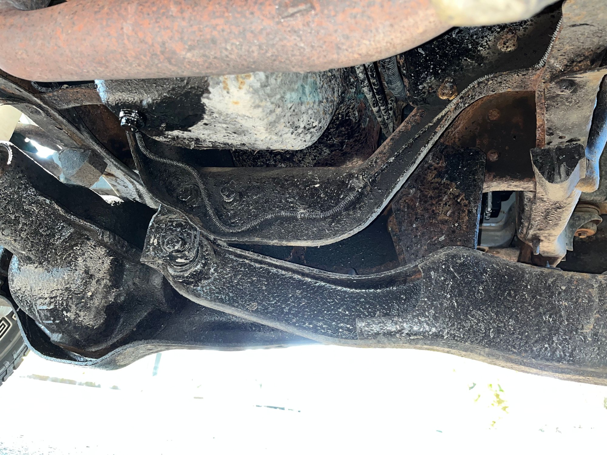

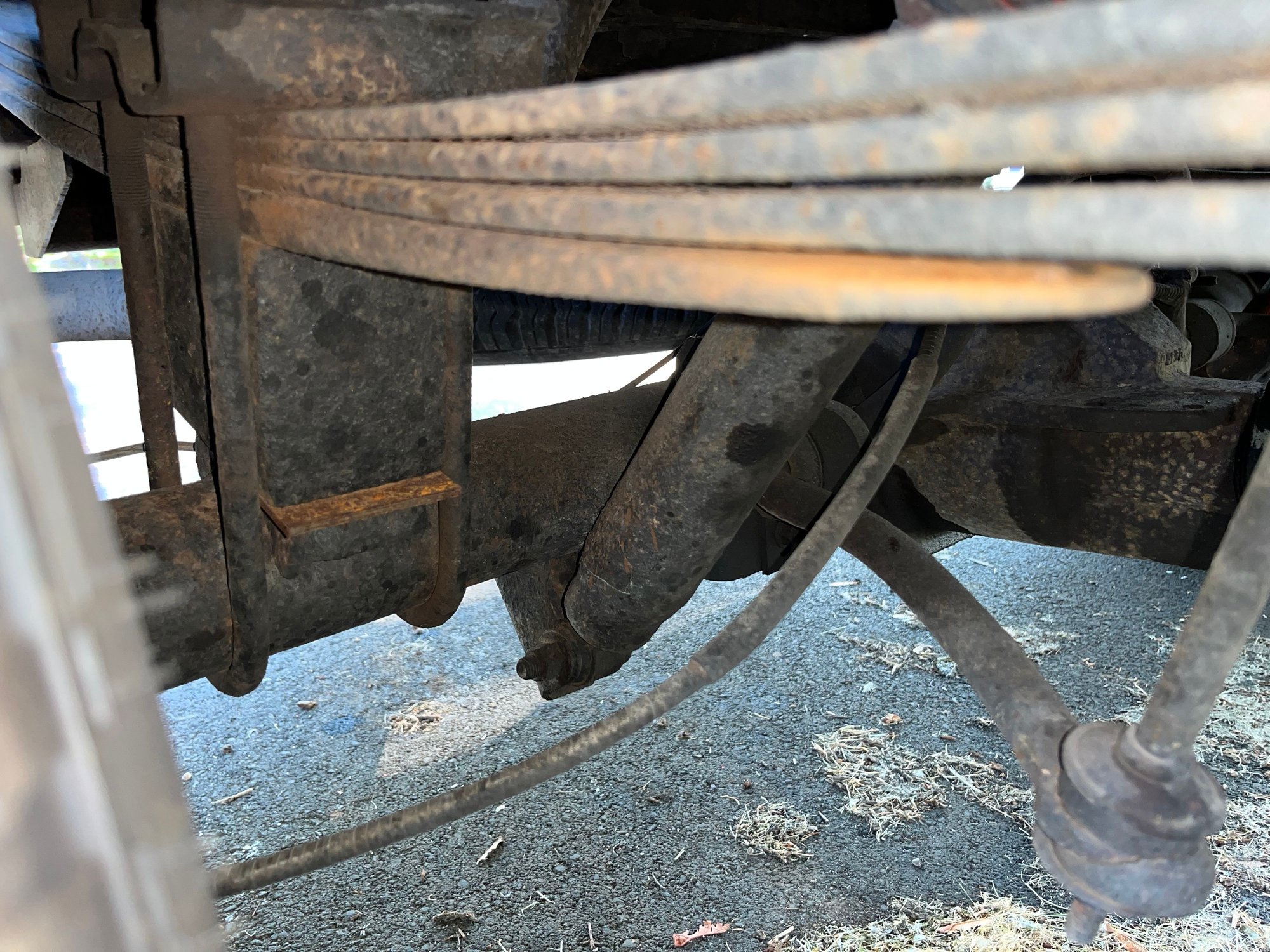

yeah, there are lift blocks in the back. I attached some pictures…. There’s no branding or part numbers that I can make out since everything is covered by the undercoating.

Hopefully this helps. The vertical height difference between where the beam pivot is now (bottom hole) vs stock (top hole) will tell you which size brackets you're currently running.
What is the distance between the dotted lines (dimension "X")?
Looks like 2.5" brackets to me. But measure to be sure.

Those are 2.5" brackets. They look very much like the ones that came with my Rough Country lift for my '92 a number of years back.

Ah yeah… looks like it is a 2.5” kit. I guess if I want to have some rake I might just have to go back to stock parts.
Though I do have the original rear spring spacers… I could just throw those in and raise the back up a little more.
