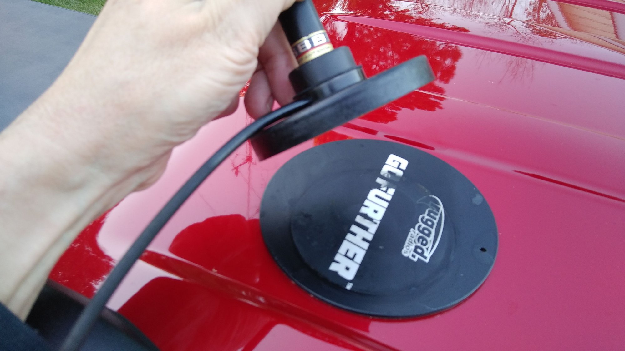

Rugged Radios has this adhesive backed steel plate that allows any kind of mag mount to be installed on an aluminum bodied truck. The diameter is too large to be placed between some of the ridges on the roof, but it can be made to work. About $20 when I got mine.
No holes. No corrosion. Easy stow at the car wash. A tree limb has already raked the antenna off the truck without damage to truck or antenna. That's why I like mag mounts.
no worry mag mount on an aluminum truck
