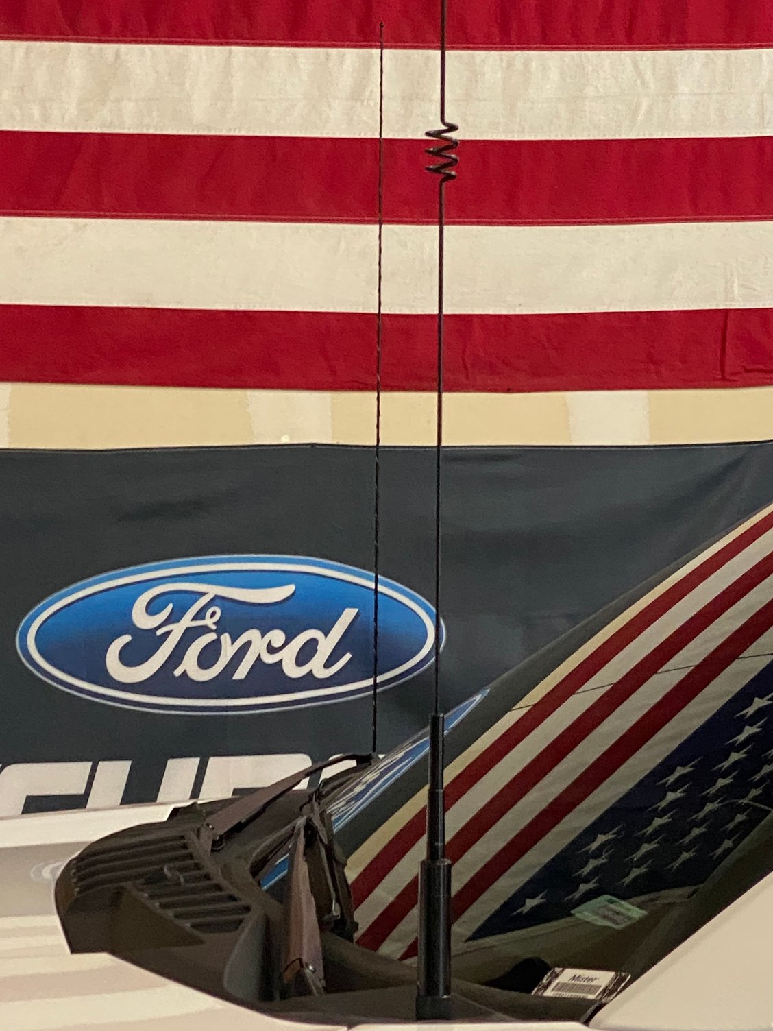

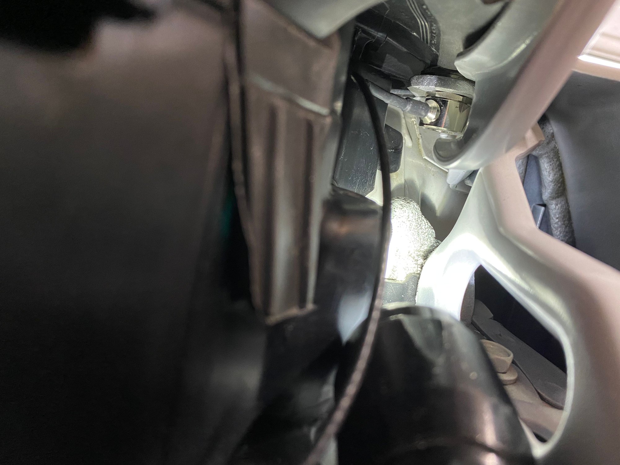

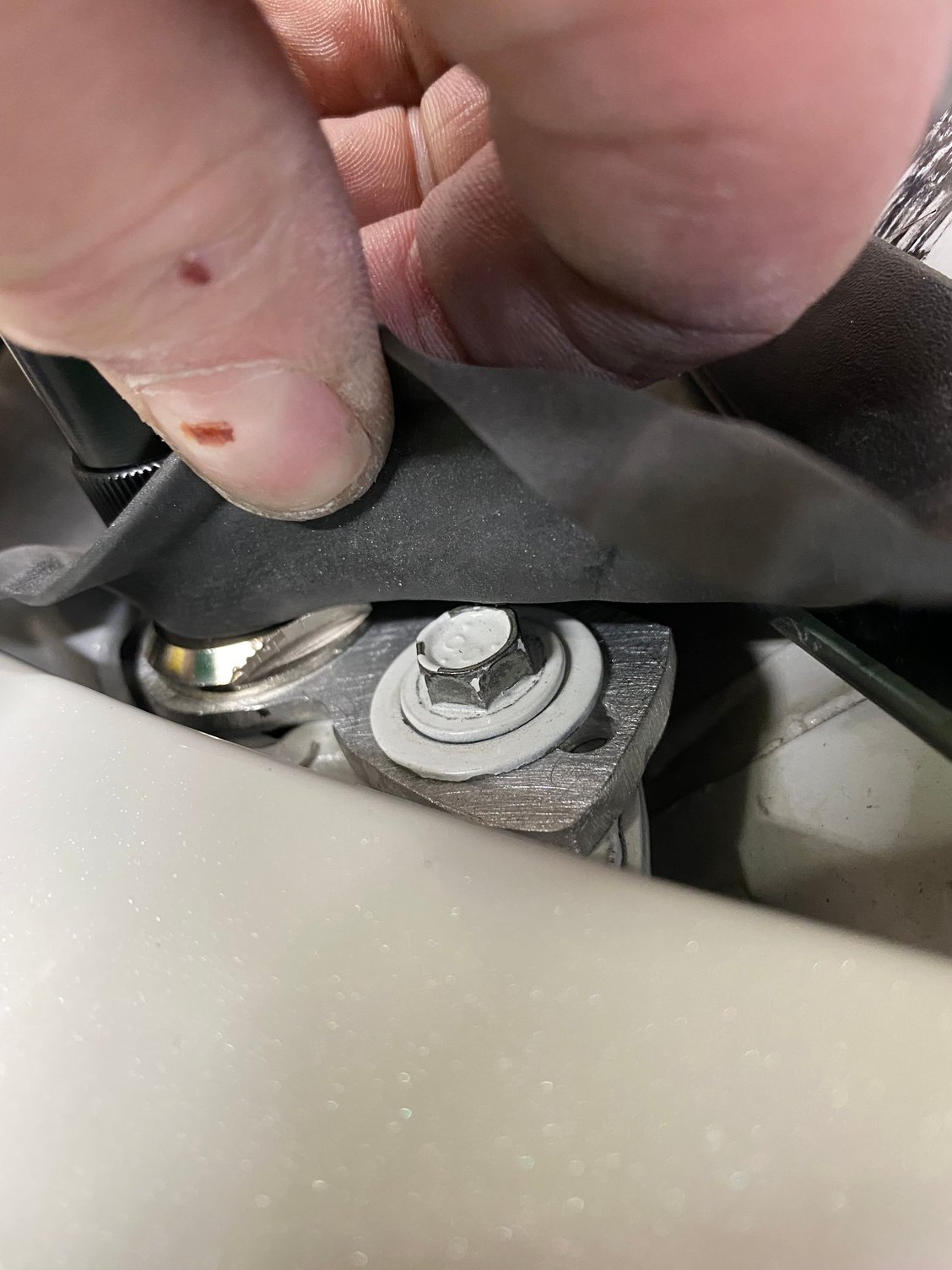

CB is way more picky about ground plane. I gave up on CB a few years ago when I got ly ham license. I made a bracket for my 2020 that uses an OEM fender fastener and brings antenna up thru the cowl opposite the FM antenna.

Beautiful install. I really like the approach.
