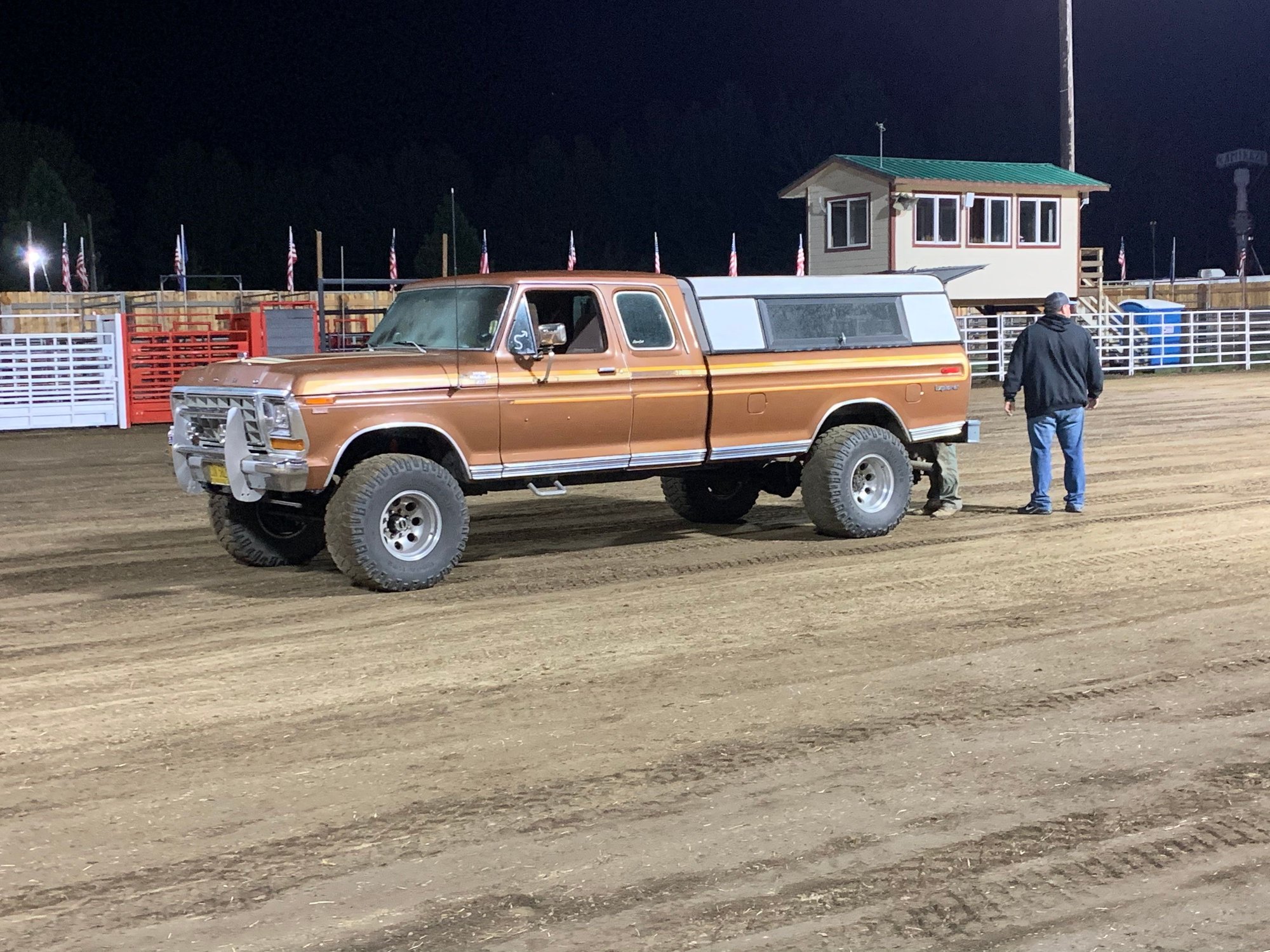

Ya well, I built my truck to be used. It’s got 600 miles on it in the last few days and more to go. Prepping for fair and it packs all my trailers and tools. Tailgate assist would be an assist as opposed to slamming down. Still, better looking than all these super duty’s that everyone else is running.
