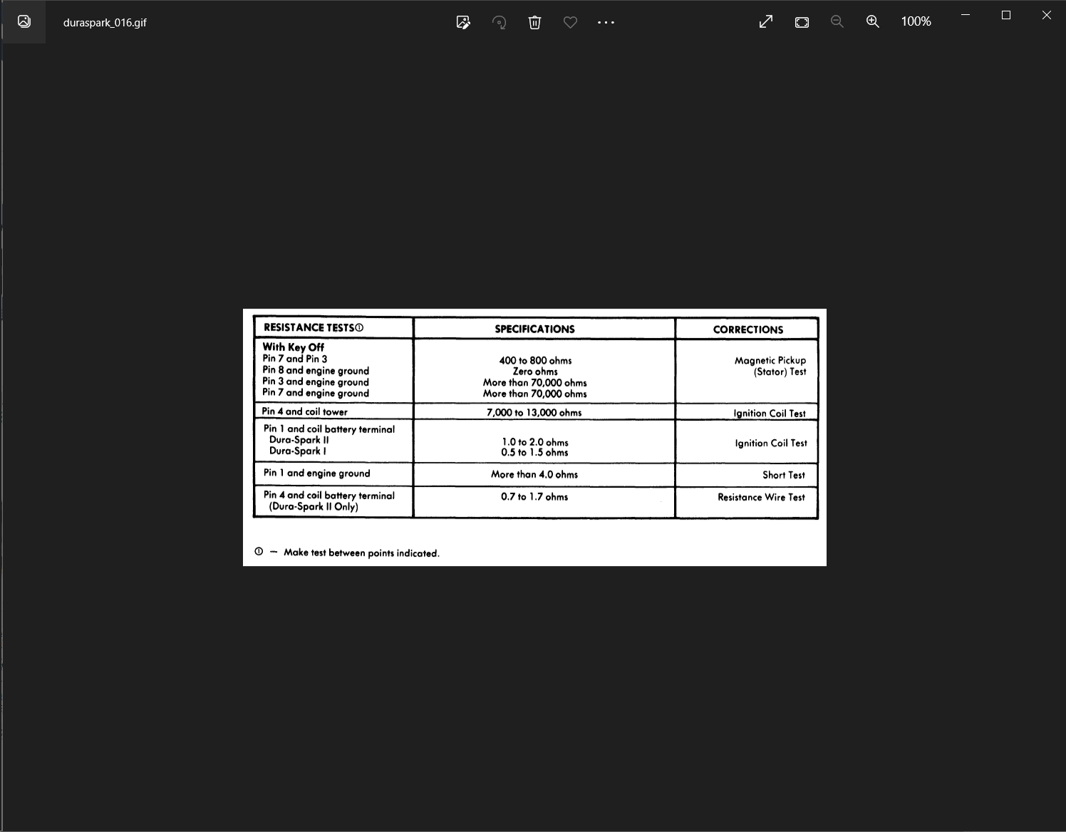

I did an ohms test on the magnetic pickup coil and it’s reading 0, I’ve verified it 3 times. I tried it on two other truck I have (77&76) and both read 615-625. Looks like I will be replacing that.

Is it Duraspark? (Electronic ignition) I have these specs
