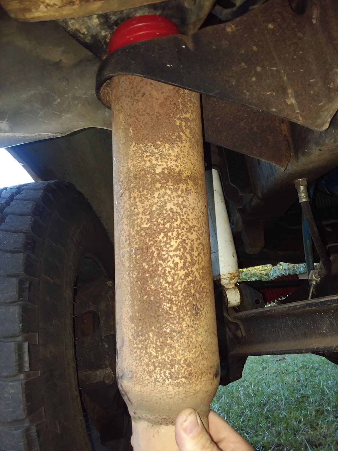

I have the polyurethane "Prothane" set on the shelf. My cab is a little low on the right, not much but it's noticeable. I've measured the washers under the bushings, the ones with the nut incorporated. They are just under 3" OD, the lower rubber bushings swell out, more to 3-1/4". I have a few feet of Shedule 40 3" steel , it's 3" ID. This piece of well pipe is 3-1/2" OD. I've been telling myself that it needed to be bigger ... like 3-1/4" ID to work as a puller for the lower washers / bushings ... but it occured to me that once the threaded rod pulls the washer and inner collar loose, the lower bushing will just either compress and follow into the puller, or be destroyed. I have the threaded rod and nuts and washers.
I think that as long as the ID clears the washer part, tightening the nut is gonna pull it no matter what happens to the rubber bushing.
Sound right?
See below for updated answer, my pipe is 3-1/4" ID, it looked thicker walled but was because I had looked casually at the end cut with a roller pipe cutter. It was "swaged" inward.

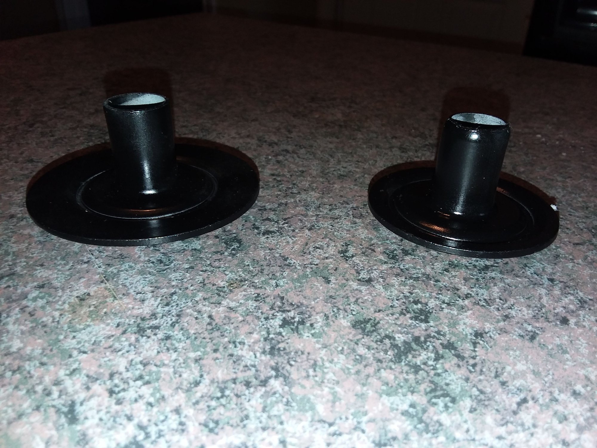

You remove the bolts from above, thread the all thread into the bottom washer with the nut, slip the puller over the all thread and the bottom washer and bushing, slip washers over the bottom end of the puller and thread on a nut. Tighten the nut to separate the bottom washer from the top, They interlock in the middle and can take quite a bit of force to separate. The upper and lower washers are sleeved as you can see in the pictures.
The last pic shows an original bottom washer after it came loose.
I forgot to mention in my above post, to have some large washers available for spacers/shims. Keep track of how many shims (if any) are used at each location.

Thanks for all of the responses. Tomorrow I'm gonna cut a piece, then I might weld 3 or 4 "legs" made of 1/8" x 1" wide straight steel, weld them flush to the exterior of my pipe to extend about an inch up past the bulging lower rubber. Thing is the well pipe has 1/4" thick wall, so it is 3-1/2" OD. This will give me a circle of "legs" 3-1/4" ID. I have a few nuts and a 36" piece of 7/16"-14 threaded rod ... and some 1/4" thick steel 4" discs that I once used to make elevated lower coil spering seats to rais a car an inch or so. I will need to get my behind seat storage out that I built so long ago, so that means my seats have to come out too ... to get to them bolts. I haven't put front fender liners back in yet, so the middle ones should be easy enough to reach. I haven't examined the core support front ones really close yet. I might lubricate the rubber bulge with Ru-Glyde and try the 3" ID pipe with a jack just "to see".
See my next post (#7) below, I took another look at that pipe I had, it'll work, I measured it more better. I even slipped it into place, all is good.

... Well, I was wrong! Do not tell my Wife.
That long pice of pipe that once mounted my C-band dish in the '90s, then which I repurposed (after cutting it flush with the concrete in the yard) for a DirecTV off the side of the house, the one I thought was 3-1/2" OD and 3" ID ? .... I found out that it looked that way because it was cut with a big roll type pipe cutter. Today, I used a cut off wheel and cut off a piece 8" long and it looked thinner at my cut, so I cleaned the swarf off and tried it under the truck, it's a snug slip fit over the rubber all the way to the frame steel. I measured it afterwards, 3-1/4" ID in reality. It's really only 1/8" walled.
So I'm ready to swap-out some bushings now ... just waiting on cooler weather.
