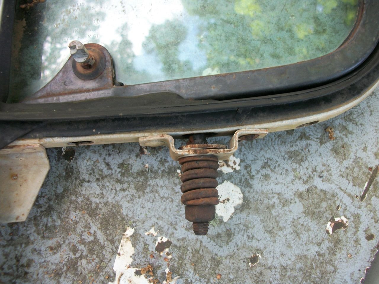

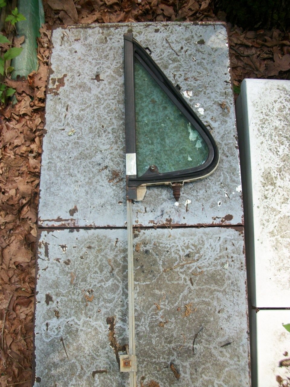

Is the flip down part loose on the mount shaft or is the hard plastic tip missing? The tips become worn or breaks off. The tip is held in place by a piece of plastic that goes INSIDE the curved end and some glue. To get the complete handle off the shaft you have to drive out a roll pin. It is SMALL and can be a PITA, but it can be done. Do it wrong and you break the mount shaft off or bend the piece it mounts to.
Bad news is AFAIK NO you can not change from none locking handle to locking handle because the mount shaft is different between the 2 styles. I had that same issue on my 79 with NONE locking handles. I tried to add locking on a none locking style shaft.
Also they come in pot/cast metal that are chromed and black plastic version. Both material can have the locking option. If you want locking vent wing handles I bet you have to get the correct complete vent wing assembly. Not hard to change out. No you can not change just the shaft that the handle goes on.

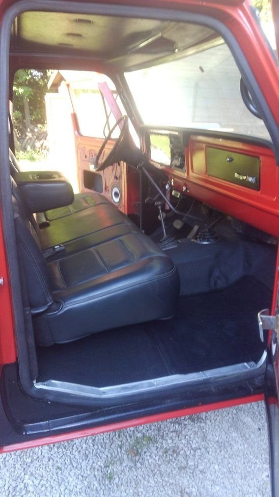

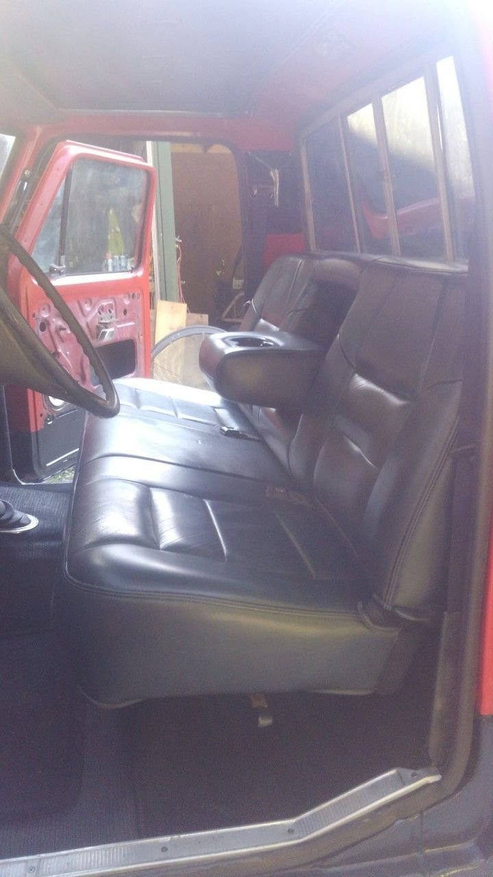

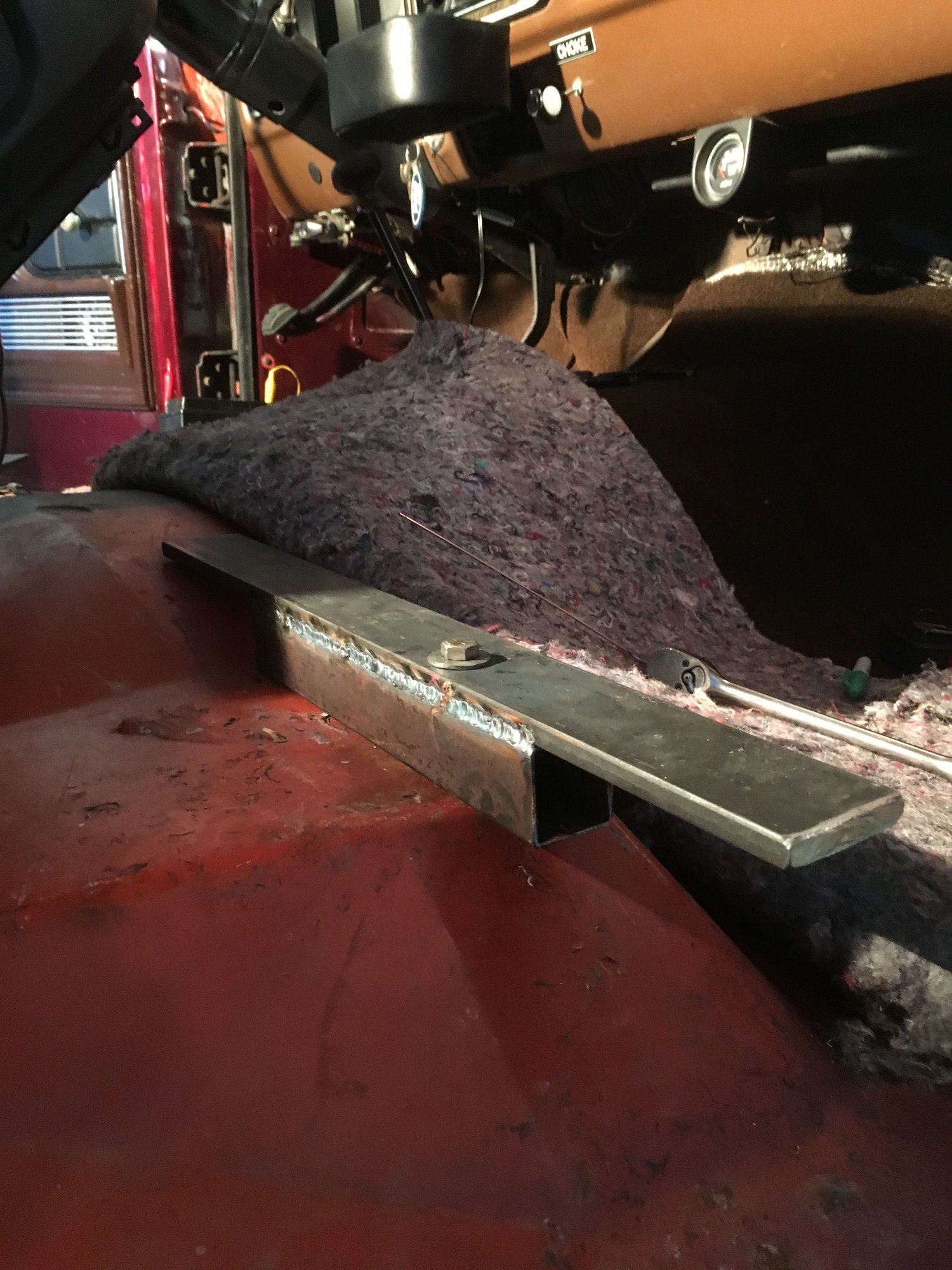

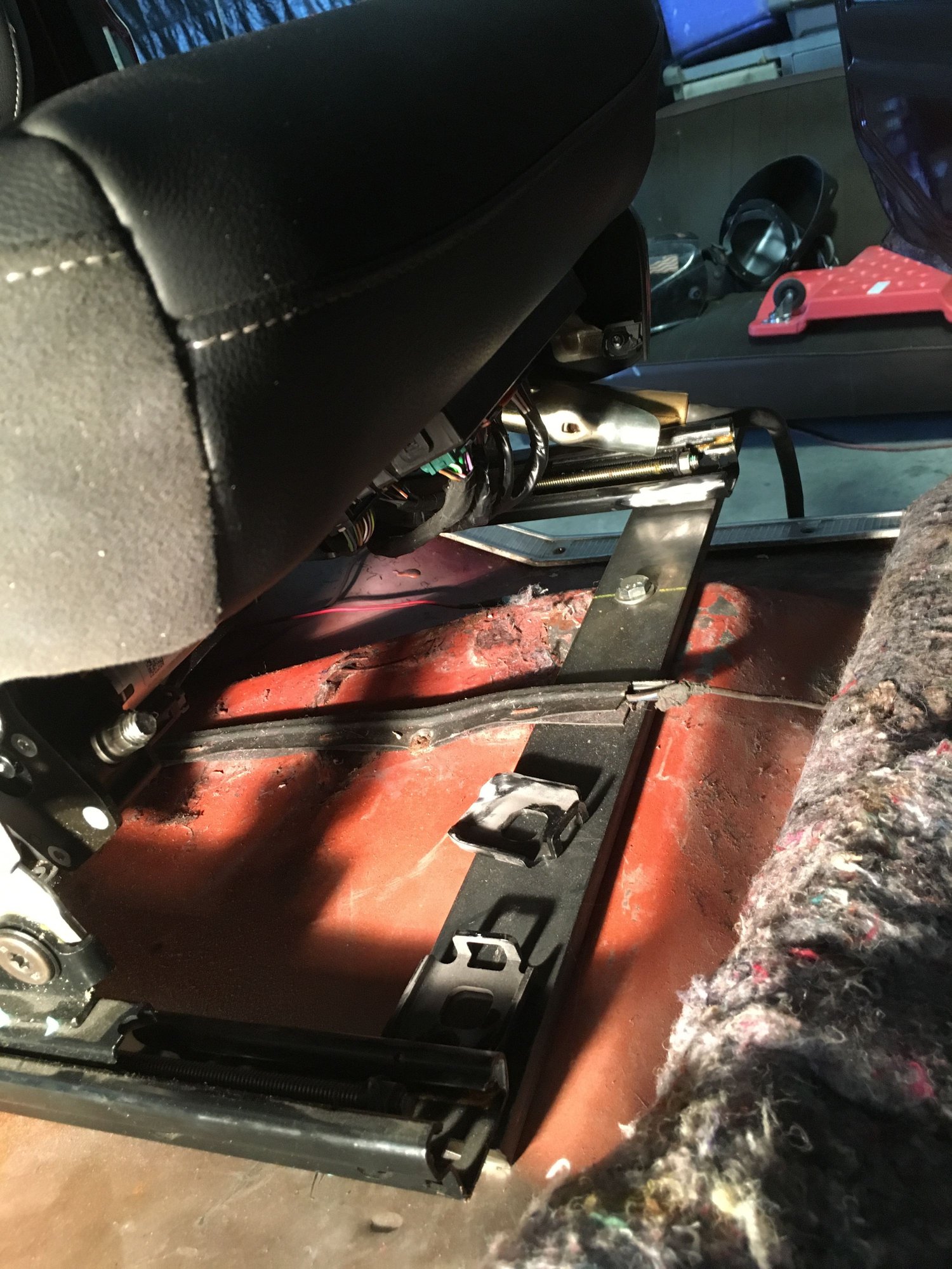

You might have to mod the current seat or easier to put a REAR SEAT out of a 2000 or 2001 Super Duty Crew Cab in it. It bolts right in using the 79 sliders and with the seat design it will be lower. I ended up having to make some riser brackets for mine. And I am 6" 200. Best 20 dollar Craigslist seat I ever got.

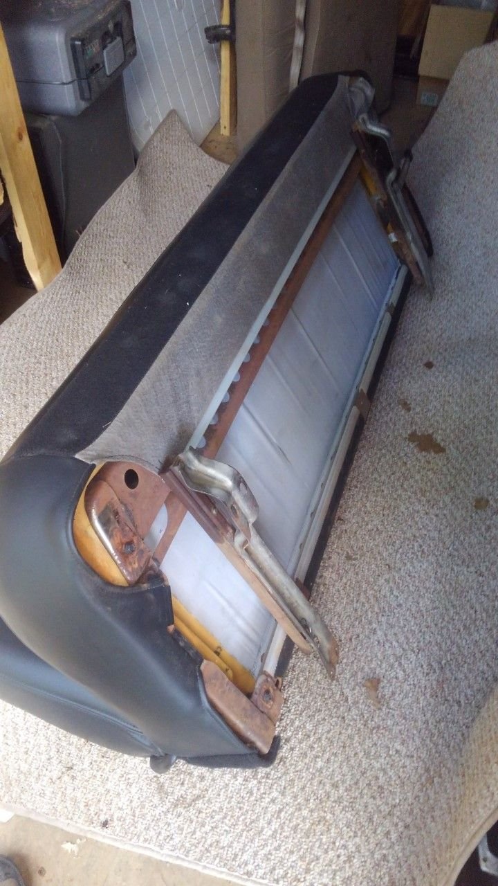

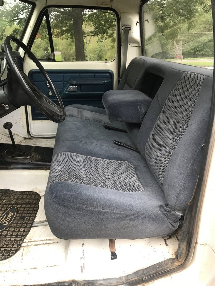

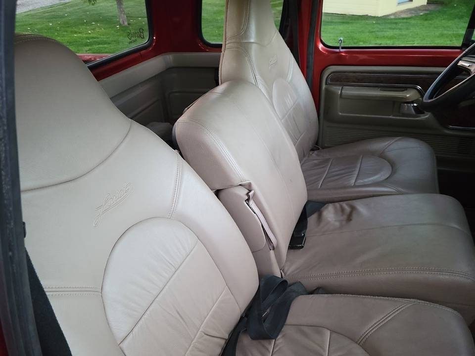

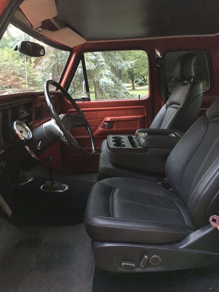

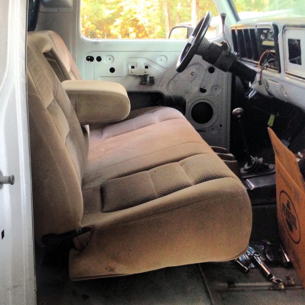

Any seat from a reg cab up to a 96 will bolt in using the 73-79 sliders. As far as using a Super Duty Crew Cab REAR seat in a reg cab I know mine was a 2000 or 2001. This is from a 1994.
2000 SD CC rear
2005 in a super cab
2001 in a SC
2016 Fusion in a SC.
2001 Power Stroke
01 SD again in a SC
Those 2016 Fusion seats took some rework.
