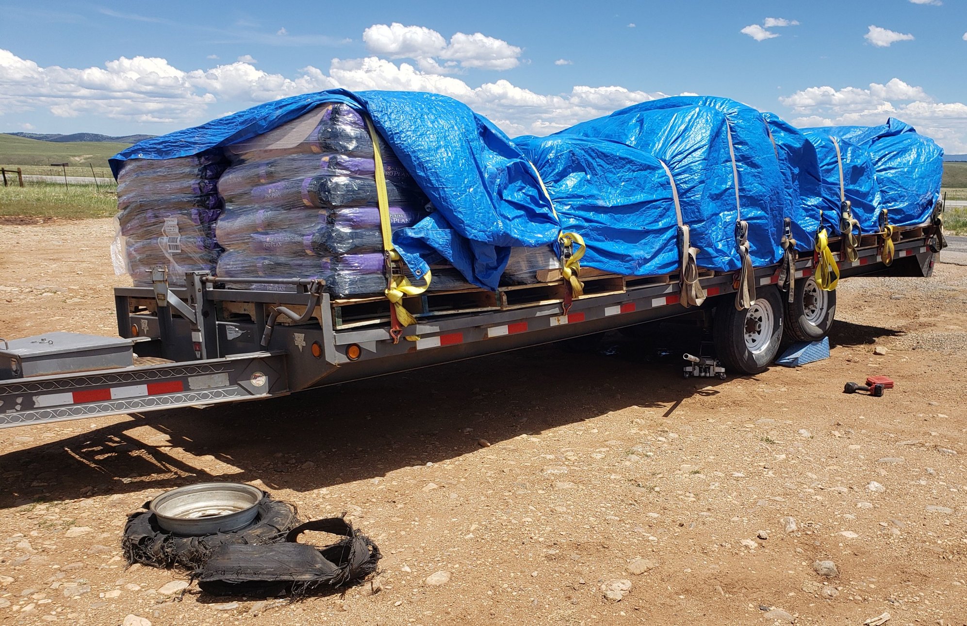

I feel like anyone getting a gasser for a tow rig shouldn't be worried about mileage. The 35 or 37 (depending upon who you believe/what you read) tank is great. It's gonna guzzle gas and if you're getting 8 or 9 mpg when towing, who cares?
The cooling system seems solid, although I have to wonder how sensitive the gauges are.
I actually just got my gauge to move slightly over midway where it always sits. It took GTW of over 17k (NOT advisable) and the final headwall of Wolf Creek westbound to do it. The truck started cycling the fan clutch HARD so it was apparently trying to dump a significant amount of heat.
I also descended in first at 25-30mph tops, but I still had to gently tap the brakes repeatedly to keep speed under 30. By the very bottom at the Falls my right rear was smoking as it always does, but we were at the bottom at that point. It always starts right rear, left rear, then the pedal gets spongy and that's when ya start singing "If you don't apply some brake real soon, they're gonna have to scrape us up with a stick and a spoon "
I need to look into just swapping the rear to '13+ as that's pretty easy IIRC (the front requires new knuckles, again IIRC)
17,130 by my math. Somewhere outside Fairplay. Anyone know that Buena Vista has a fairly new TSC?? We do now!
