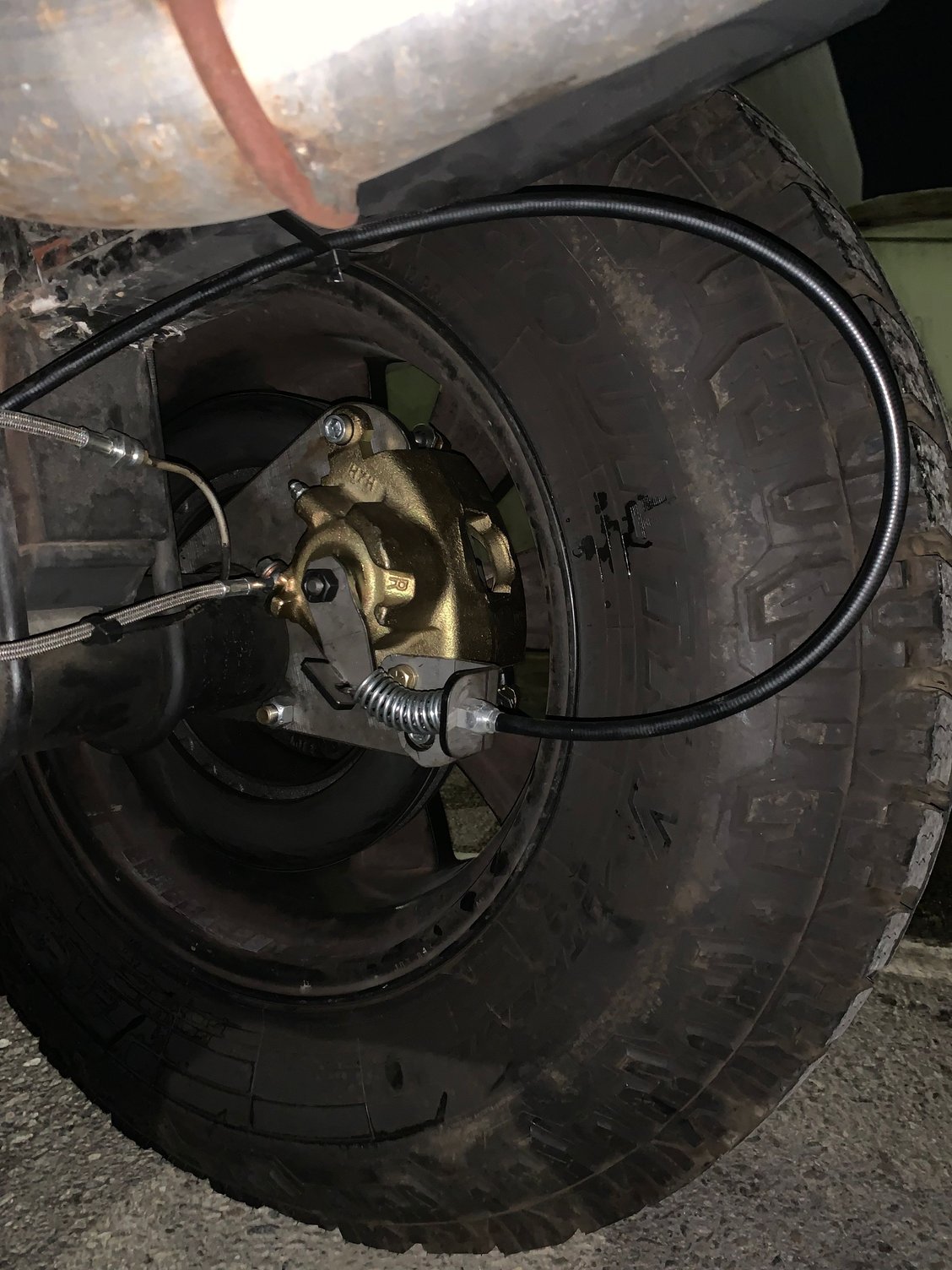

So a few months ago, I converted my drum brakes to disc and well… I have not been able correctly adjust the parking brake adapter that is an extra… has anyone found a way to make these work? A checked all conversion kits out there before i purchased and this one seem to have positive comments about it.. I got the kit at 4X4 lug nut website, reached out to them, showed them these photos and was told it was installed correctly.. Not sure what the issue is.

[Looks like a quality product.] I've never installed one. So here's a few observations for start.
Your E/parking cables and flex hoses seem vulnerable to possible damage.
1. Tension your cables so their locations are further from the wheel.
2. [Reposition your flex hoses and hard plumb the brake lines to bring them higher and remove that loop.] Very easy to use store bought lengths with jogs or pigtails, or cut to length and re-flair but must use a double flairing tool, and bleed.
3. The present tension of the cables application for E/parking brake appears at full stroke toward tension- brake on. If that is not enough movement to lock the rotors, try releasing the tension on brake cable and remove the nut from the lever to see if the connection is splined our square. If the connection is spline or square try removing & replacing the lever one tooth further from the cable.
I hope this helps. Keep us informed.
