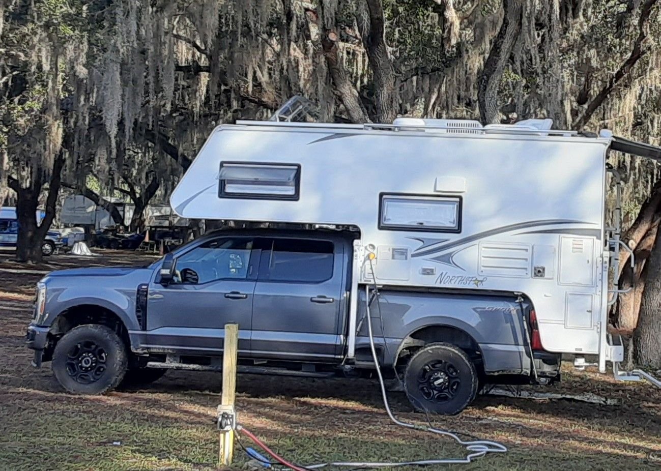

I have the identical setup as Brown Dog KTM(Super Spring Stops w/spacer & Timbrens Severe Service w/ 1" spacer)on my '23 F250 CCLB 7.3 w/ camper/snow plow package to carry my Northstar 8.5 Arrow U. Truck handling much improved on recent 3000 mile trip compared to initial setup with the Super Spring Stops but no Timbrens. Traded stories along the way with a guy that had an Arctic Fox 8.11 on his F350 CCSB PSD with no modifications. He felt his handled it just fine, so I guess it's possible to put a heavy hard side camper on an unmodified truck. This is what seems to work for me; I'm not anticipating any additional modifications at this time.

I have air bags on my 2002 F 350 SB to carry my Northern Lite 8-11. This works well but can be a pain to keep things level side to side. In consideration of a new truck I am wrestling with the whole ride quality, Camper Special, Timbrens, different shocks, sway bars? issue. Some are telling me that the new trucks ride better and koolhandluke1's example sure looks good. Does anyone have experience with a newer truck that doesn't have a Camper Special package?

Originally Posted by wallbear1
I have air bags on my 2002 F 350 SB …
Some are telling me that the new trucks ride better …
the newer super duty’s ride WAY BETTER than 2004 & older with front leafs.
Plus the newer trucks has 12” longer rear leaf springs making them handle weight much better WITHOUT sacrificing ride quality empty.
