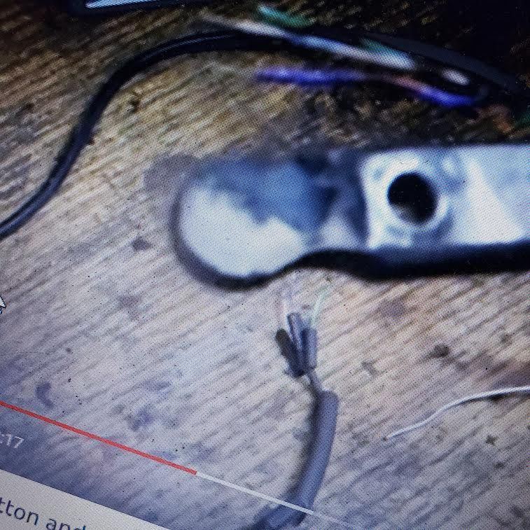

Pretty common for a blinking OD lamp (on a Ford like yours) is code P1780 because your shift lever wiring is broken like this

Sorry, what is NGS? I can't see the photo very well but is it broken up in the stem? Mine looks fine on everything I can see when I pulled it out.

You had your shift lever out and inspected the wiring?
Google code P1780 for a 01 F150 and you should find / see that photo straight away
