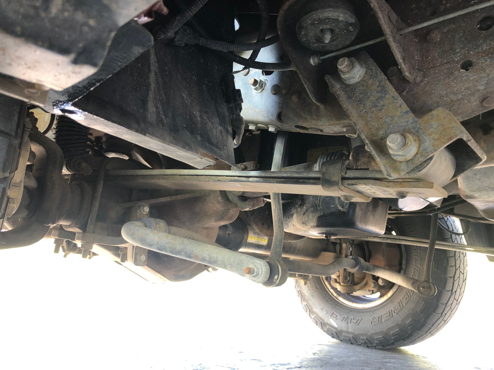

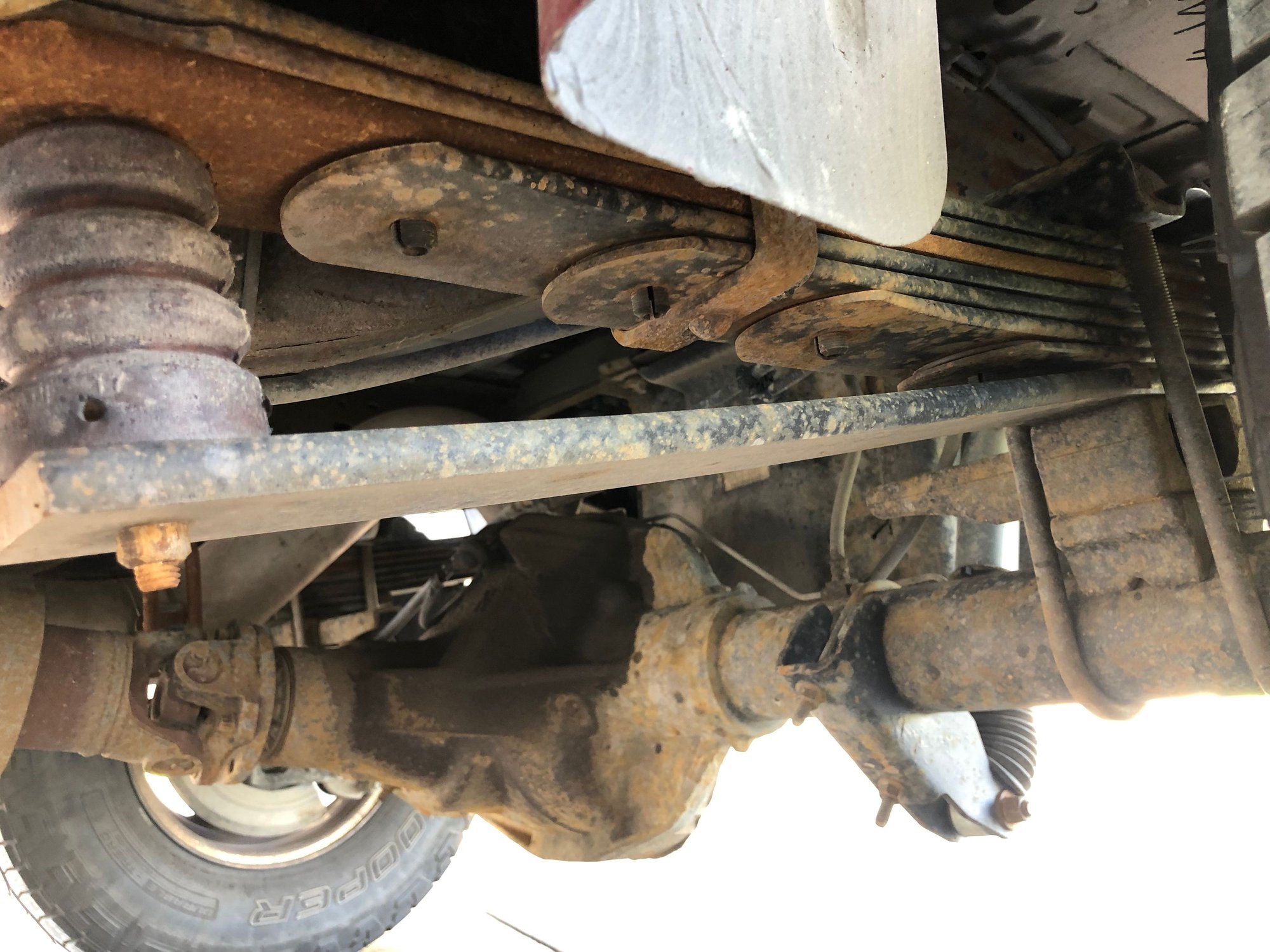

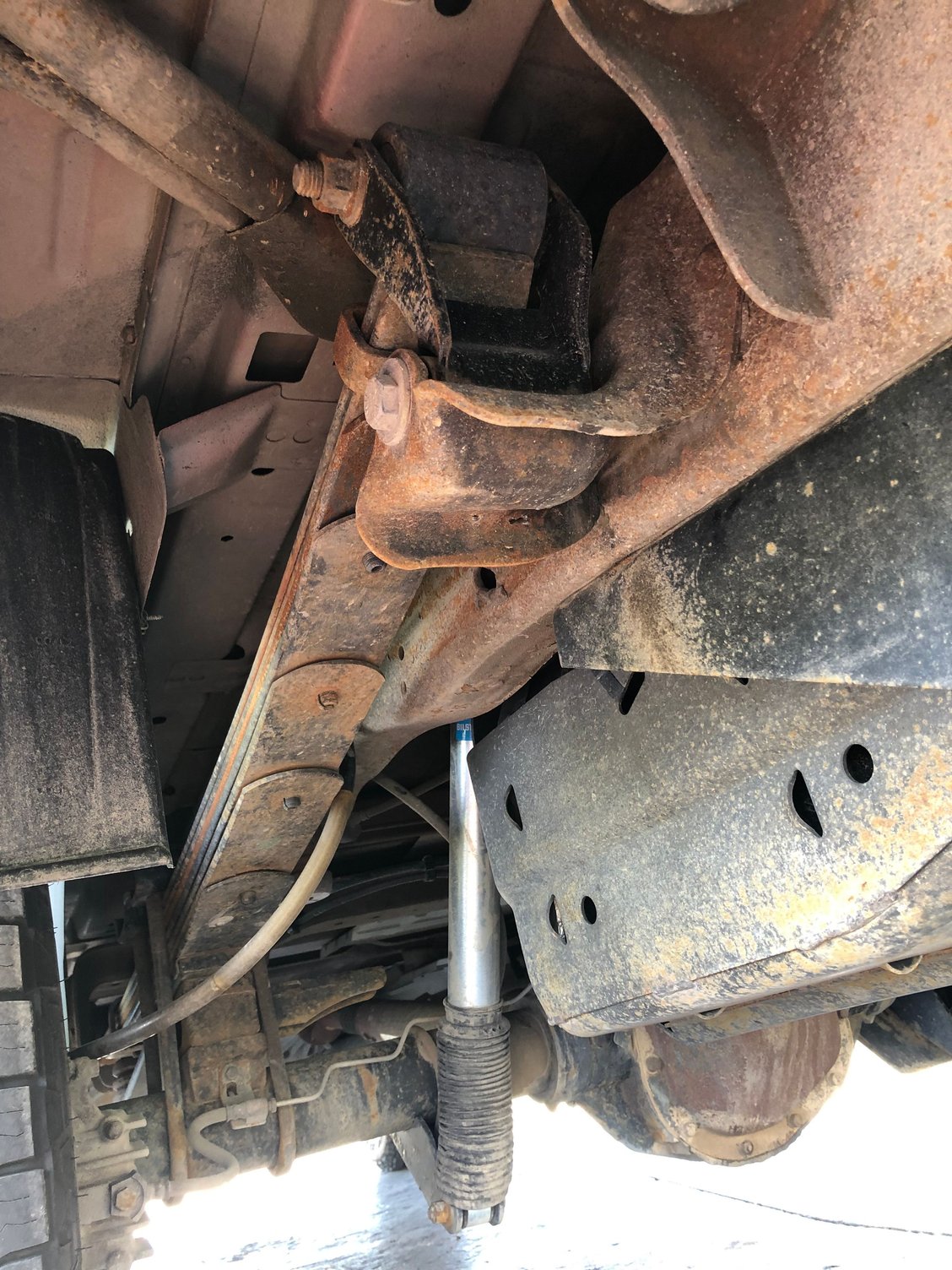

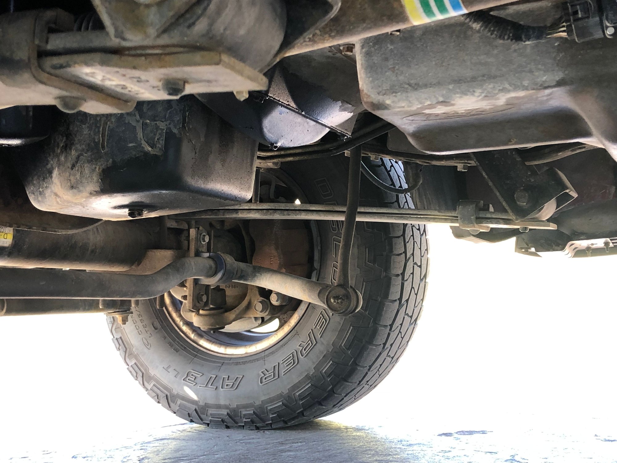

If you can be troubled post a pic of the front and rear spring.
I’m curious on the methods used.
