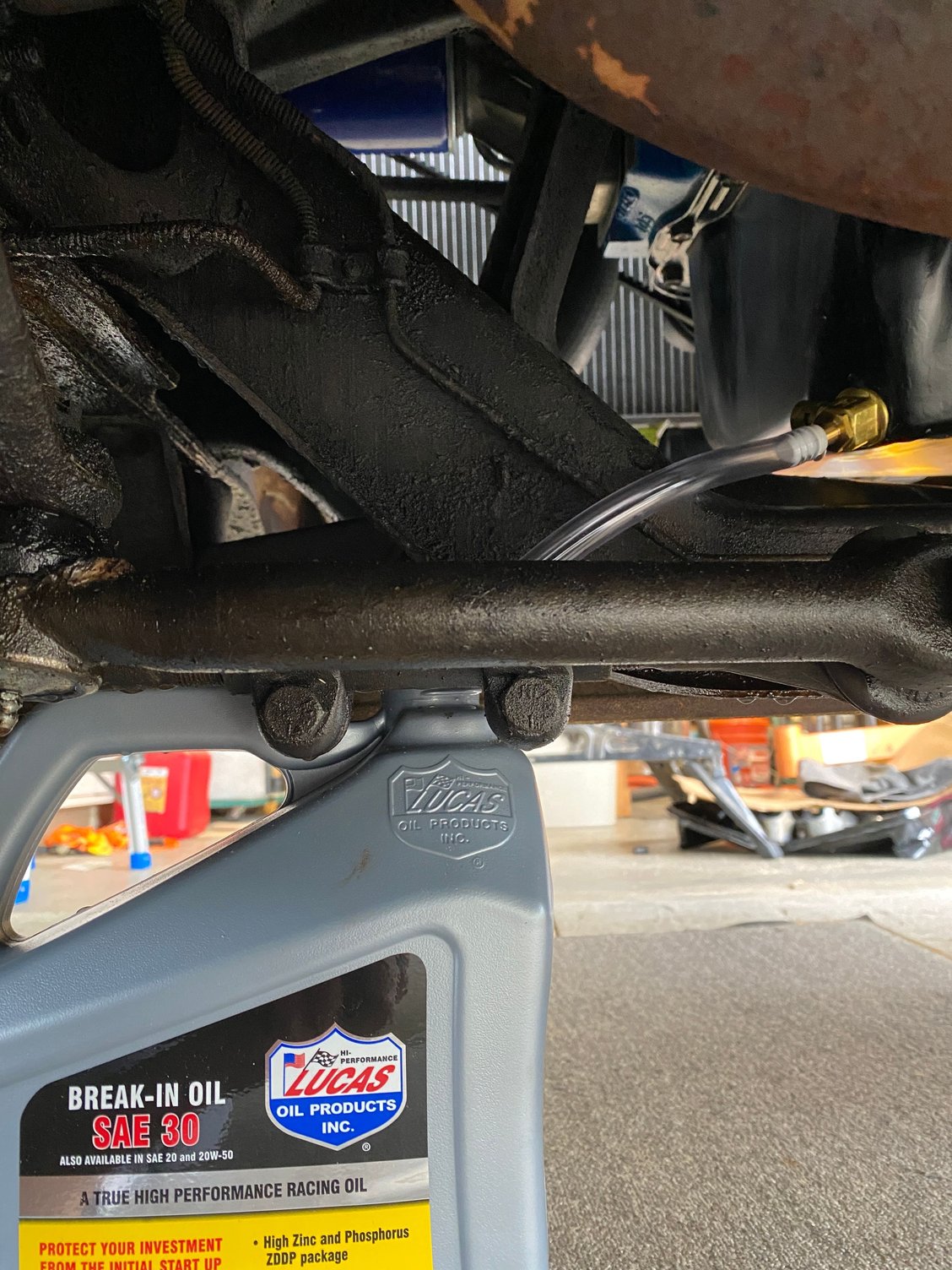

Old Jul 9, 2022 | 09:48 PM
lasermike's Avatar
lasermike
Joined: Jun 2016
Posts: 855
Likes: 56
From: Des Moines, Washington
Fumoto valve in action. Note I'm doing this on carpet. Not a drop spilled from the pan. The filter was a different story of course, I did remove the mat before removing the filter. And I dropped the hose into the bottle when I pulled it from the valve.
Installing the valve required lifting the engine about 1" which in my case was easy as it was still on the hoist at that point. It's a bit of a pain to reach the lever but not impossible. The white plastic bit and the hose are part of the hose kit. The hose actually fits on the nipple without the white part so you could get away with just hose from the hardware store. I went for the one and done plan and bought both at the same time. This is a F101N valve on a FE 390 with a Ford oil pan in a 1974 SuperCab F250. I don't know if the pan is original, it does have a Ford part number.
Michael
