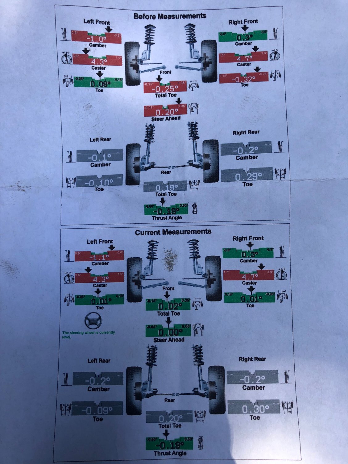

Truck has Carli commuter, adjustable track bar, sway bar, etc... 11k miles on it. street queen, never been offroad
IIR, truck seemed to drive straight, no pull until I put a set of Toyo AT3 37s on it. Truck then had a noticeable pull to the left on some roads, drift on others. However, on some roads it drives straight. I chalked it up to the new tires being wider and grabbing more grooves in the road, or maybe the tires have a radial pull to the left.
after dealing with it for a while, I put the stock tires back on to see if there was any change. Truck still pulls/drifts to the left, but not as bad.
so I had the alignment rechecked yesterday.
caster 4.3 driver side, 4.7 passenger side
toe was out, so they adjusted it
camber was -1.0* on the driver side 🤷🏻‍♂️🤔
my steering wheel was perfectly straight when I dropped it off.
after the adjustment, I'm not sure if it drives any better, and the steering wheel was off.
sure enough, they **cked with the drag link
can adjusting the drag link have any affect on toe? I was under the impression it has nothing to do with anything other than turning the steering wheel
is my caster split causing the drift/pull?
what else to consider?
I have checked everything, and all seems good.
thanks

Camber can be different side to side to offset crown, so it is common to see some variance, but combined with caster, too much can cause pull. Since they did not get the wheel centered and it still pulls, I would take it back and have it redone, and this time go with on the road test to make sure it no longer pulls and the wheel is centered.
There is one other thing that can cause pull or drift, and that is the weight of the driver. I ran into this back in the 90's when I was a mechanic. The owner dropped the car off after hours, paid by card over the phone and picked up after hours and we never saw him. The alignment was perfect, but he complained it still pulled. He dropped it off again, this time after hours, and we checked and told him the car is perfectly aligned, not drifting or pulling when we road tested and he was more than welcome to come and we will ride with him. He showed up, and the dude weighed 400 pounds. DING, the light went off, we didn't even bother road testing, just asked that he sit in the car while we made some adjustment and sent him on his way. Called later thanking us that it drove nice and straight.
Looking at specs I have, Left camber should be in the range of 0.9 to -0.6, -1 is out of range Right camber -0.6 to 0.9. This is 09-19 specs, which I think still holds on up to 22 models since the suspension hasn't changed much.
Caster factory specs 3.4 to 0.8 left and 0.8 to 3.4 right. Toe -0.8 to 0.18 and flip for the right. Thrust angle can also play a part, should be -0.50 to 0.50. It's how the rear wheels affect forward travel, AKA Dog Tracking.
I just had my 2012 done after replacing all the front end parts, and the only thing I couldn't do myself was adjust the toe, and I could clearly see it was toe out, which causes wandering as each front wheel is trying to go it's own direction. My camber is -1 on the left and -0.3 on the right, and does not pull, but my caster is also 5.6 and 5.5 left and right, so pretty equal. The tops of each wheel point in towards the truck, thats what - camber is.
Caster and Camber are adjusted using a cam on the top ball joint. I use the term adjustment lightly because you can turn them but the adjustments are very minor. In my case, if I want a little less camber on the left and a less caster I can tweak the bushing a little by turning it, but only by .1 or .2 tops. Anything greater and the cam has to be replaced.
There is also a combined toe, or total toe and steer ahead angle. Properly adjusted should read all 0, and total toe should read between -0.15 to 0.35, anywhere in this range is OK provided steer ahead is 0.
They should have included a print out for the alignment with the receipt that will have all this information on it.

I looked at your first post again, you do have the readouts.
This can cause your pull. The further away from equal the less positive side will pull more. Your Camber is OK, I wouldn't worry about it since the right side would be the pull, not the left with those readings. There is a .4 degree variance, which is enough to cause what you claim. Ideally you want them equal or within .1 degree of each other.
Old Jun 25, 2022 | 11:55 AM
kylant's Avatar
kylant
Joined: Sep 2016
Posts: 1,613
Likes: 156
here is my printout.
what is baffling me, is the fact I did not really notice the pull until after I put new wheels and tires on it. I swapped to back to the stocks, but pull is still there.
I currently have 1* caster shims installed with my lift. I have .5* and 2* shims on the shelf.
what are your thoughts on installing a .5* shim on the passenger side? theoretically this would put that side at 4.2* ?? 🤷🏻‍♂️

Give it a try, the worse that could happen is it pulls to the right, but if it does, then you know you are on the right track. That half degree combined with the .18 thrust angle and .3 right rear toe could be just the right combination to push you to the left. At least on these trucks it is easy to adjust caster without having to get it aligned every time, you just need a base line to work off of
