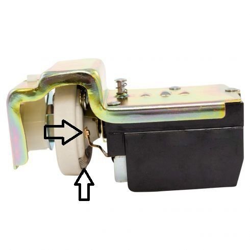

Your assumption about the switch being bad is probably correct, the dimmer section consists of a spring like coil of resistance wire and a wiper with what may be a block of carbon on the end of it. As you turn towards brighter, you are decreasing the resistance until you hit the rivet the holds one end of the spring. That would be full brightness. The block can wear, the spring can fail in a number of ways, including simply falling out and the pivot point for the wiper can come loose to the point it won't carry current.

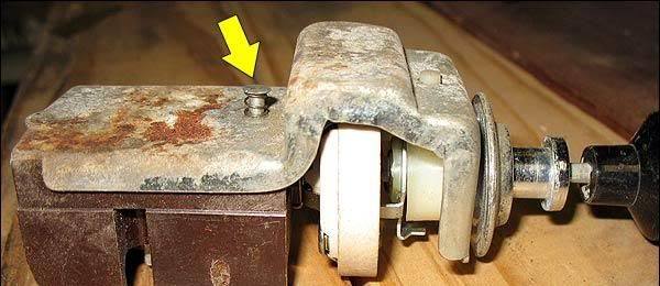

You do know the headlight switch **** and shaft come out as an assembly. Push the yellow button (in the pic) up and down a few times, pull push on the **** and shaft, then hold button down and pull it out as one. It can be sticky if it has never been out. Once out the headlights wil be ON, so FYI disconnect the battery 1st. If it will just NOT come out, go ahead and pull like hell (not the preferred method) to get just the **** off the shaft. Proceed with the dash bezel removal to access headlight switch retaining nut.

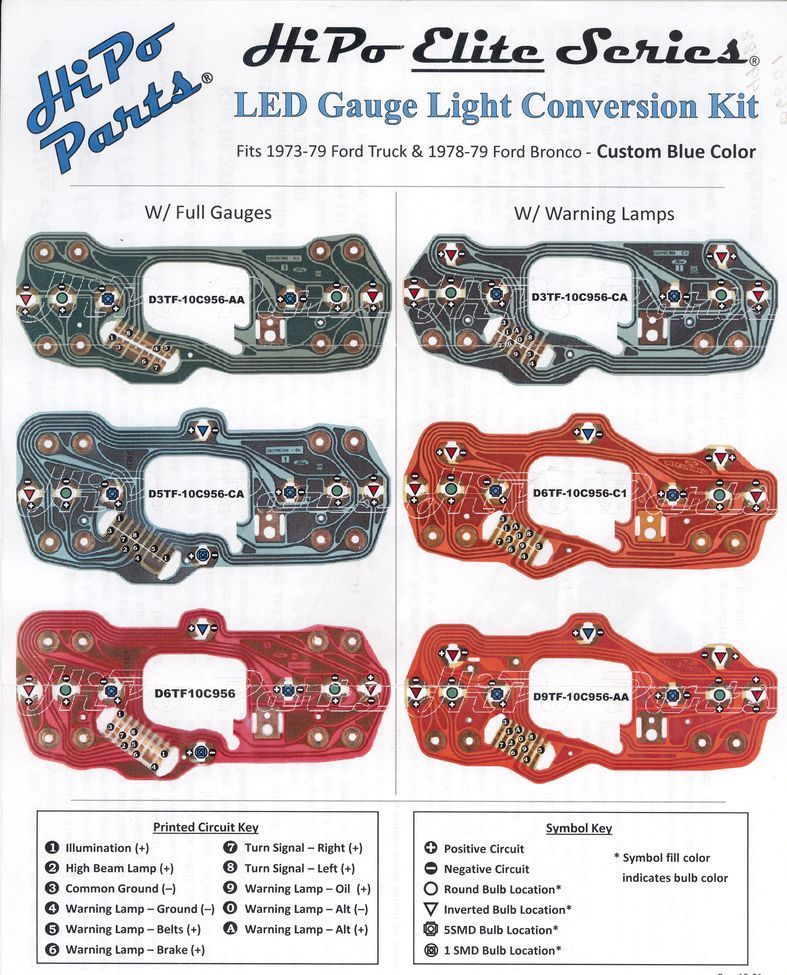

The quick responses and wealth of knowledge is amazing, as usual from y’all. I took apart the switch and shinned up all the contacts with 600 grit sandpaper. Works like a charm now! I was using the wrong term earlier about the bulbs. I’m wanting to replace the six in the gauge cluster, they’re 194 bulbs. My oreillys had two white, one amber and one blue … and they’re $12 each! Being concerned blue will mess with my night vision, and green is the stock color, I’m ordering green ones off Amazon. Found a pack of 30 for $11!!!!! Does anybody have any pics of their dash/gauge cluster with LED bulbs? I’d like to see what different colors look like before I actually pull the trigger on the green ones.

Red can be a eye strain, so dash light are normally green and only the high beam indicator is blue. EQUIPPED TO SURVIVE (tm) - Green or Red for Better Night Vision? You ever notice if you turn your dash light down way low, you can see easier outside the vehicle when driving at night?
https://www.hipoparts.com/1961-79-fo...nversion-kits/

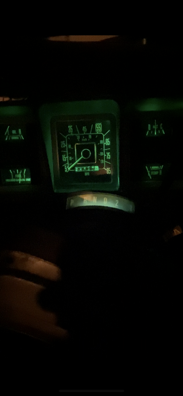

Before LED upgrade
after

foofees pics show the night and day difference I saw when I switched to leds.
